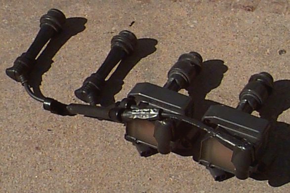

4AGZE crank angle sensor.
4AGZE coil packs.

You can use any 4AGE dizzy with most aftermarket ECU's, in full sequential, wasted spark or single coil, its all about how you configure the ecu and which one you use. The only difference between a 4AGZE CAS and a 100kw dizzy is the top cover and the plug. Autronic's are a great ecu, you'll have enough igniter control to go full sequential on the ignition. The neatest way by far is using COP (Coil over plug) coils of a 1ZZ toyota corolla, they look neat as when installed, and end up saving you money because you won't need any custom leads what so ever.
