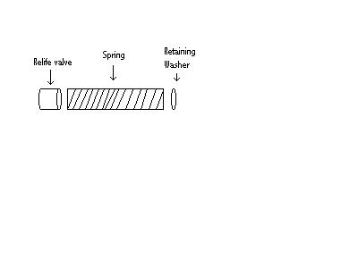

Sorry to bring up an old post but I'm doing this now and i wondered if it matters what end you put the shim on the spring.
If you put it the end of the spring where the split pin is nothing will retain the spring but the walls of the pump body. If you put it the other end the spring will still be retained by 15mm or so in the relife valve plunger?
I have included a crappy drawing to illistrate what i mean
