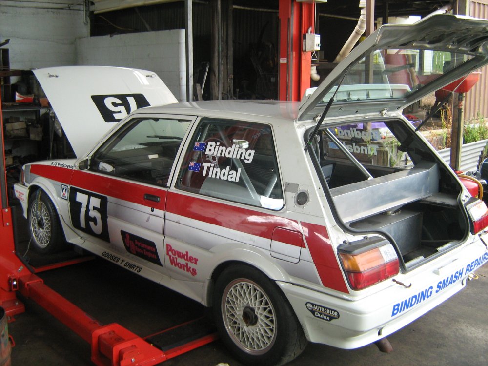

My car was built from a brand new shell by TOM's Japan for Tom's Toyota Racing GB (England). its first race was Spa 24 hour(Belguim) in 1987. After winning its class in the British Touring Car Championship in 1988 & 89, it came to Australia as part of the Bob Holden team. The car raced in the Aust touring Car Championship from 1990-93. When GpA racing finished it had no class to race in so it was safely put away till I got it going again in 2007. It is still in the same format & livery as it last raced at bathurst 1993

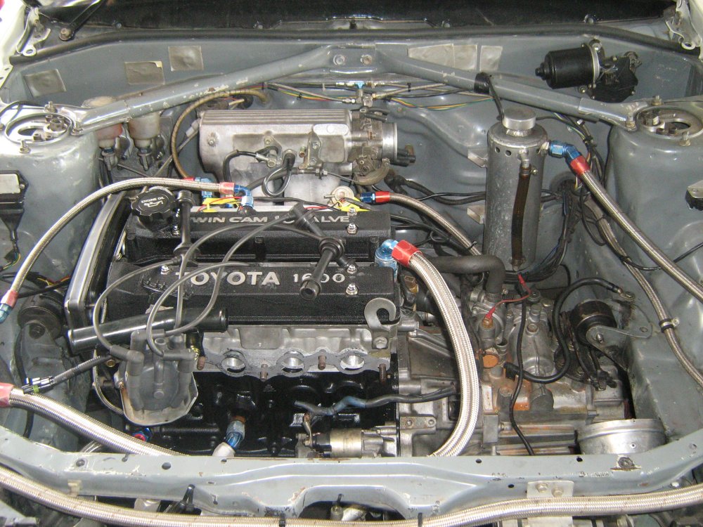

4AG "small port" . Motec computer and quad throttles. extensive internal development

custom alloy outer tank with internal bladder. 65 litres. dry break fillers
Interior
TRD race seat, TRD instruments, TRD steering wheel
Alloy roll cage
original dash frame etc.
rear seat & hood lining removed
plumbed in fire extinguisher

(Quad throttles not shown, Small port manifold installed for testing)

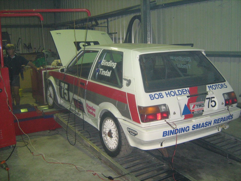

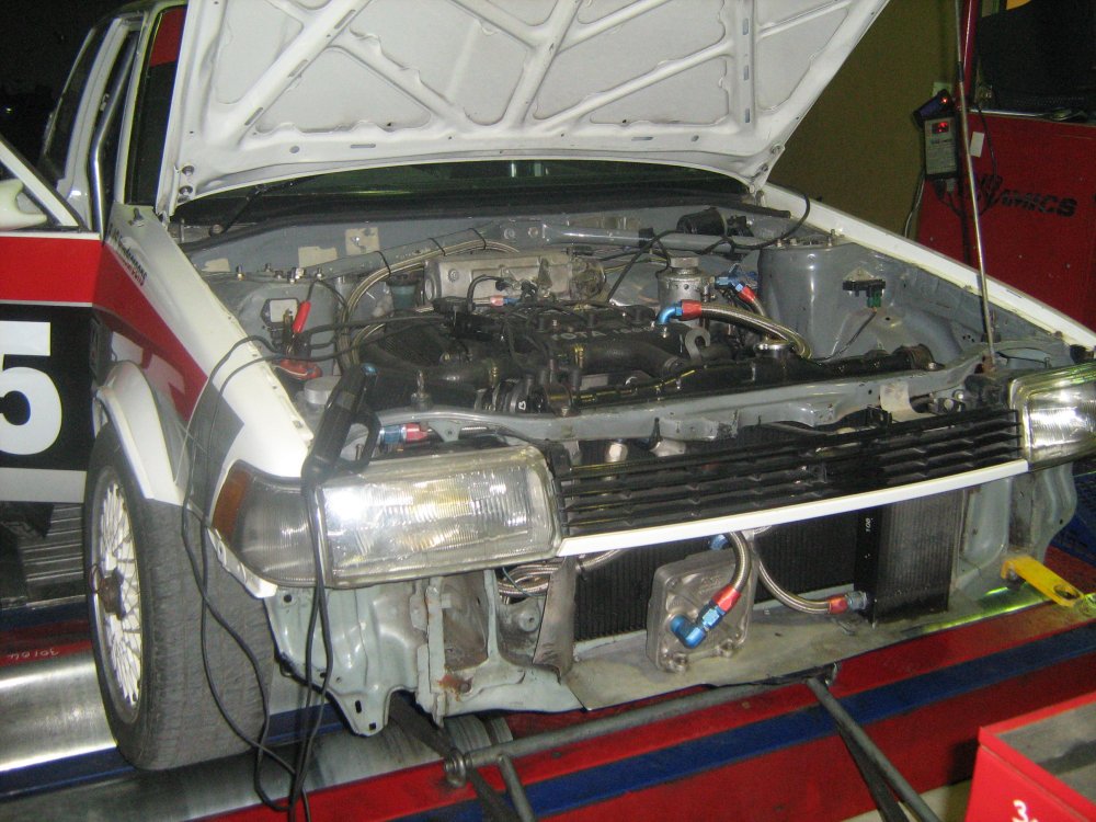

Took it to our dyno lastnight, Best result was 109 hp @ the wheels as we were experimenting with a few things like an airfilter, more/less fuel & wheel alignment, When we got it running consistenly and were about to tune it for more power the gearbox decided to get stuck in 4th so i will take the box out next week and see what happens, Heres some pics & i will upload a vid to youtube:

Video - Done in 4th gear, 1st half is tuning the fuel map on the motec, 2nd half is seeing how it goes & a 8800rpm revlimit.
