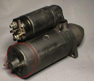

This frees the brushes, has nothing to do with freeing a solenoid..
yep now that the motor wont even tyurn over, give the starter motor a couple of bangs
get someone to key the motor over while you tap the starter near where the brush holder is housed, if it starts to crank while doing this good chance your brushes are sticking or low.. Don't hit near the permanent magnets or the solenoid or you can further damage the starter..
rough photo of what to hit? :yes:
