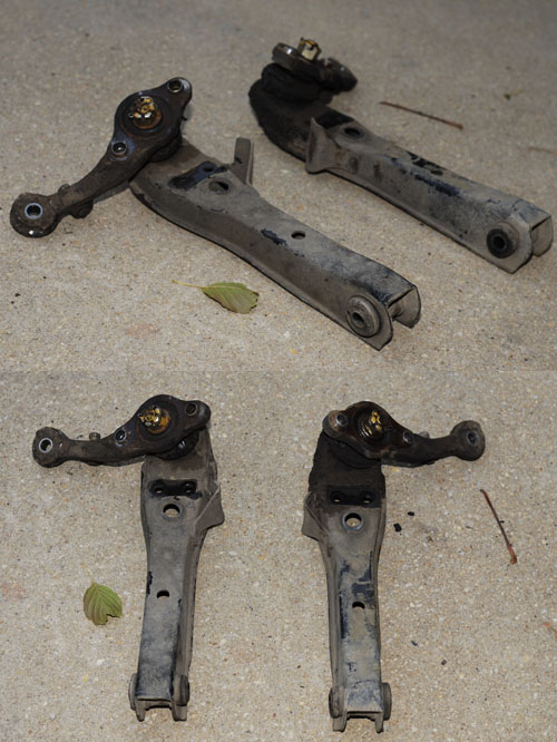

LilSlvrRolla Posted May 7, 2008 Report Posted May 7, 2008 yeah i heard that somewher aswell,that ra40's arms are the same as xt130 Anyone know what XT130 LCA's look like lol? Here's the RA40 Celica ones I bought today, 315mm (Centre of bush to ball joint). Quote

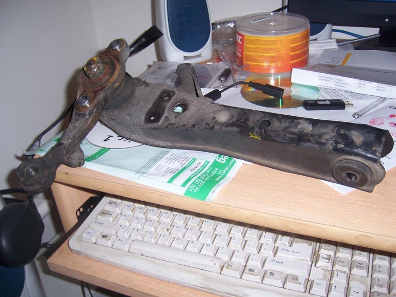

DearmanKE Posted May 7, 2008 Report Posted May 7, 2008 seams the same pulled one out of my car just for you guys!! actually, it was in my shed because ive been to lazy to put it in yet :hmm: XT130 CONTROL ARM 315mm pic: Quote
LilSlvrRolla Posted May 8, 2008 Report Posted May 8, 2008 Hey, that deffinatly looks like them then :hmm: Thanks dude Quote
