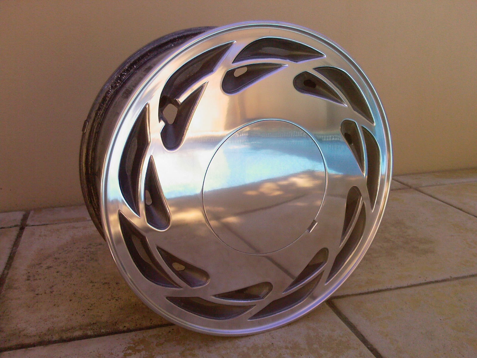

I used a sander (its not orbital....but...it just vibrates hell quick, 50 bucks from bunnings) with wet and dry, started with 600, and then a bita 1200. Then for the polishing, used Autosol. I attatched a polishing cloth to the sander.....and then yeah from there on just keep at it :yes: its a slow process but worth it in the end. All in all probably 3-4 hours.

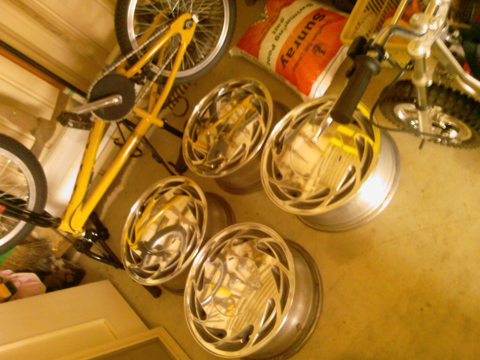

Heres my calais rims that i did a while back. Was an absolute bitch of a job, id say it took 15+ hours. There is no shortcut.

That looks tops, I will certainly give that a go. :hmm:
Did you use anything other than the wire brush and wet + dry sandpaper ?
Rad Rolla, I myself would steer clear of the wire brush as from what ive learnt in the past is, it scratches the metal fair severly, and then you have to sand the scratches out start with a lower grit working through to higher. I could be wrong. But more work in my opinion.
Oh theres a brush in my pic :yes: i tried it for a split second then decided not too.....ignore the brush.

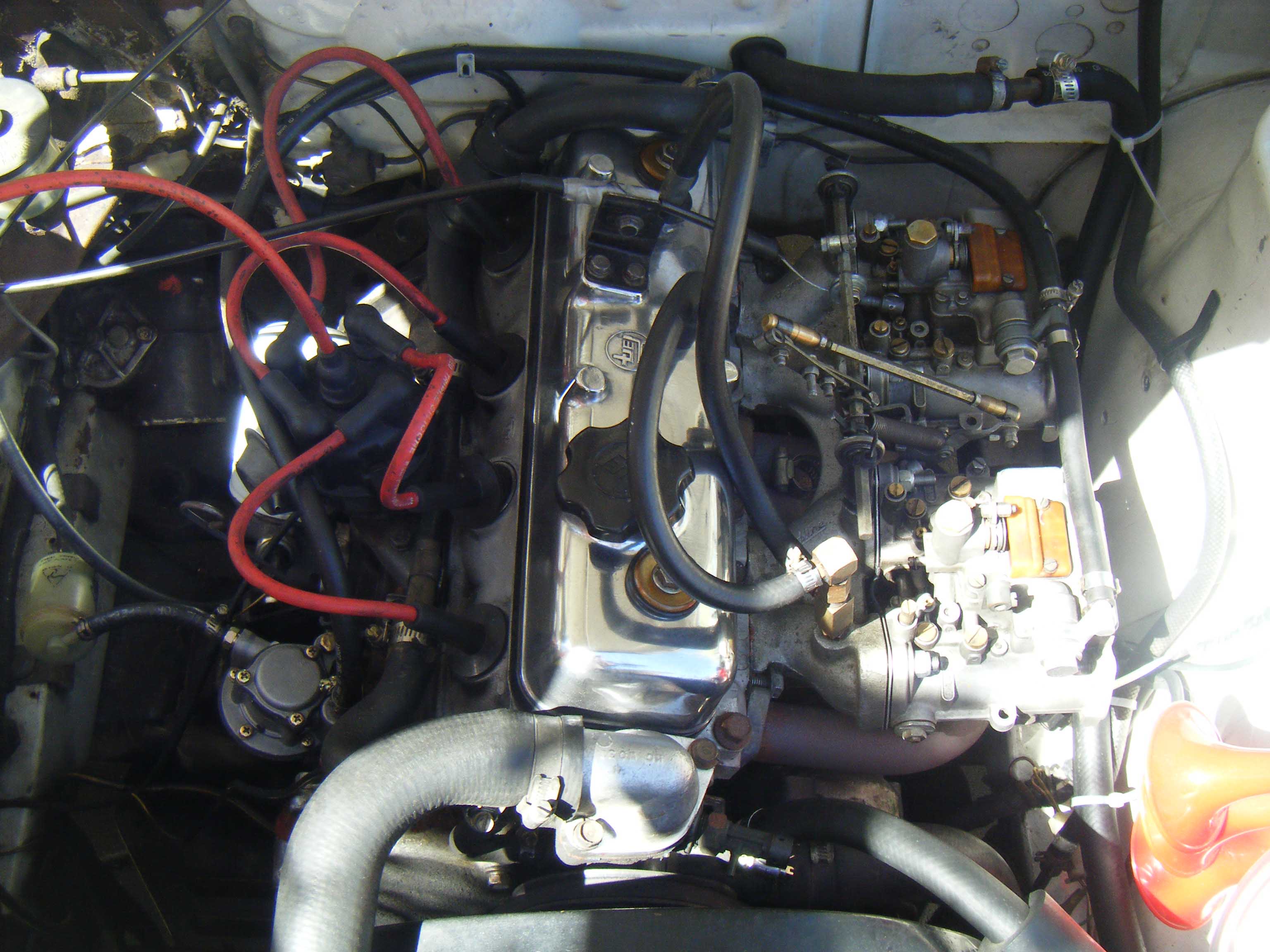

on the car.
Dellorto's getting Dyno Tuned Monday. Cars been off the road for 3 weeks now........:yes:

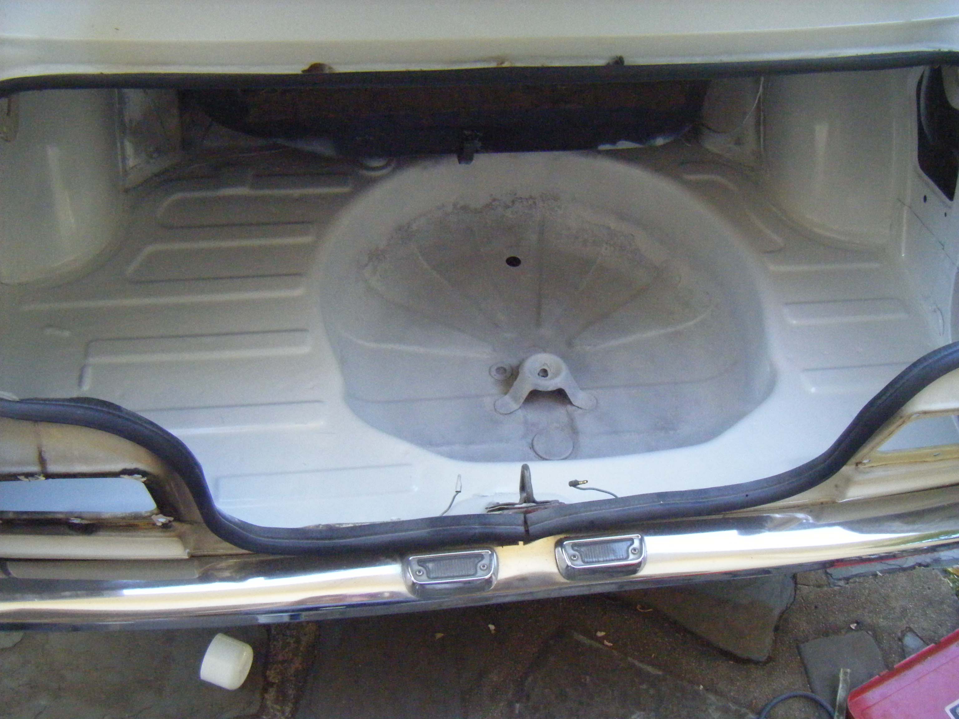

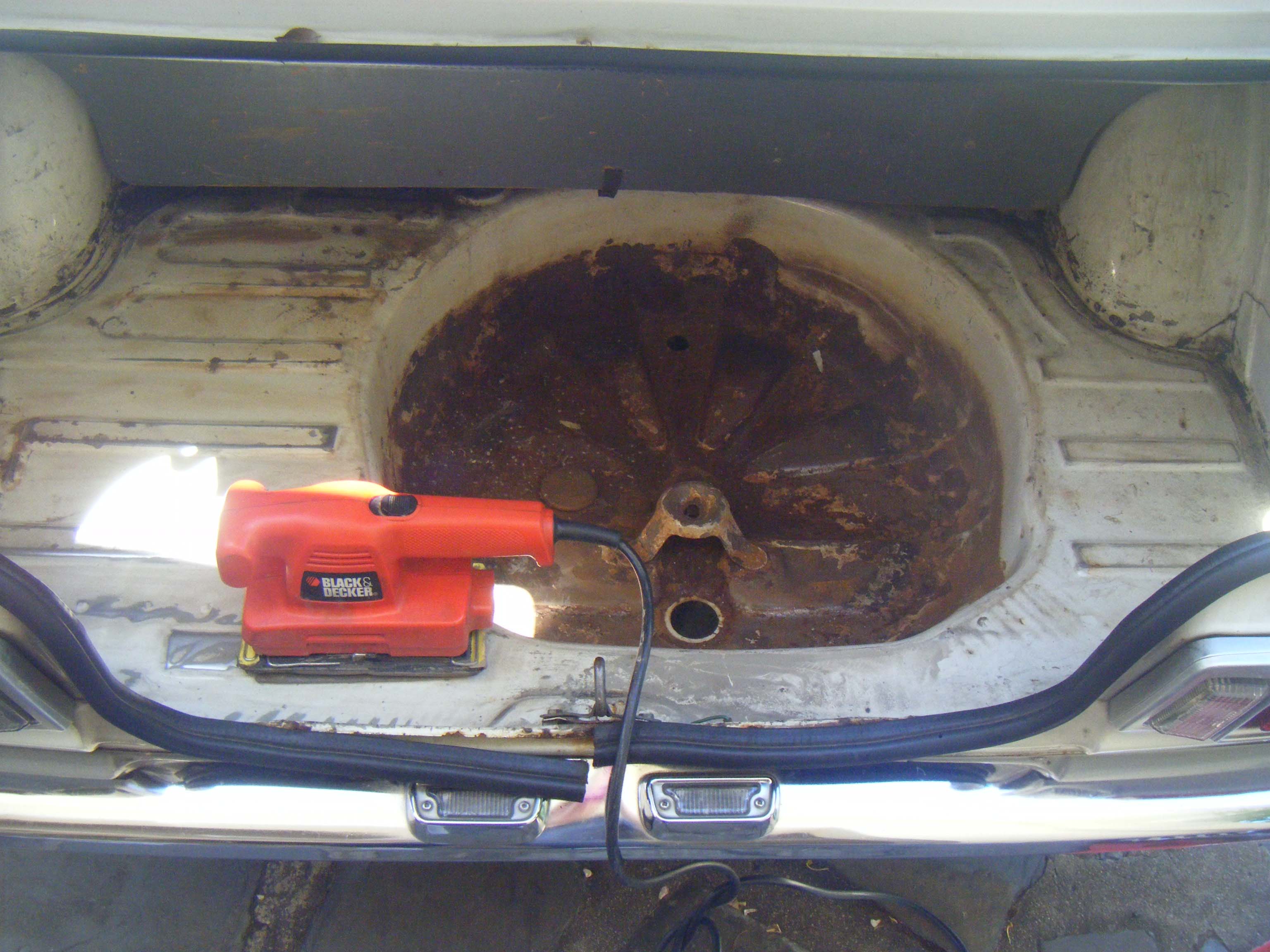

just quick update. been a while. Spent all day redoing my boot. lookin so much better now....Let pics speak for themselves.
more progress soon. :dance:
Mitch.
Looks alot better Mitch :dance:
