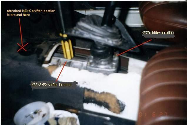

The ke70 box has the most natural shifter location. Well worth the effort.
Attached is a quick pic of where the shifter locations ended up in relation to each other in my ke15.

:( No. A ke10's shifter location is further forward than that of a ke20.
The k series boxes have 3 different shifter locations.
Forward: ke1x series
Middle: ke2/3/5x
Rear: ke70
