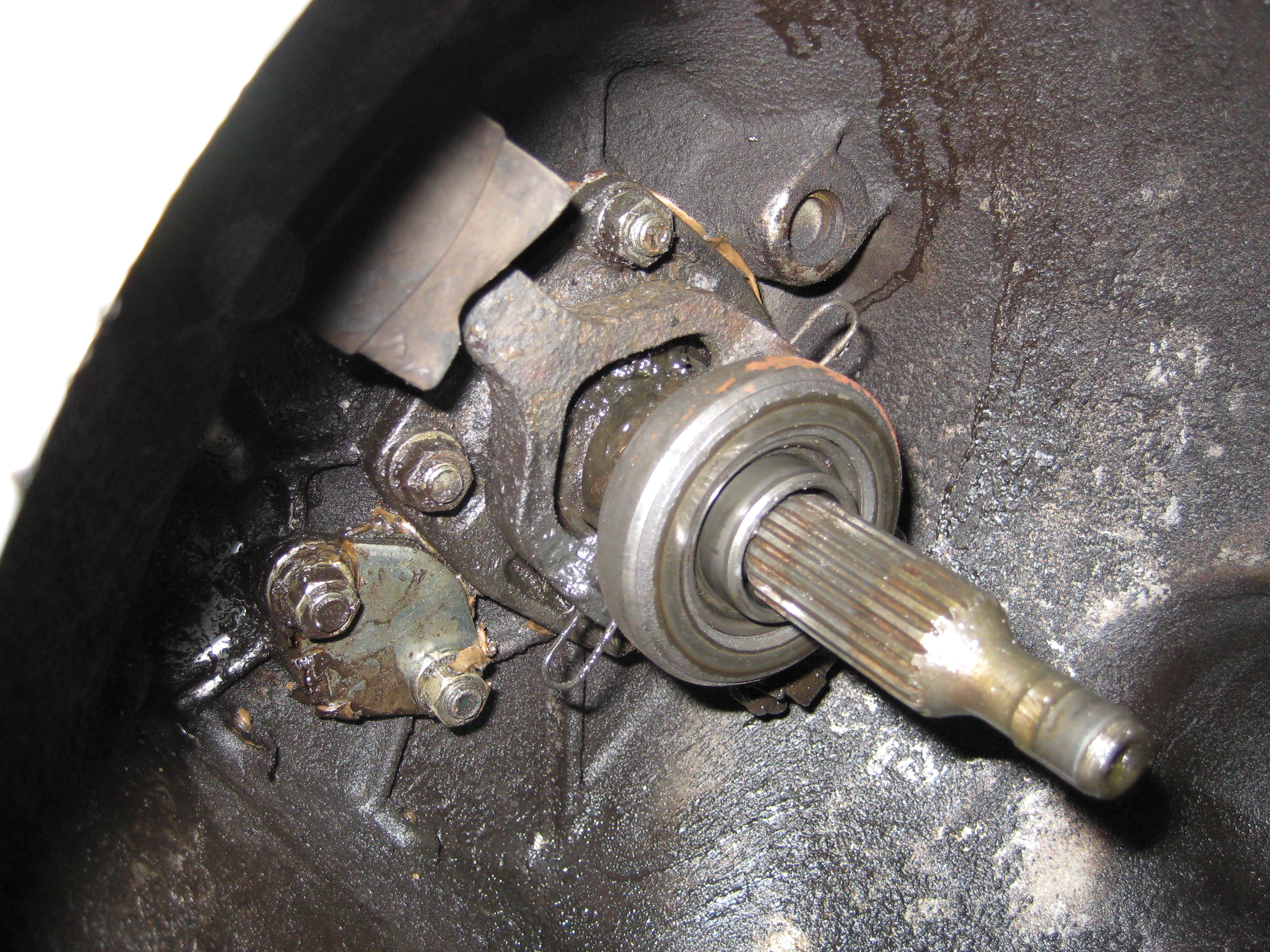

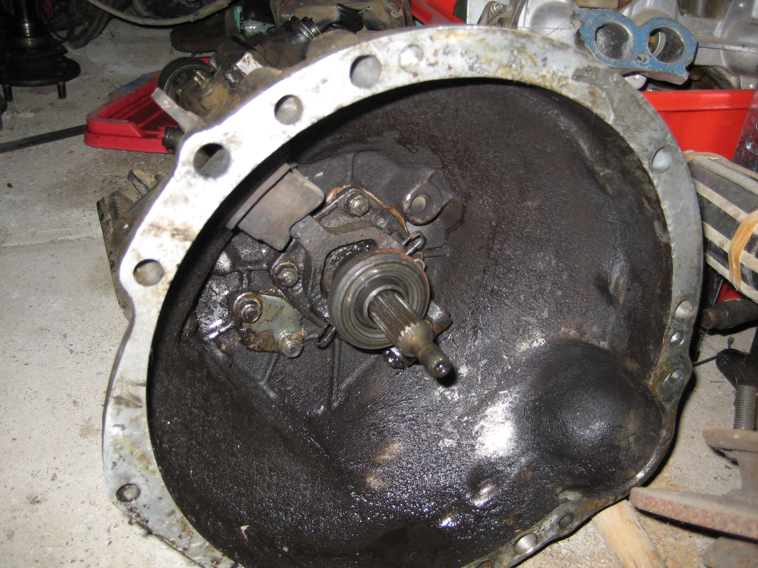

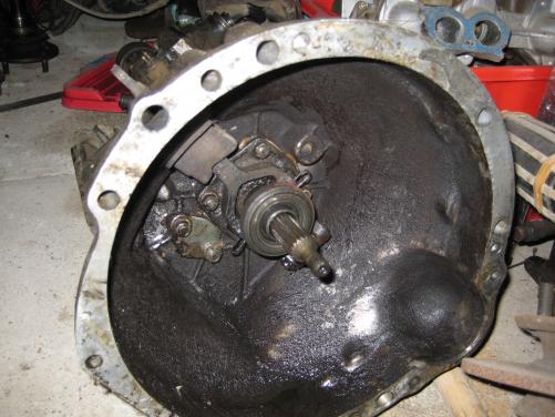

The bearing is attached to a bit of metal already. I'm guessing thats the bearing carrier as you mentioned. what hold that to the shaft? when you move clutch fork thingy towards motor the bearing moves with it, but when you return it the bearing don't return to normal. make sense?
Ah yea my bad thinking of a different setup. The bearing should be pressed onto the carrier. I'd say yours is worn out or the incorrect type.
ohh you beat me, i just took pics.
I need those wire bits, i see they holding the bearing and holder to the clutch fork thingy?
