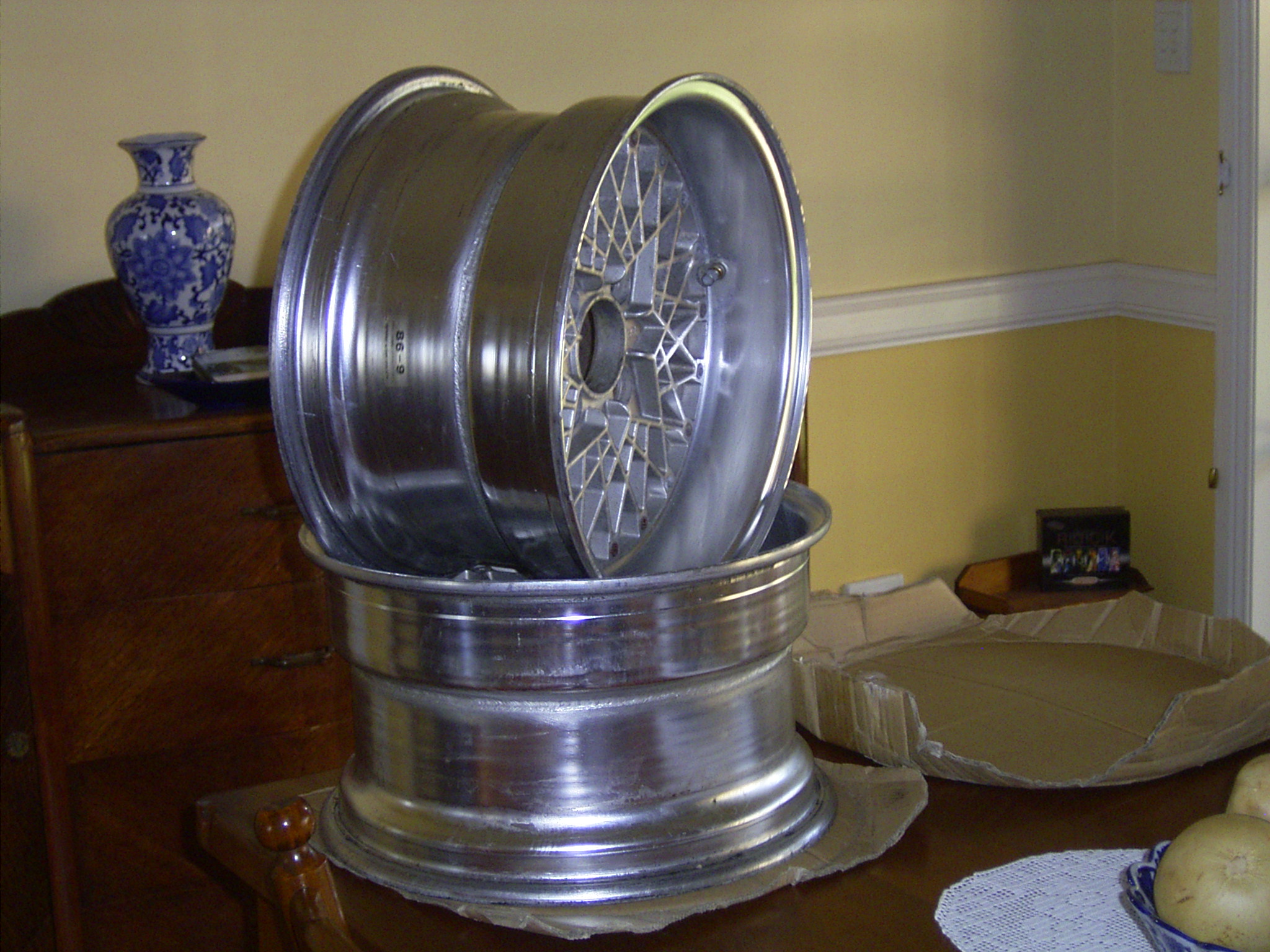

My wheels FINALLY turned up! Feel very relieved now that I have them sitting on my table. In pretty good condition too. A little bit of gutter rash, but apart from that, they look great. Measured them too, and turns out they are 8.5" wide and not 8", still a +10 offset though. Little bit wider is always good though, providing they don't foul on anything by half an inch :P

With the wheels being 8.5" instead of 8", just make sure you're measuring where the tyres would bead on the wheels, not lip to lip. Lip to lip will usually end up about an inch bigger than the real width. If it's really 8.5" wide then congrats! I want them. :P :D
With the wheels being 8.5" instead of 8", just make sure you're measuring where the tyres would bead on the wheels, not lip to lip. Lip to lip will usually end up about an inch bigger than the real width. If it's really 8.5" wide then congrats! I want them. :P :)
Ha yeah I've measured them properly. Checked them when I first got them out of the box just to make sure they were the size and offset stated. But yeah scored a half inch so that is a small bonus for having to wait so long for them :dance:
