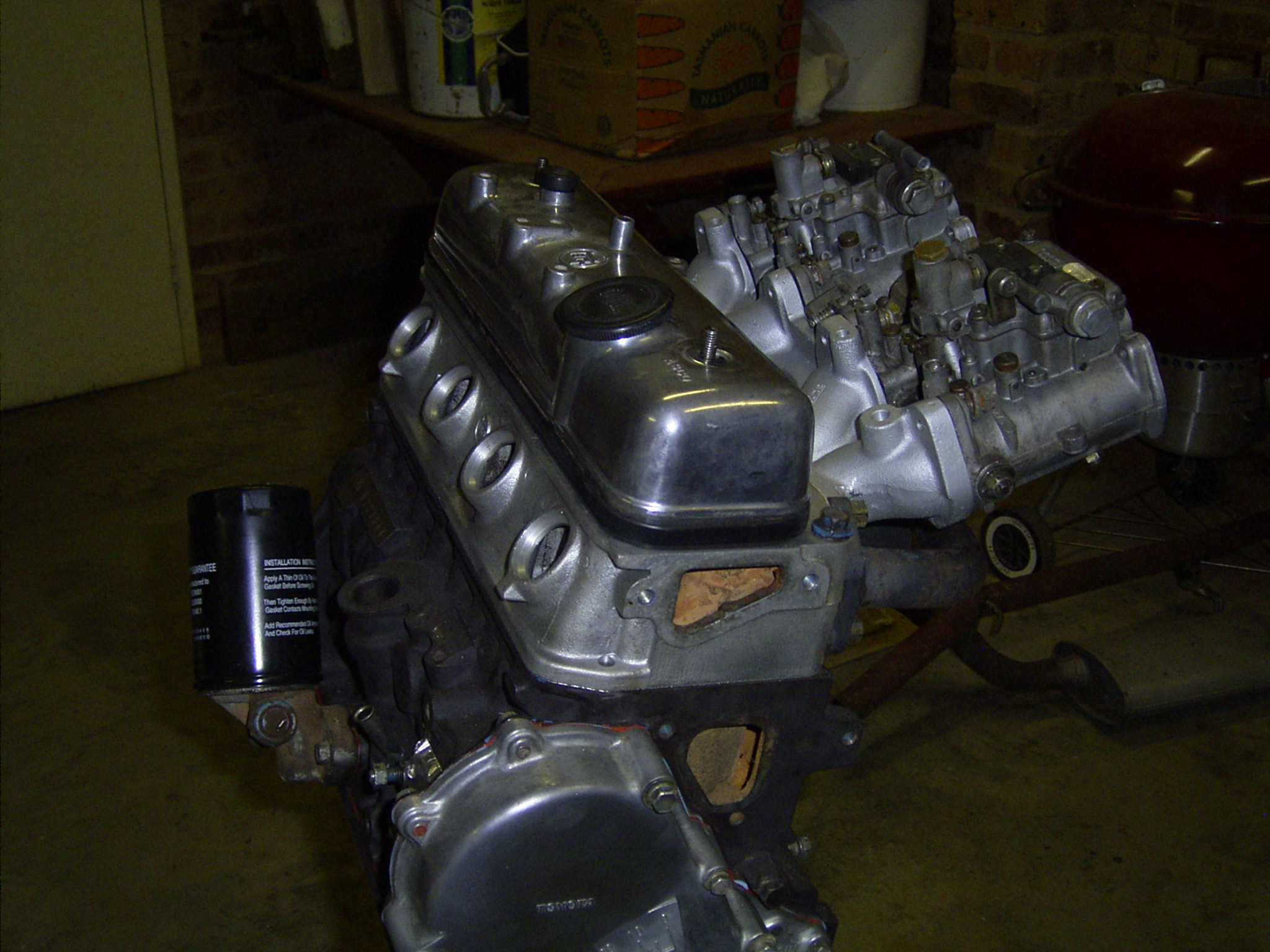

Engine should hopefully be in this weekend. long weekend + RDO on Tuesday = 4 day weekend! Plan is to get the manifolds all worked out now while it is on the engine stand, and when the time comes to put it in the car, just use the intake setup off my 4K so I can drive it, and run the engine in. Already has a Weber jetted for a 1.6 on it, so it should work pretty well on the 5K. After a few hundred K's I'll throw the twins on, and take it to get tuned :hmm:
Manifolds successfully mounted! Would have had the carbs on aswell, but realised I don't have any studs to fix them to the manifold with.
Note: Carbs are only test fitted there. Not actually bolted down porperly.
Well, today was a good day for progress. 4K is out and the 5K is just about to go in. Running the standard intake and exhaust manifolds for the run- in period, then going to swap to the right induction and get the exhaust mig'd together. Should have it cranking tonight if all goes to plan :hmm: Shall report in later tonight with further news.
