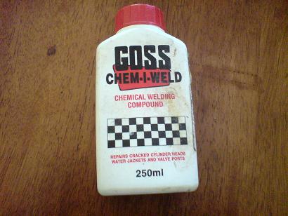

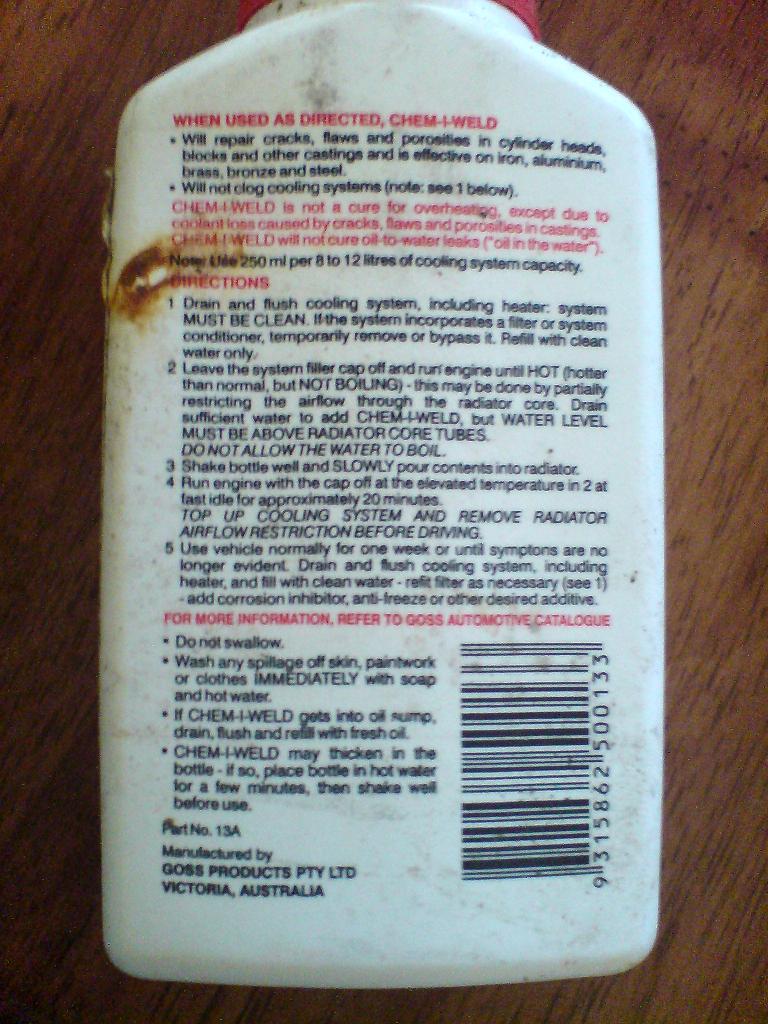

September 21, 200818 yr comment_276304 yeah do the gasket urself, whats this chemiweld you speak of? This should only be used for a cheap fix. Will last you a good half year if you don't thrash the car or rev it too hard. As i said it used it on my Datsun 200b. I bought the car for 100 bucks, 3 months later head gasket shits its self, poured chemiweld in the cooling system, drove it for another 9 months then got caught doing burnouts from the police and they gave me a cannery so easy come easy go.. I found a bottle in the shed so here are some pics, click on the second pic for details, sorry for the crap quality (phone camera) You can buy it from auto shops like AutObarn, Supercheap Auto or Repco Report
