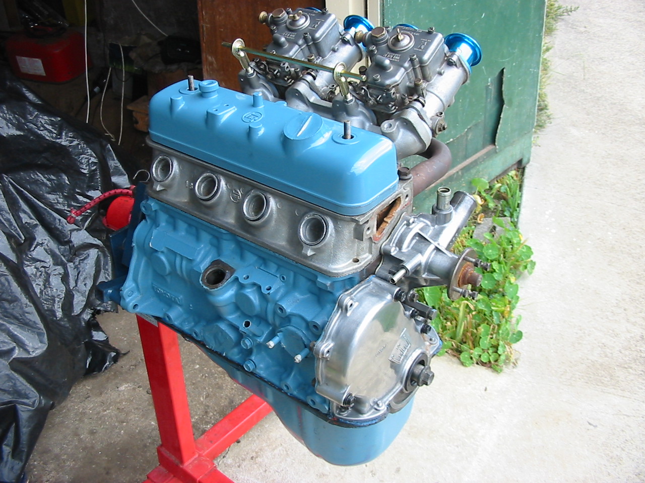

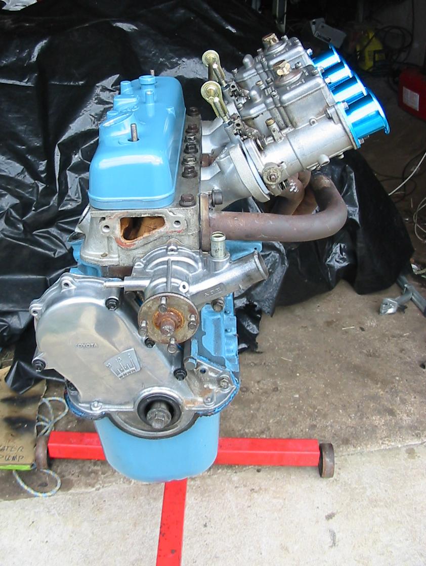

All starting to come together now! Big thanks to casey for the lend of the engine stand!
Picked up my heavy duty clutch today! Had some issues finding one the correct size so had to get one made up in the end as its 200mm instead of the standard 180mm...
Some pics!

valve clearances set today, fitted flywheel and also clutch!
tried to bolt up the gearbox, but didn't have a spigot shaft to try and line it all up! so i cracked the shits and left it haha!
Gotta work out where to pick up a manifold vaccum for the dizzy too!
