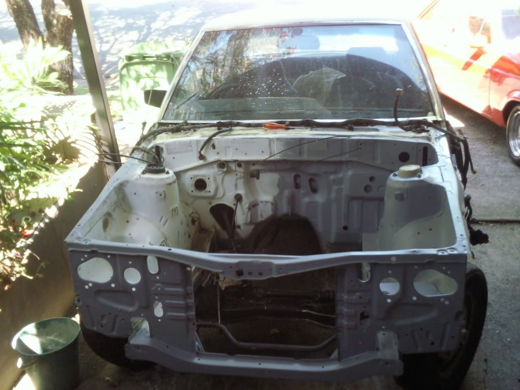

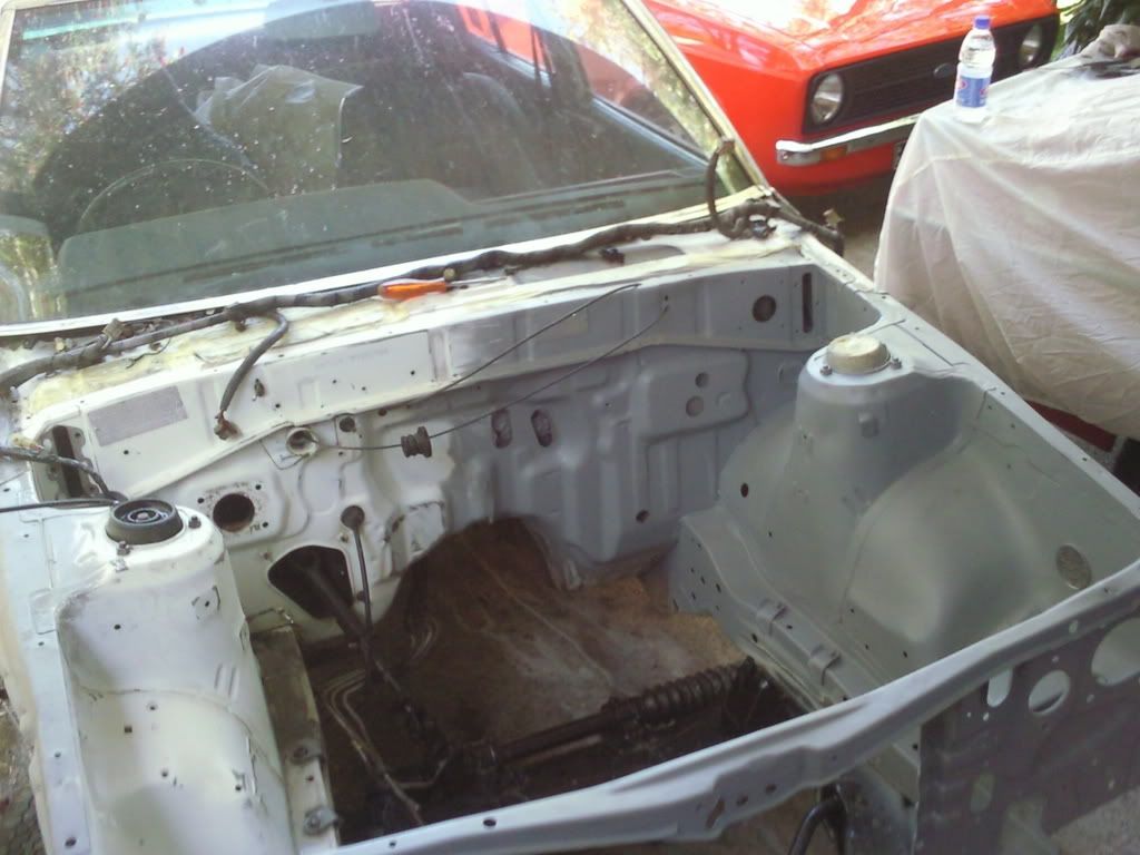

kra55 Posted September 27, 2008 Author Report Posted September 27, 2008 I plan on treating the car very nice for a while I'm still going to be running the borgie as well :yes: plus i havnt realy driven cars with power that are rwd so yeh.....lol The escort is ok but the ke70 makes doing somthing with the engine alot easier - might just dump a 2tr or maybe a ca18 in the escort one day.....Plus cause thats my first car and i have wasted money on it i don't want to screw it up in anyway lol Some random pics my brother has been doing some work on the engine bay :yes: aparently I'm getting it sprayed next week :yes: so i guess its worth holding off on sitting the engine and gearbox :hmm: - play on posting more pics later today once i manage to get them off a mates phone Quote
The_Lab Posted September 27, 2008 Report Posted September 27, 2008 haha been in supervisor mode the past 2 weekends LOL Props to dilbz and krass for getting the engine bay all prepped for paint in the next fortnight :yes: It going to come up cleaner than i ever expected it to be :yes: If i get there tomorrow ill clean out the interior :hmm: Quote

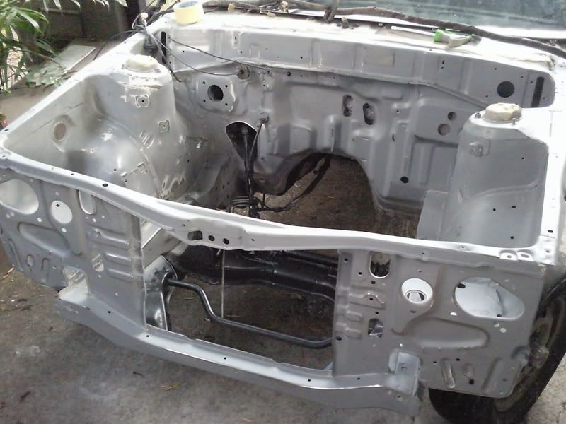

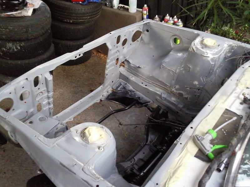

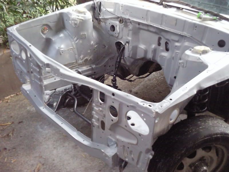

4agzerola Posted September 27, 2008 Report Posted September 27, 2008 (edited) Have pretty much finished the Engine bay just need another wet sand before paint, Got my mate from Archers Smash Repair to come around this arvo and help me finish it off. Painted the brake booster and all the other little bits aswell. Also setup a Electrolysis System to clean up all the parts with surface rust. Works really well for them small parts you can't sand or paint that need cleaning up. All you need is: Car Battery Charger, Bucket, Water, Zip tie, Spanner, Salt & Lemon or Baking Soda. Example DIY Link: http://www3.telus.net/public/aschoepp/electrolyticrust.html Have to clean up the Flared Guards before they go back on. Going to be abit of a sleeper until we rub the exterio back and paint it white so its looks fresh. Will get Kra55 to take more pic's tomorrow, ill make sure he gets some before and after shots of the bits i clean up using the Electrolysis setup, Ill get some of the Electrolysis System we made today aswell. Edited September 29, 2008 by 4agzerola Quote

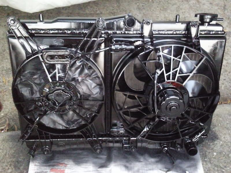

4agzerola Posted September 29, 2008 Report Posted September 29, 2008 (edited) Updated Engine Bay Photo's. Just need to touch up a few little bits and wet sand again. Excel Radiator With Dual Thermo Fans. Cleaned it up a little bit & flushed it with radiaotr cleaner. Need to get it compression tested before we make the mounts and fit it. Edited September 29, 2008 by 4agzerola Quote

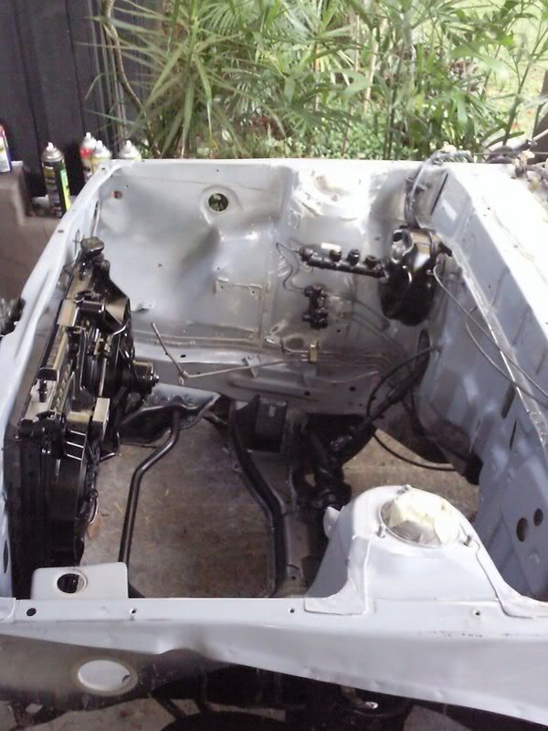

4agzerola Posted October 1, 2008 Report Posted October 1, 2008 (edited) Got some more Photo's today been playing with radiator and front mount. Have to cut the hole's for the piping and make the brakets for the radiator which ill have to speak to my mate about at Tricky Weld. Fitted the refreshed brake booster aswell for fun. Gets painted in 2 weeks! :y: All for the coast of the Paint, Carton of Beer & a Bottle of Spirits. So not much i can do till then but clean up all the little bits before they go back in. Zip Tied the Fron Mount on to figure out where to cut the cooler piping holes. Raditator is Zip Tied in aswell to check bonnet & piping clearance. Brake Booster after i put it in the Electrolysis setup. Cleaned it up real nice, then gave it a coated of black. She's Getting there nice and quick, thats 3 weeks of work :hmm: Have to figure out how to make the brackets for the cooler & radiator? Any Suggestions? Edited October 2, 2008 by 4agzerola Quote
