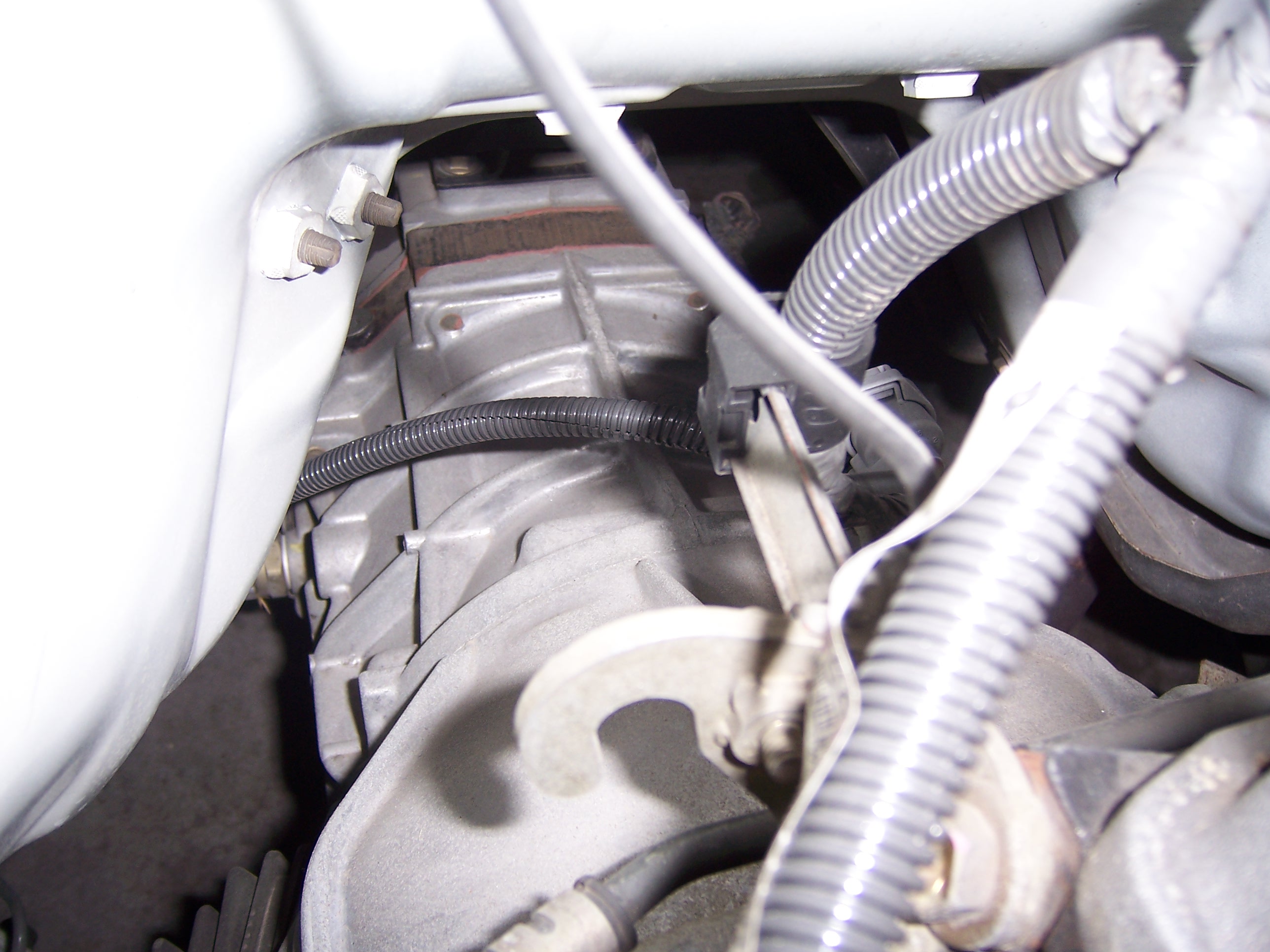

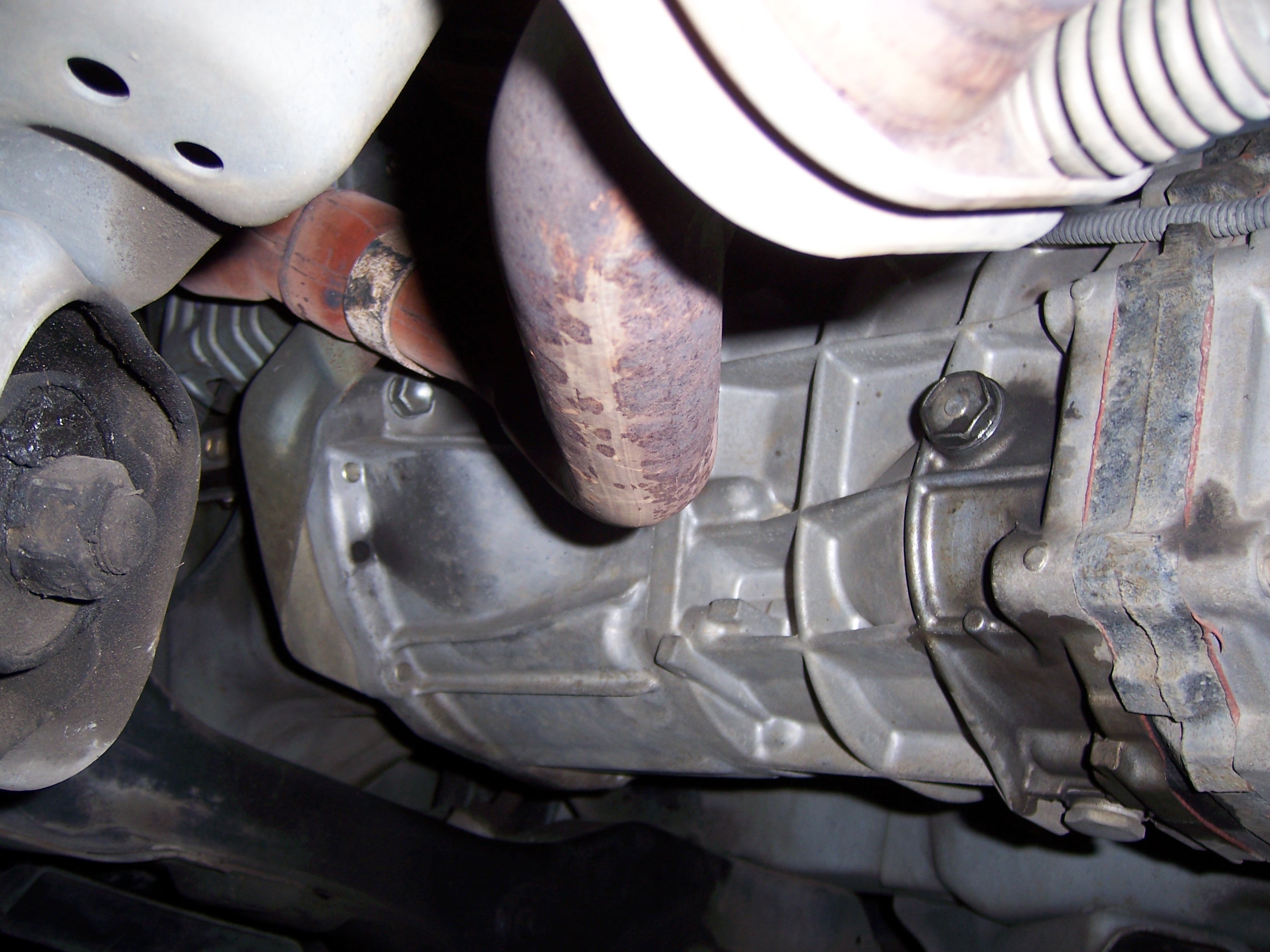

Somebody got pics of a TE72 T50 please???
Well the shifter on the TA22 box pictured doesn't look like any of mine and I've got an AE71 and TE72 one, but maybe they still mount up the same.
