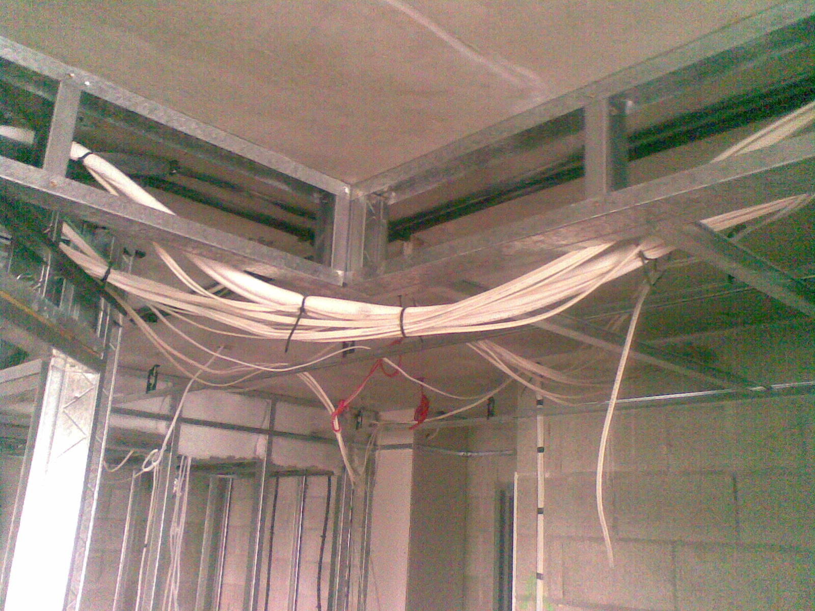

This is from the disabled unit at work. I find it odd that the internal doorways are 900mm wide while the front door is 800mm and the balcony sliding door is 800mm too.
I just don't see how the chair will fit through.

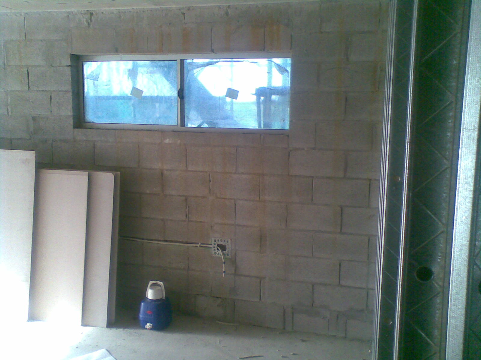

Then there is this window. Will they get a stick to open it??
Is that 800mm between the frame structure or 800 after the door surrounds are in, The doorways here at home are 800mm and Shawn can get his chair through but the disability house he is in has larger doorways and sliding doors all through the house (apart from the front door).
Edited by Trev
900mm for the internal steel frame without jams and 800mm for the external finished frame. Oh and there is a step down onto the balcony.

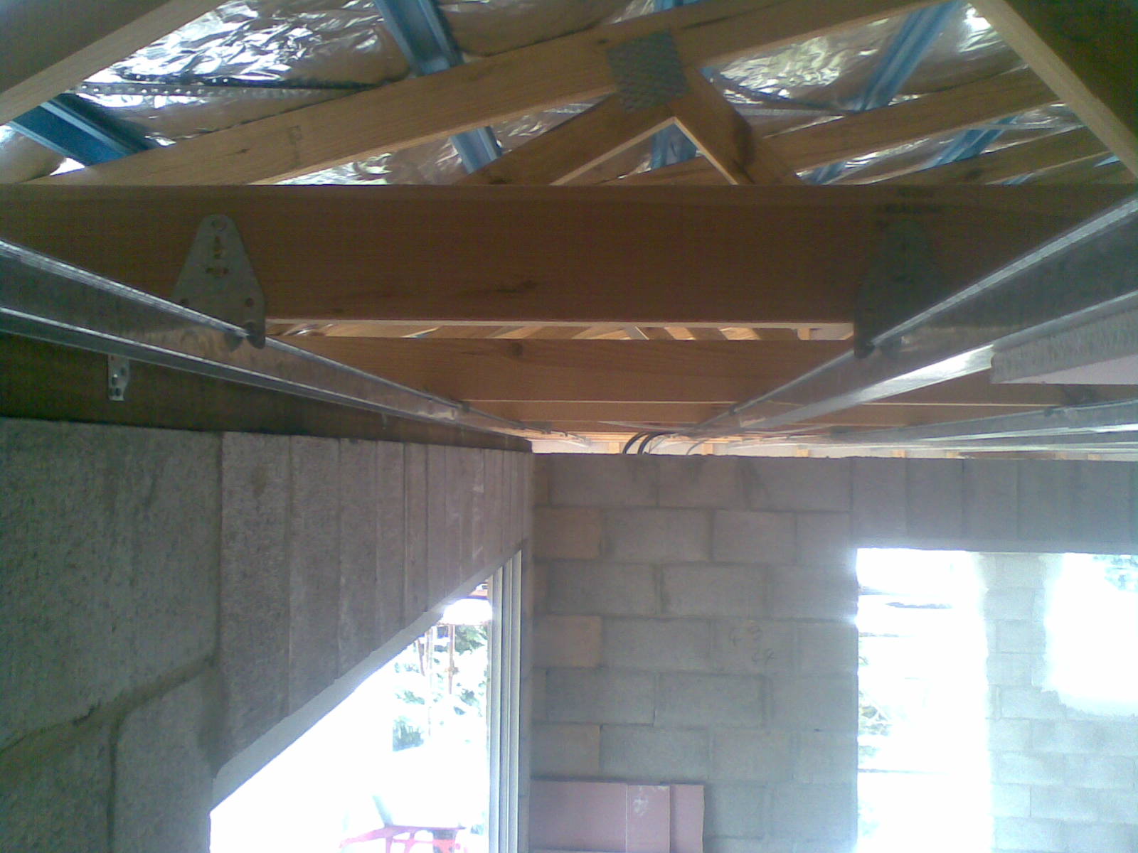

Same building, these are the battens attached to the trusses that hold the fire rated ceiling sheets. Not sure if you can see it but the trusses aren't level...
They didn't use a laser to level them out :cool:

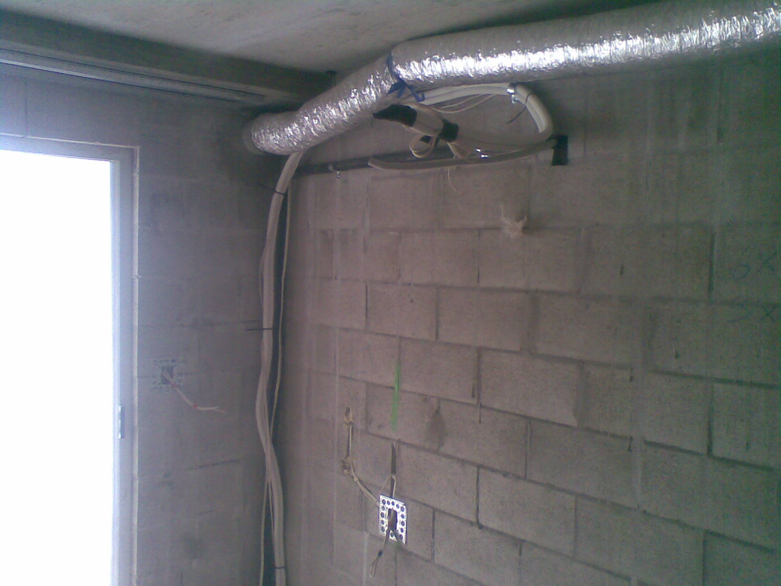

THE AIRCON DUDE STRIKES AGAIN!!!
We are on floor number 4. Every floor we tell him he needs to give us more space. This time we just built our shit and told the site manager to call him and tell him to fix it.

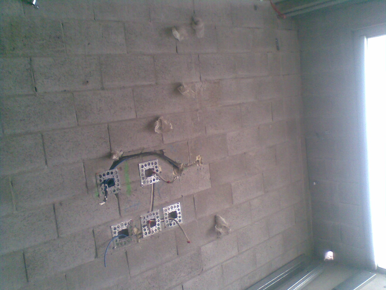

This is how his pipes should look. On the same wall as the mechanical vents...
He mounted it on the opposite wall. This would mean we would have to build a bulkhead on 3 out of 4 walls in the room. After we complained he ripped it down and moved it to the other wall. Pitty he didn't clean his clips off the wall. No someone else has to clean up after him AGAIN.

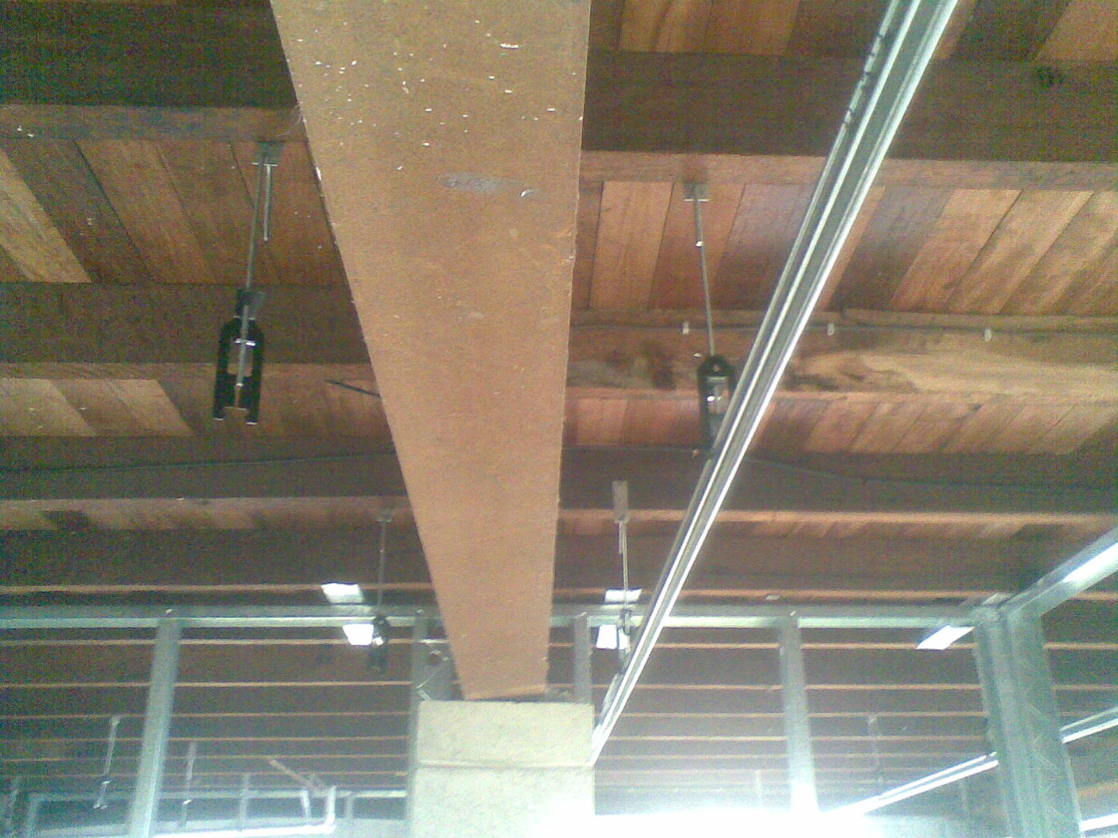

And this shows the I beam above. Its warped...
So thats a warped I beam sitting on a crooked post. There was more but I didn't take pics.

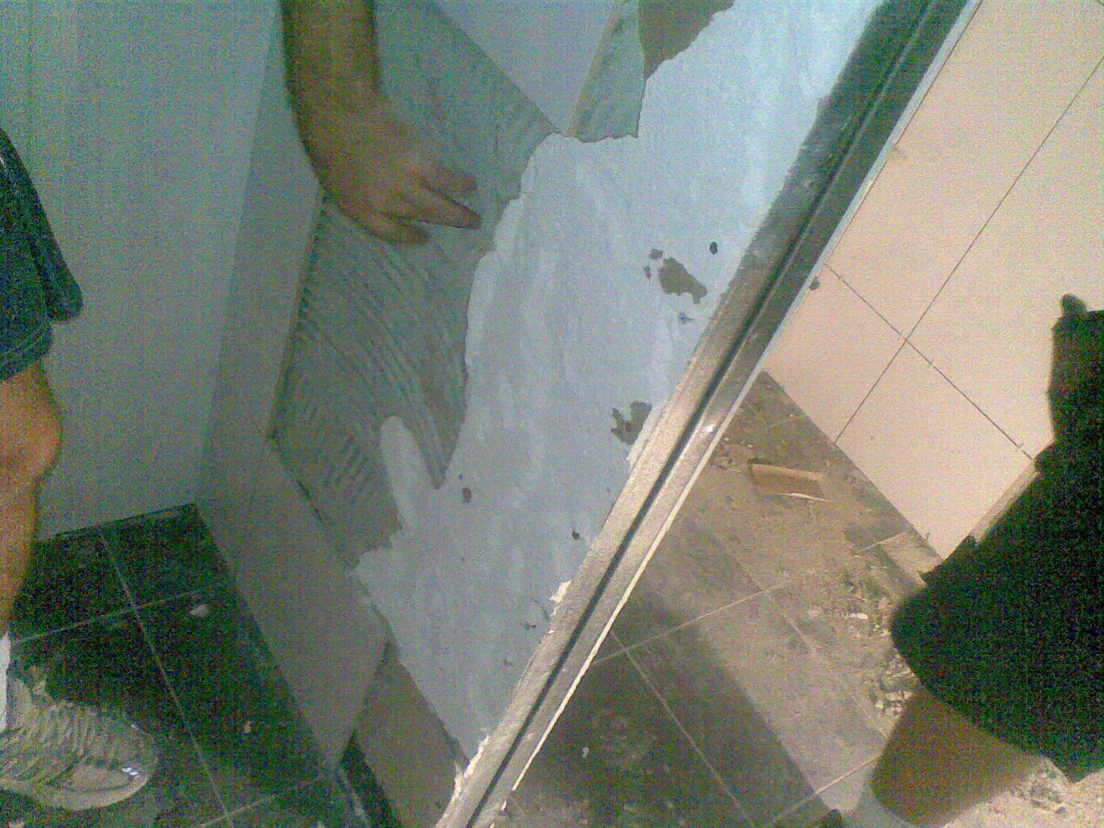

Part of yesterdays repairs. There was a f@$k up and the wall had to be extended. Tiles had to be removed and with it came off most of the board. But no, we are not replacing the board. What was left was really thin and the tiles wouldn't hold well. Plus as soon as someone leans on the wall the grout will crack.
Nice tiles tho...
