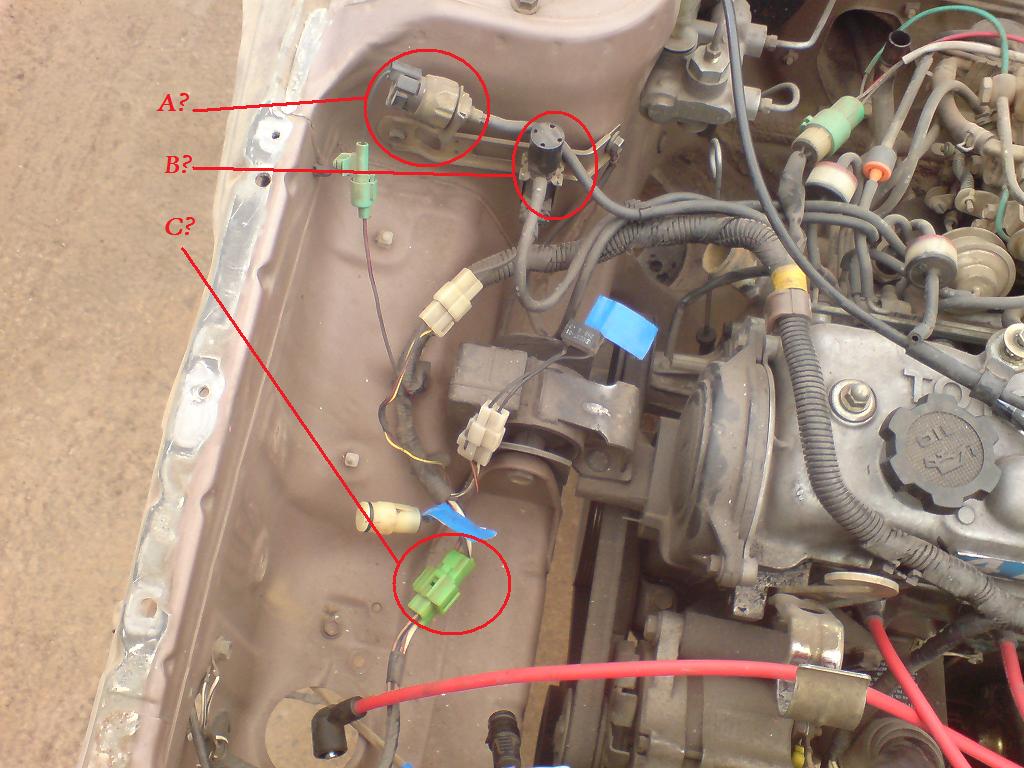

I'm pulling out my old 4ac engine and putting a 4age bigport in. I am in the stage right now of pulling everything out and labeling wires, hoses, fuel lines and thinga-ma-jigs. I wanted to know what a few things are called..

the others...not too sure...where to the wires lead on c?

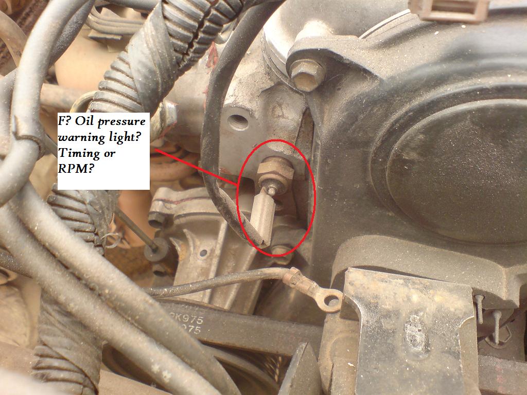

is f on a water outlet? if it is, it'd be a water temp sender

F = I don't think its water temp cos i already found that sensor on the thermostat housing.
D= Is that where all the pollution and soot goes?
C= I think comes from the battery and powers the loom to go inside the cabin for the fuse box.
E= I would like to know what "e" is so i can label the green plug.
A+B= Not too fussed with them 2, I think they are just some vacuum thingo.
Sounding like algebra here.. :P

F - Is the temp sender for the guage, The one on the thermostat housing is the fan switch.
D - Yes, It returns fuel vapours back to the tank.
C - can't remember which one but it goes to the starter, the alternator or the dizzy (I don't do alot on the single cam 82's)
E - Pretty sure that is the purge valve for the charcoal can.
A & B is for the a/c idle up.
