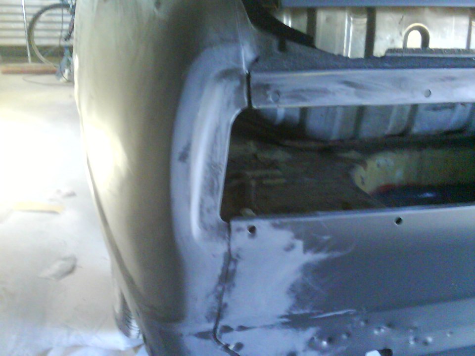

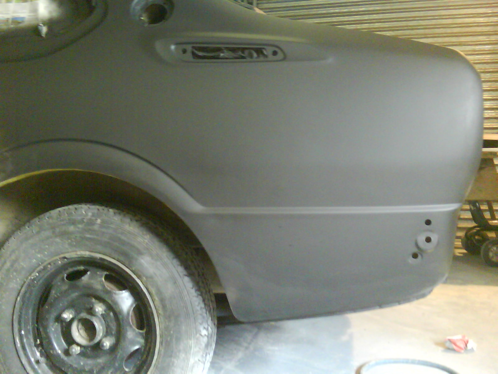

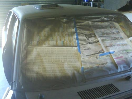

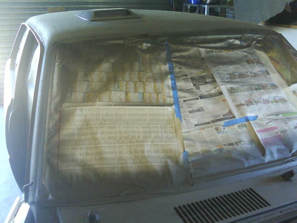

worked on it for awhile 2day
heres sum more pics :y:
post-7051-1228895648_thumb.jpg :P rally scoop :P
I was going to cut a hole in the bonnet to put the scoop on but its rusted out to shit on the back :P I'm gonna have 2 get a new bonnet... :D

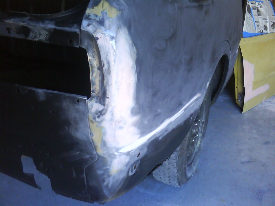

yea haha its suprised me how little it really needed, just afew more coats of primer & acouple hours of sanding and it should be ready 2 paint,

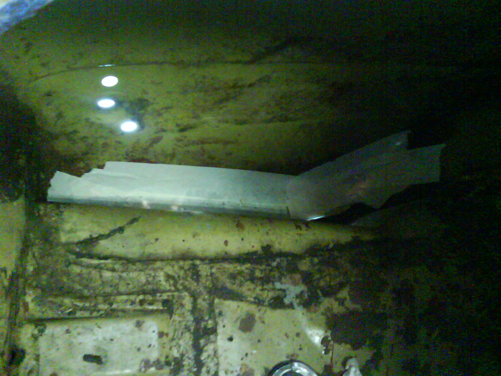

I got a rusted out right quater panel that wasnt rusted on the part i need for mine :yes: so i'l do alittle choping and welding :no2:

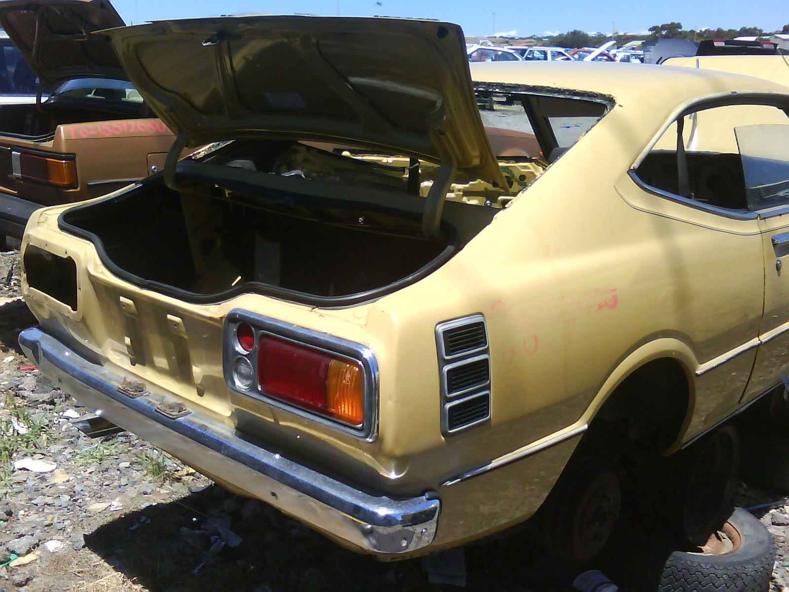

hey guys,
I spent the whole day at you pull it & iv got heaps of shit... :y:
just woundering... has anyone tried to fit the ke35 taillights 2 a 30? I'm gonna do it i like the look of them :jamie:
Il add sum pics 2moro.. I'm going out 2 get pissed :no2: :yes:
i got the most pimping interior from a corona ;)
Hey, they'll need a lot of modifying to the body. The lights are bigger and bulkier. Don't see why you'd want them. To I've never liked the coupe lights. But each to their own. Not sure about the wiring tho. You might need the loom too.
yeah haha I didnt notice how much bigger they are :dance: I must have messured them up 2 a ke 55 while I was there :dance: I'v still got the receipt I might just take them back haha
They'll give you a credit. You wont get your money back.
all good. might keep them & try it later :dance:

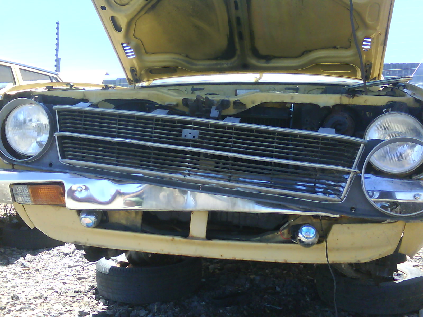

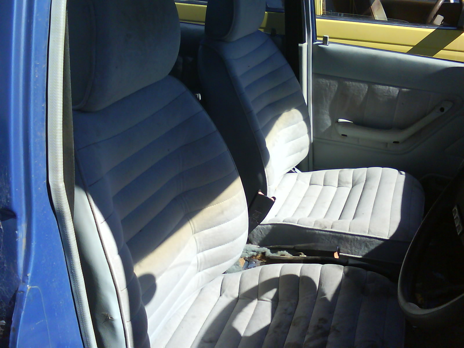

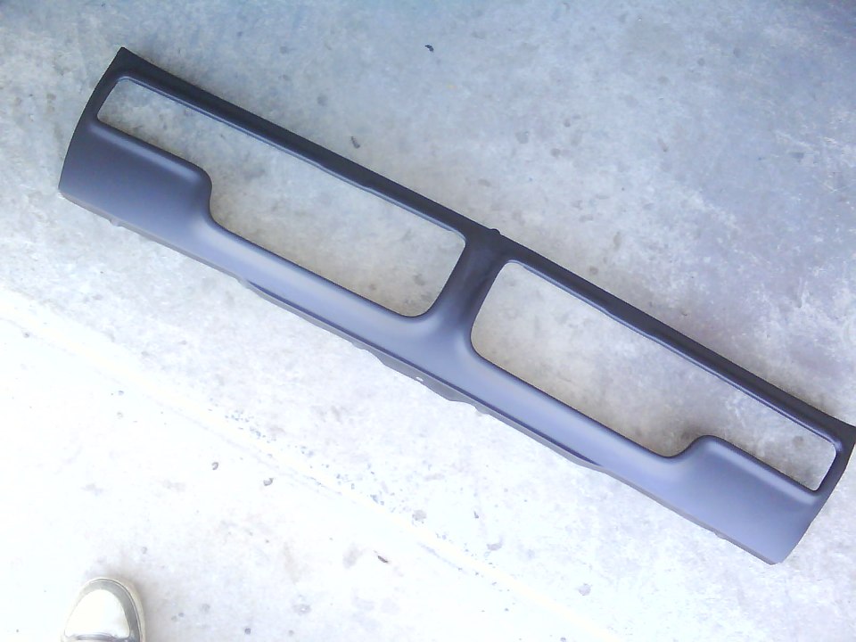

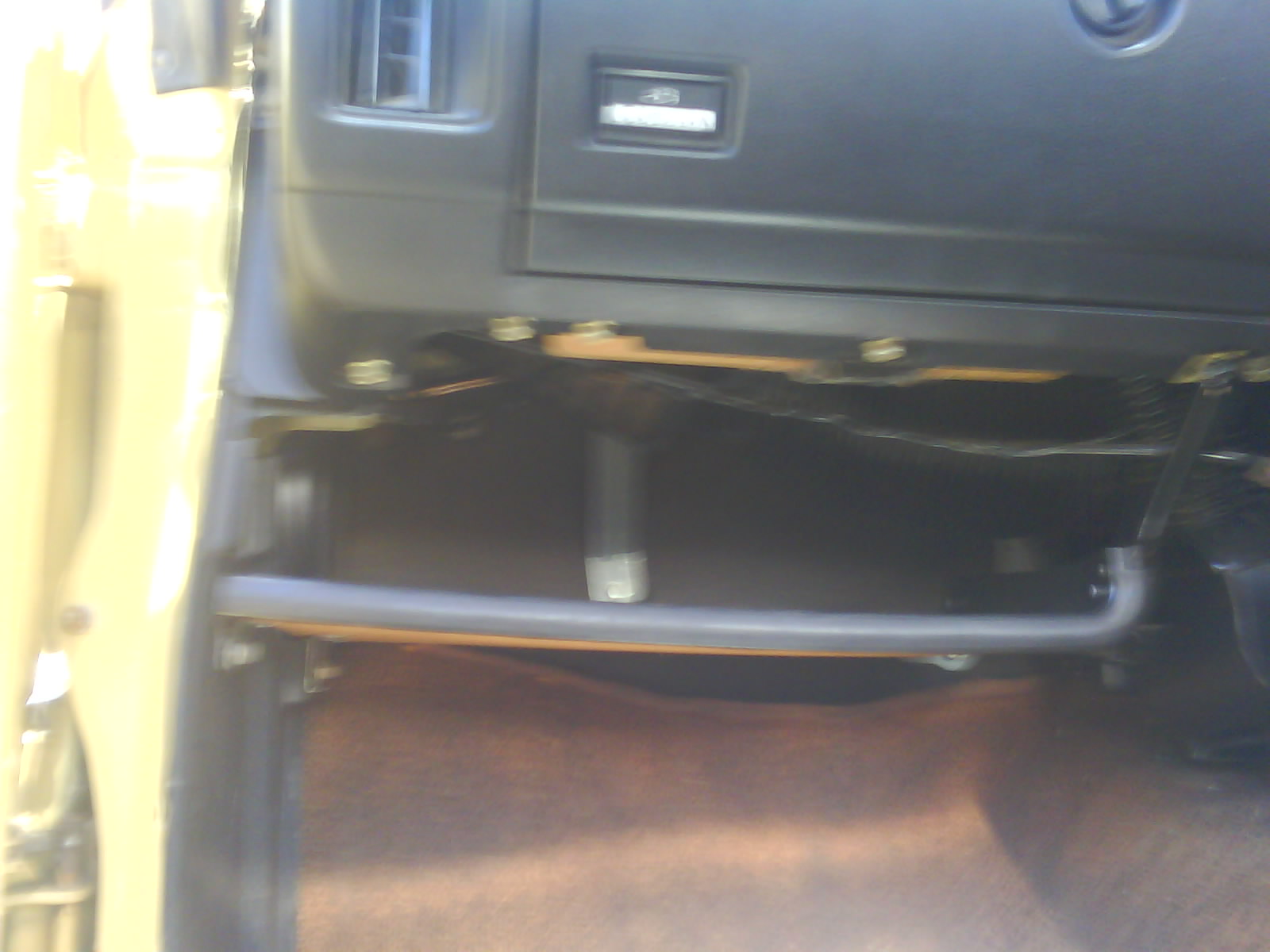

anyway Heres sum pics of what i got & what it was on :dance:
sick Seats (front & back) need to be steam clean
foglights (look beter than they do in this pic)
Tail lights
Shelf for under the dash

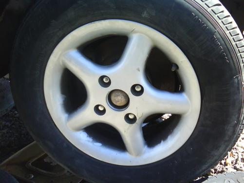

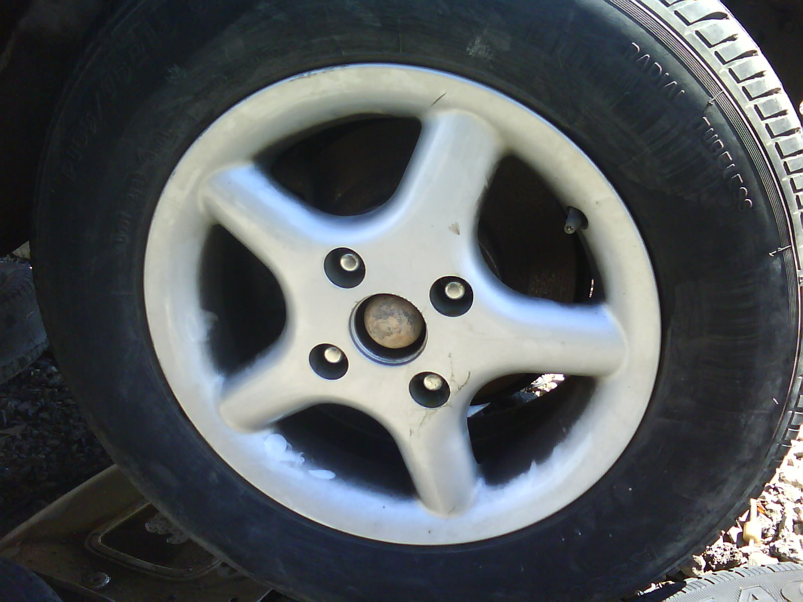

& I might grab 2 of these rims..(theres only 3) I'm going back soon to get a bonet (didnt have enough space)

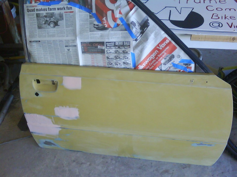

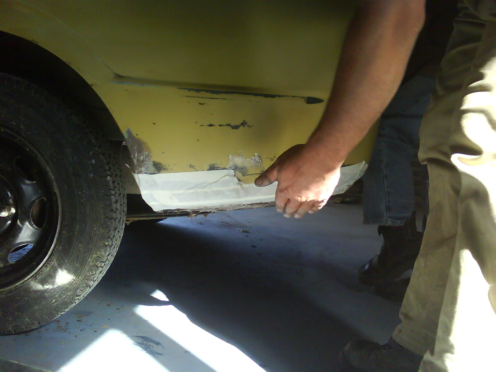

Hey Man looks like you are getting along real nicely with the car,
just curious as to how you applied that bog with the tape??
could you teach me the ways?? :dance:

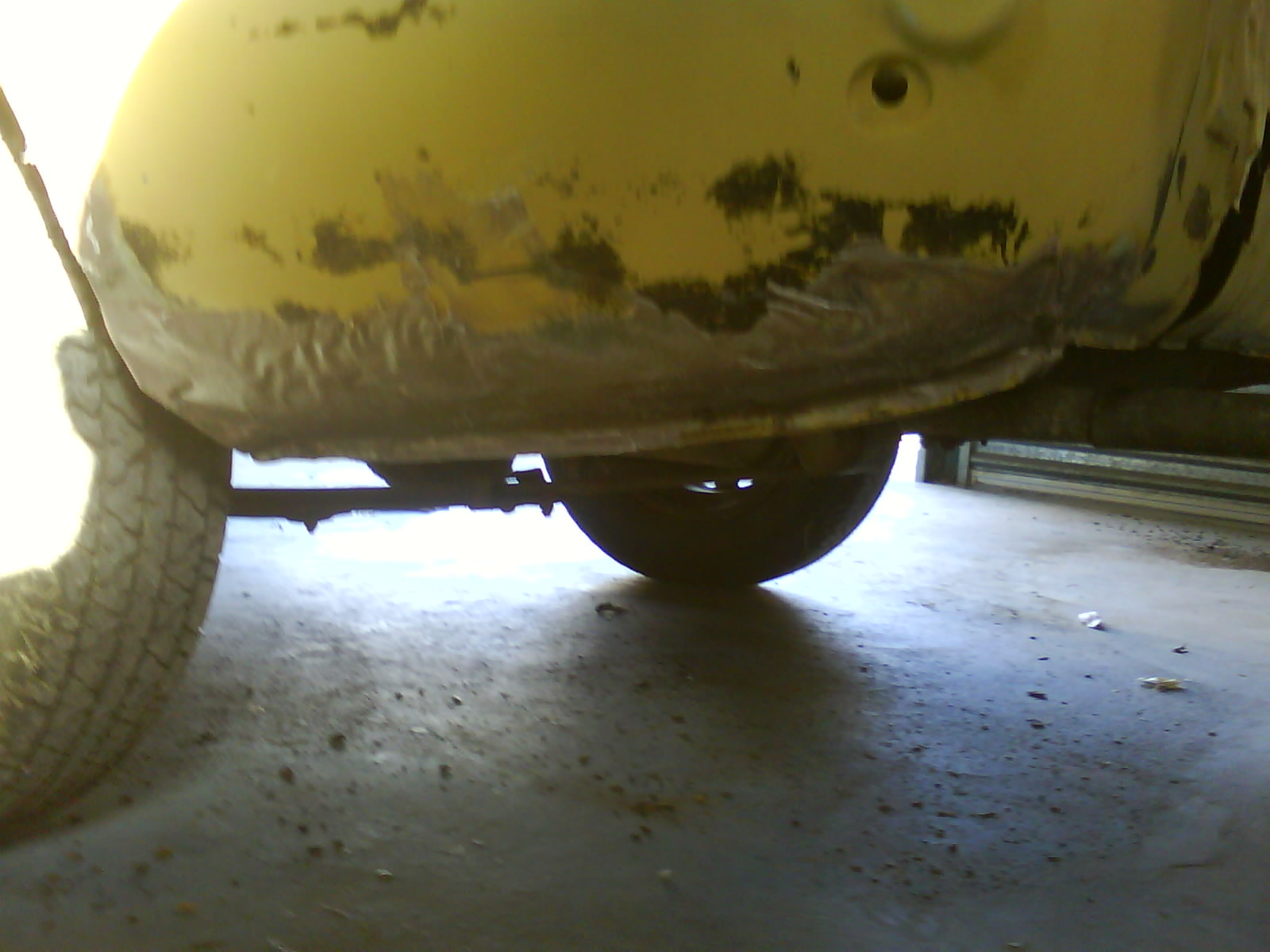

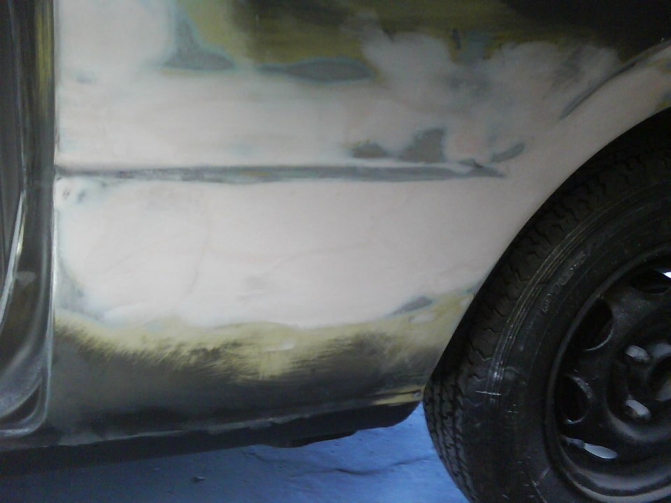

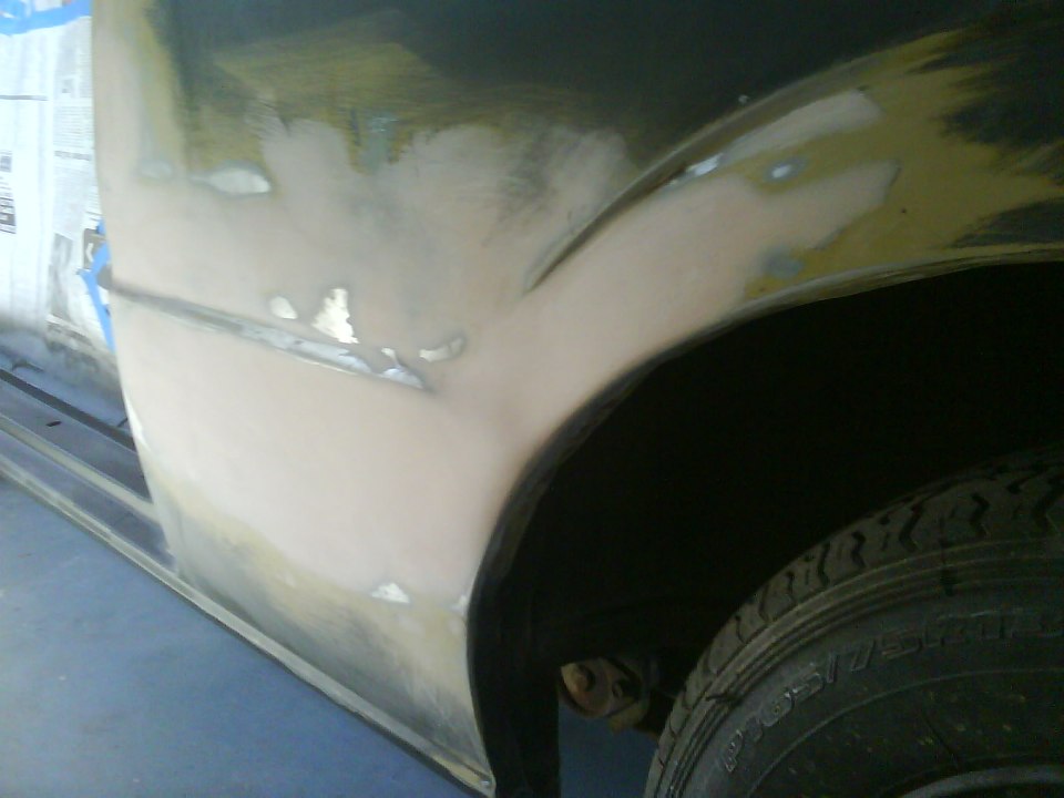

yeah no worries its actualy body filler - almost like fibre glass
1*tape the inside of the hole up so its smooth with the outside surface,
2*stick afew pieces of tape together with the sticky side up (big enough to cover the outside hole),
3*apply the body filler to the sticky side up, then put it over the hole, smooth it out as much as possible (makes sanding back easier)
4*then once its dried take the tape out and sand it back to silky smoothness :dance:
heres how it turned out :dance:
