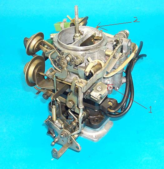

  18. Hi All, It's me again with another possibly dumb question. IOn my carbs I have a few vacuum connections, and I wanted to know what the vaccum connection on the top of the carb just below the lip for the airfilter is for. (# 2 in pic) I have one on both of my Aisin carbs on my twin carb seyup. Also Why is it that only one of my carbs has the connection for the bottom vacuum that I believe goes to the Vacuum advance. (# 1 in pic) around there. sorry for bad picture any help would be much appreciated. P.S I don't have as many vacuum lines as the one in the pic.

  20. ****Note - all thins is being taken from a single carb and not a twin carb. But either way i can't see there being anything different. The other carby should have a vacuum connection in the same spot as the "main' carby it'll just have it blocked off - try swapping the gauge over and see if there's any difference in readings. Both readings should be pretty close together***** the second carb does not have the vacuum connection in the same place.. The vaccum connection on the carb I am using is the one down the bottom of the carb however both carbs have a little vaccum connector at the top just below the airl filters.. should I be using that part. ??
  21. I don't even have 4 carb intake runners I think. I have the hose from the PCV valve to the manifold. the vaccum advance from the main carb to the dizzy (second carb doesnt have one) and the hose from the brake booster to the manifold, also there is a large fitting on the left side of the intake manifold but I never connected rthat to anything.
