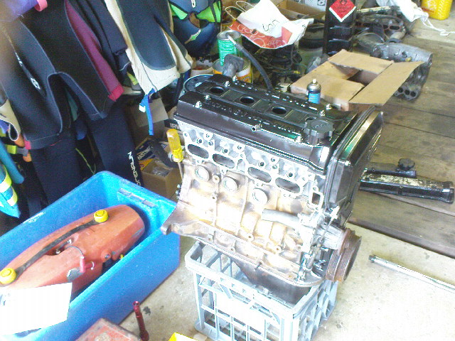

YAY rings arrived today,
had to re-hone the cylinders because i missed a tiny little scratch in the NO.3 cylinder
only problem was my honing tool was mangled so i took it back to super cheap and they gave me brand newy
this weekend i hope to have the motor back together and will try post up pics of the water system I'm trying to perfect using all FWD parts

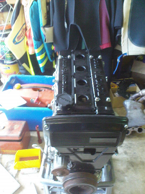

ive painted my cam covers black with same paint as the extractors,
will have pics by sunday night,

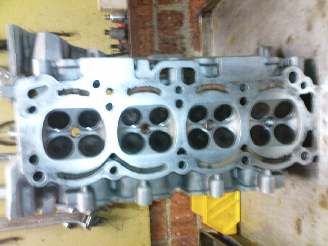

head rebuilt with valves lapped and completely cleaned
i havnt tested it yet, but the piston ring gap was borderline needing to bore it so I'm thinking the compression wouldnt be brilliant
i rebuilt the head myself and havmt skimmed it either so wouldnt be anything over stock compression either

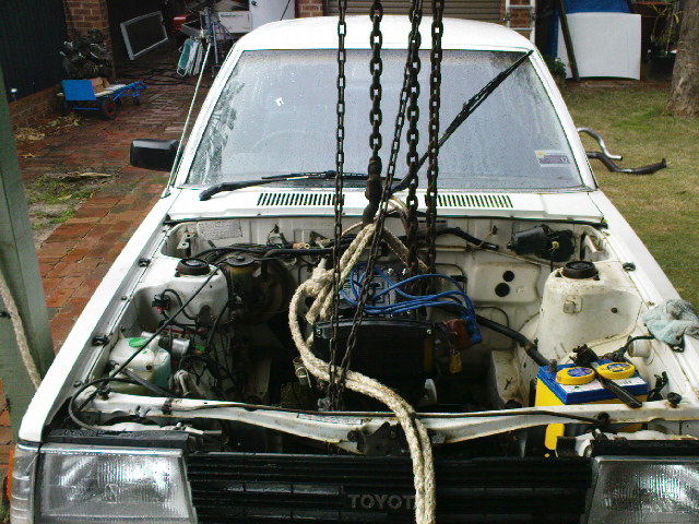

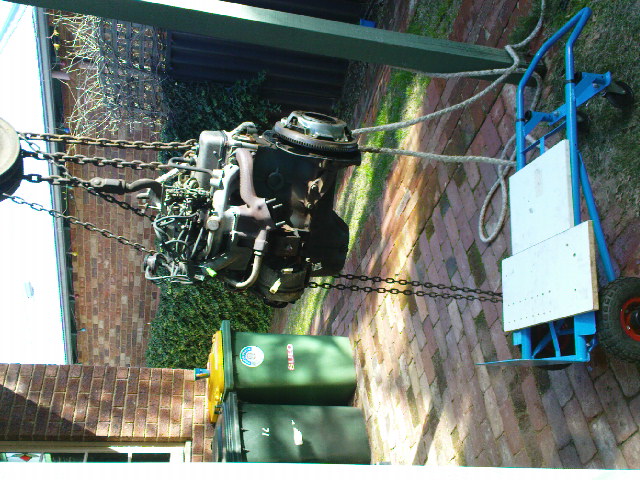

ENGINE IS IN :)
only done half of the conversion so far as its missing a few little bits the it needs to run, ie starter motor
Edited by kiahn
this stage took me from 9 am till 5 pm and i had about 2 hours off for eating and goofing round
here are a few pics in order of happening:

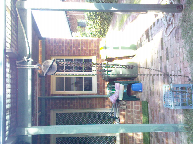

get block and tackle and attach to 20 yr old wooden veranda
get ke70 with shirry 4k

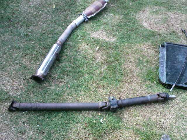

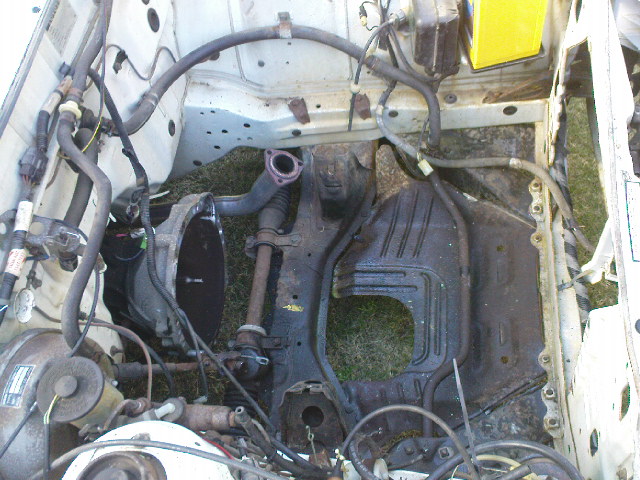

remove the bits that attach the engine to the chassis
pull that piece-o-crap out

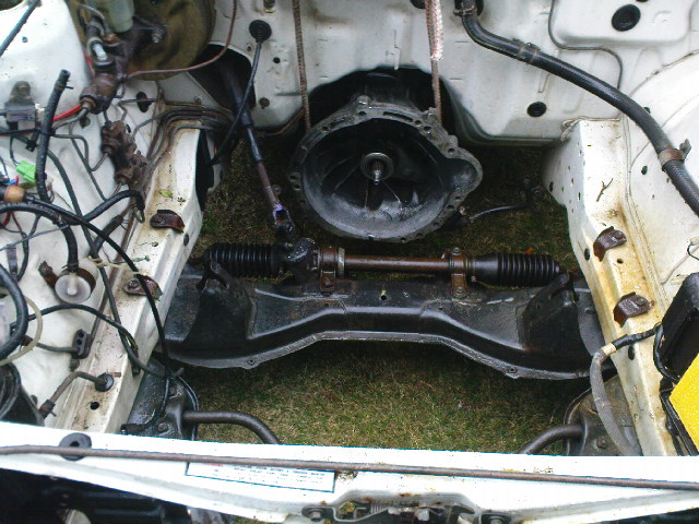

detach the old GB and tailshaft (don't forget the earth wires, their everywhere)
take the old tailshaft out
put new crossmember, tailshaft and GB in

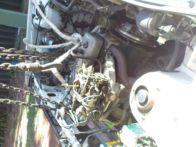

put new 4AGE in

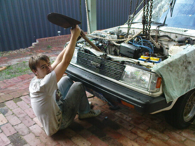

use a shovel to make the GB fit onto the engine
and now youve got your engine in
