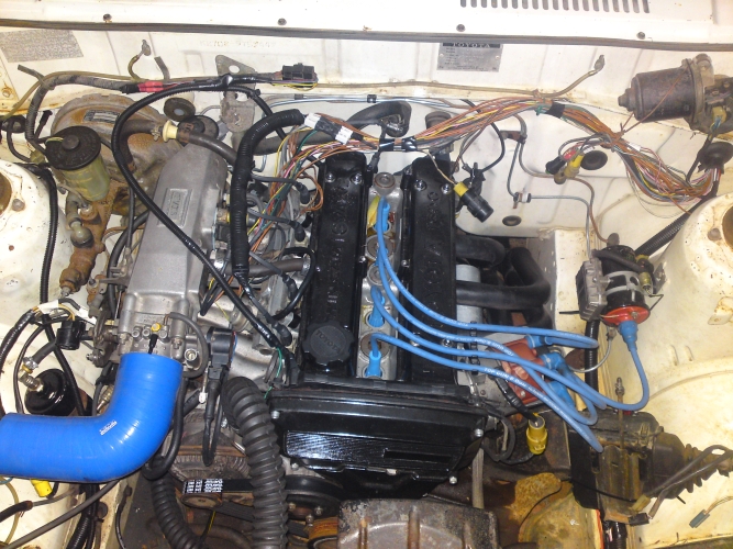

alright she runs now
had a guy over and he helped out by swapping parts over to test.
although its only running on 3 cylinders
ended up being the temp sender to the ECU on back of the head not working properly, once the engine is warm the ECU's pre-programmed map and runs and revs beautifully (keeping in mind only 3 cylinders are firing)
had a drive of her on "private" property, SO EFFING LOUD and feels like triple the power of my old 4K
  • Replies 79
alright all these problems were fixed today and NOW ITS RUNNING PERFECT, needs idle adjusted but apart from that its perfect, got enough power to slide out around corners :no2:
turned out it needed resistors for the injectors

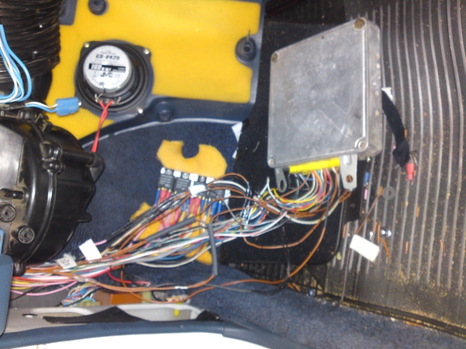

here is the engine bay as it stands now, put a few things in corregated tubing but the main wiring strip is stil open for any last minute changes

clean up wiring

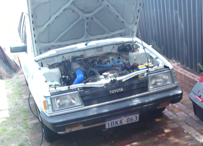

heres a pretty decent update:

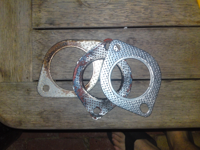

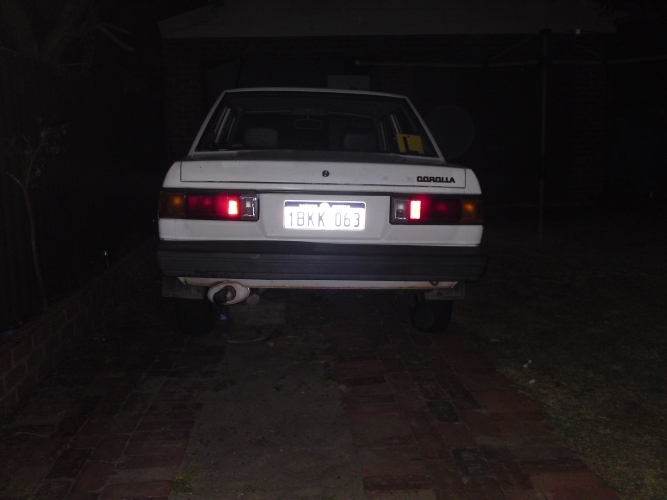

had to fit a super-cat dogleg muffler at the rear to remove the bark and managed to droped 30db, also put in 2 to remove about 3-5 db each.

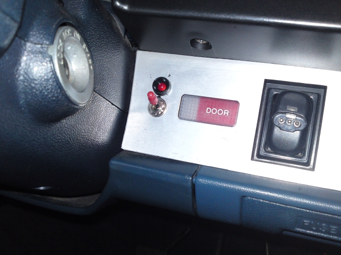

my thermo-fan overide switch with a bicolour led (green and red) to alert me if its on auto or manual:

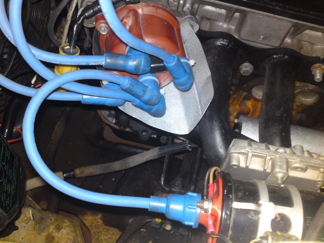

my heatshield i made for my dizzy:
