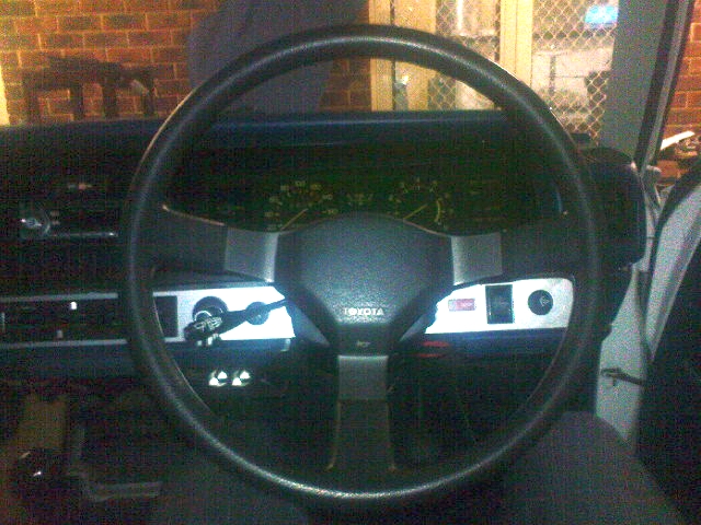

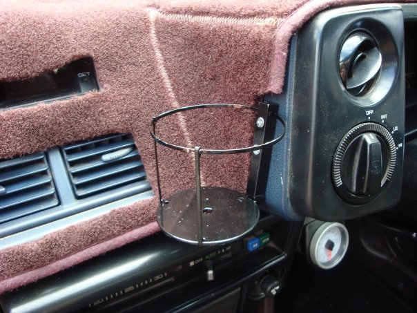

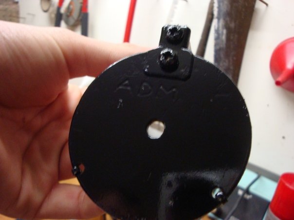

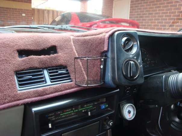

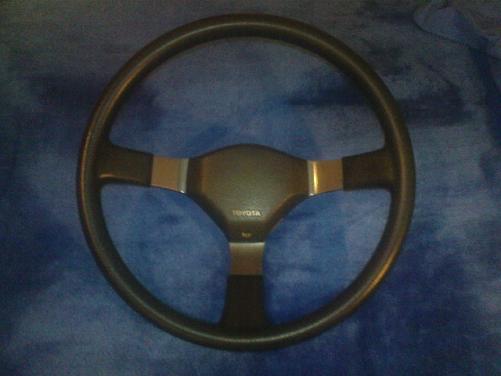

my friend shah gave me his old ae86 steering wheel because i made and installed an initial D style cup holder :)
also nabbing his spare ae86 stocko's

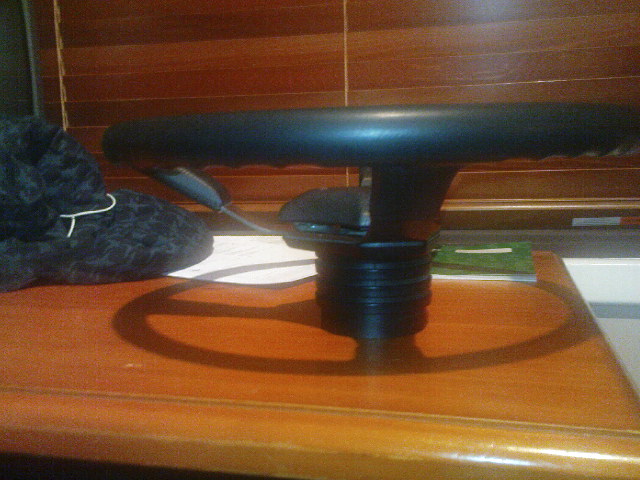

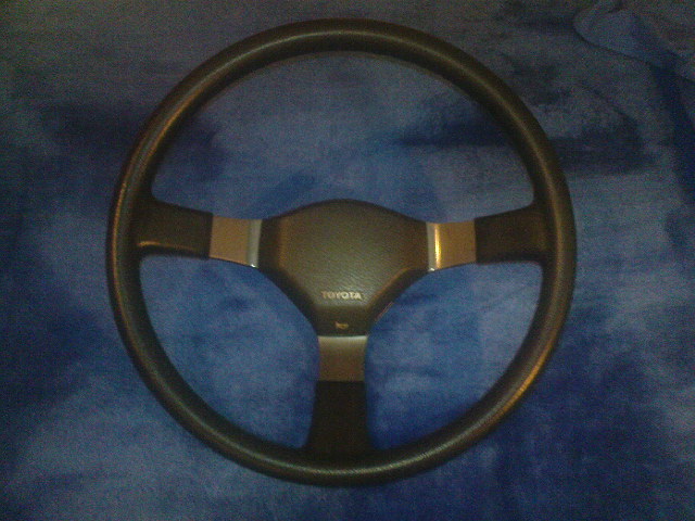

steering wheel is same as twincam one but it says toyota,
and heres the wheel:
oh the dish
3 spoke instead of the stupid 2 spoke POS ke70 one

well here is the wheel installed along with the tacho dash, cleaned it up and armour-all'ed it, then after it soaked in i washed it with warm soapy water to rid the excess armour all
