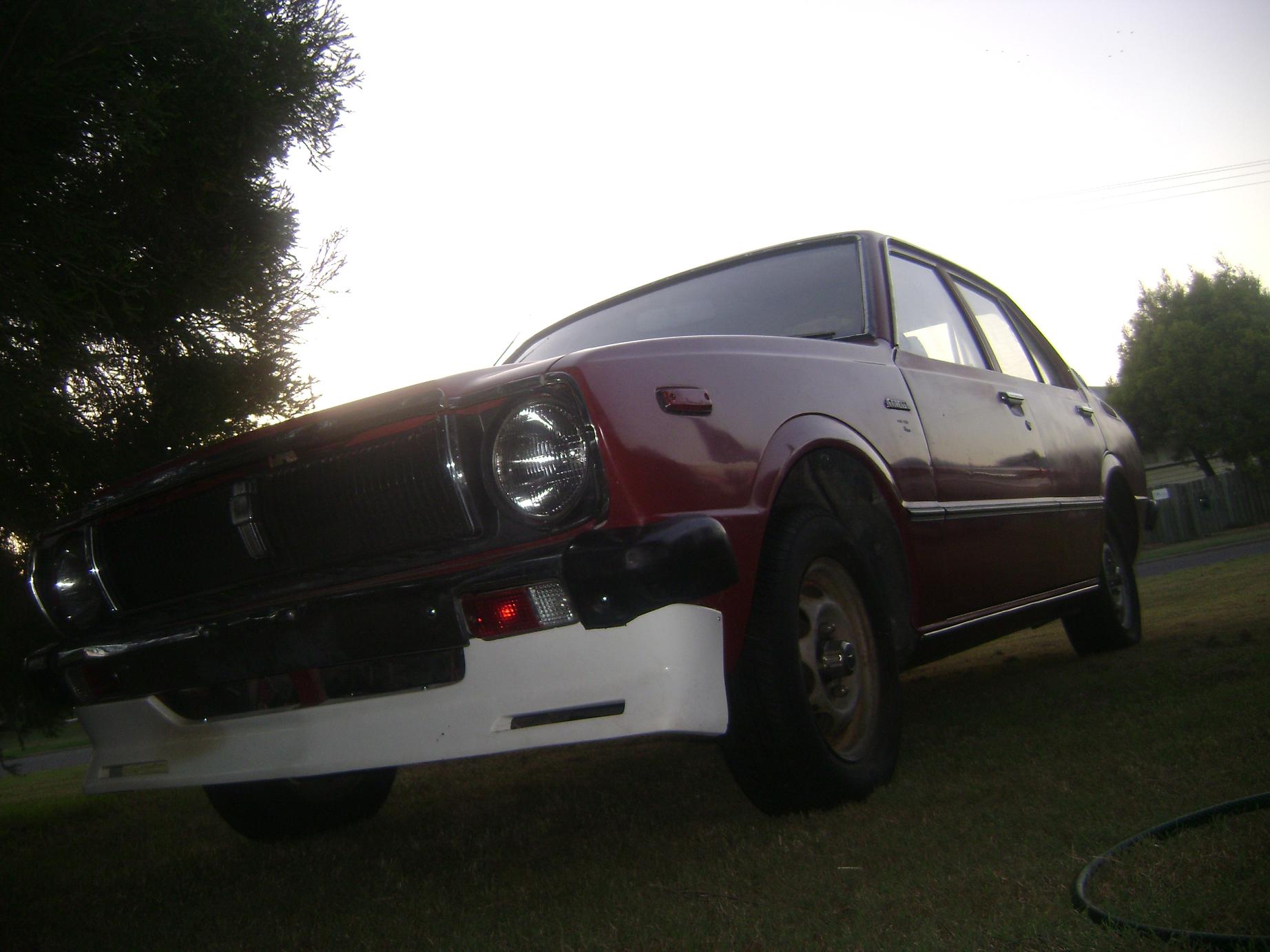

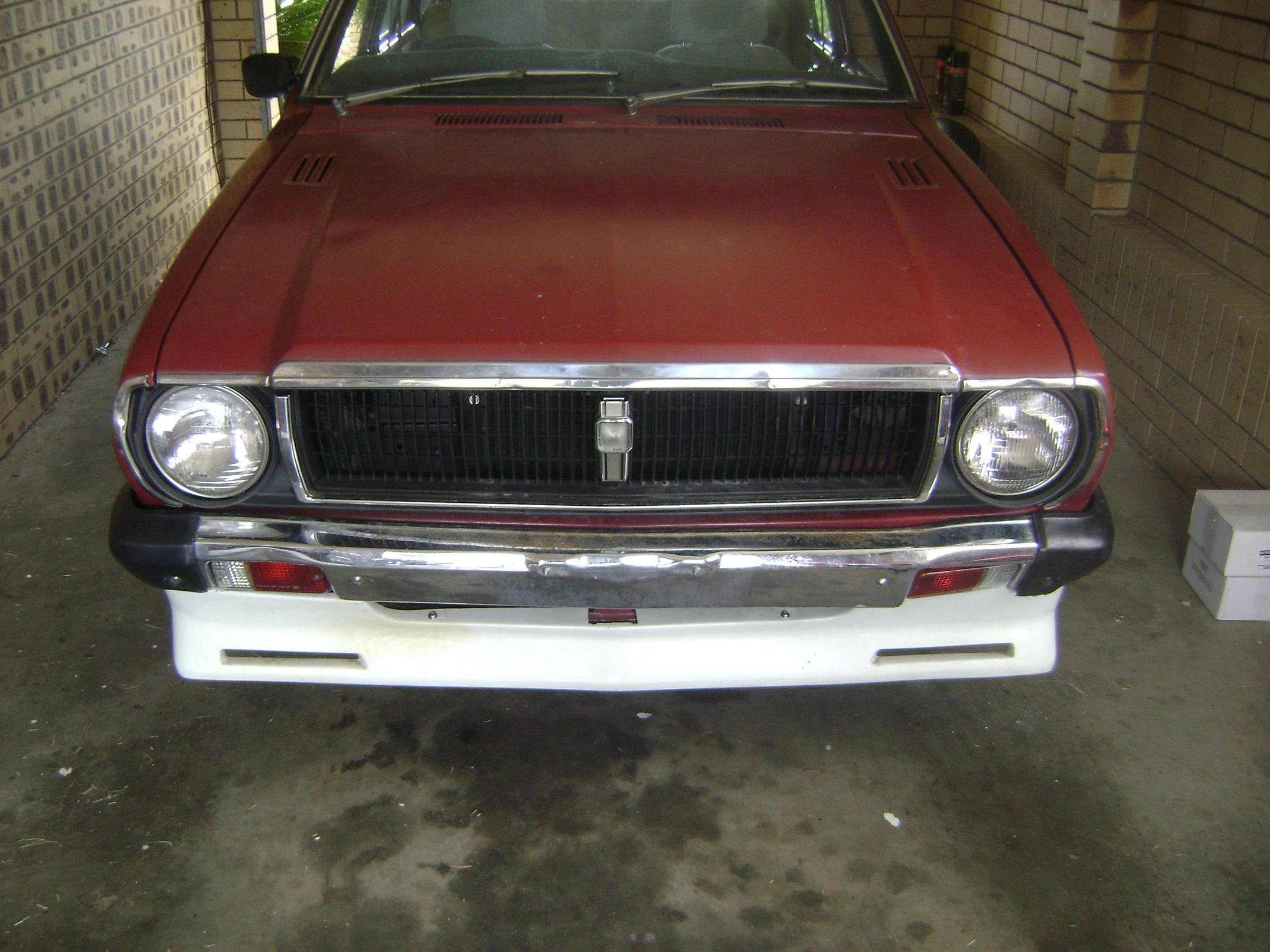

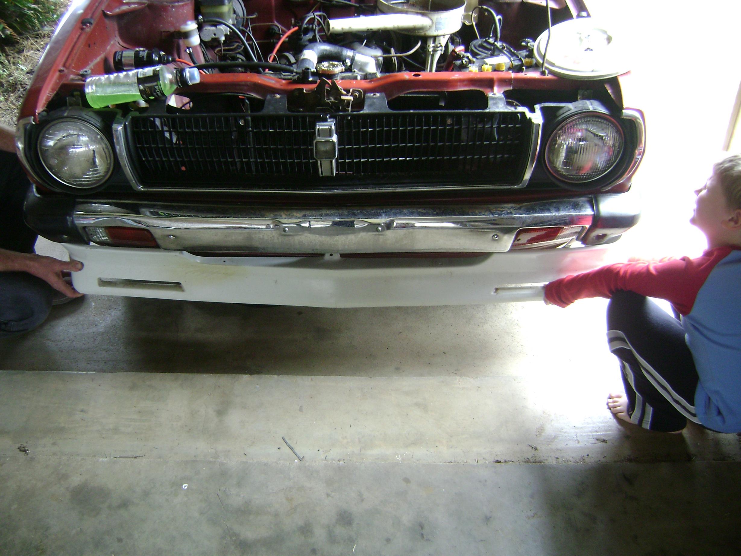

I fitted the front splitter. That was easier than I thought to make fit.

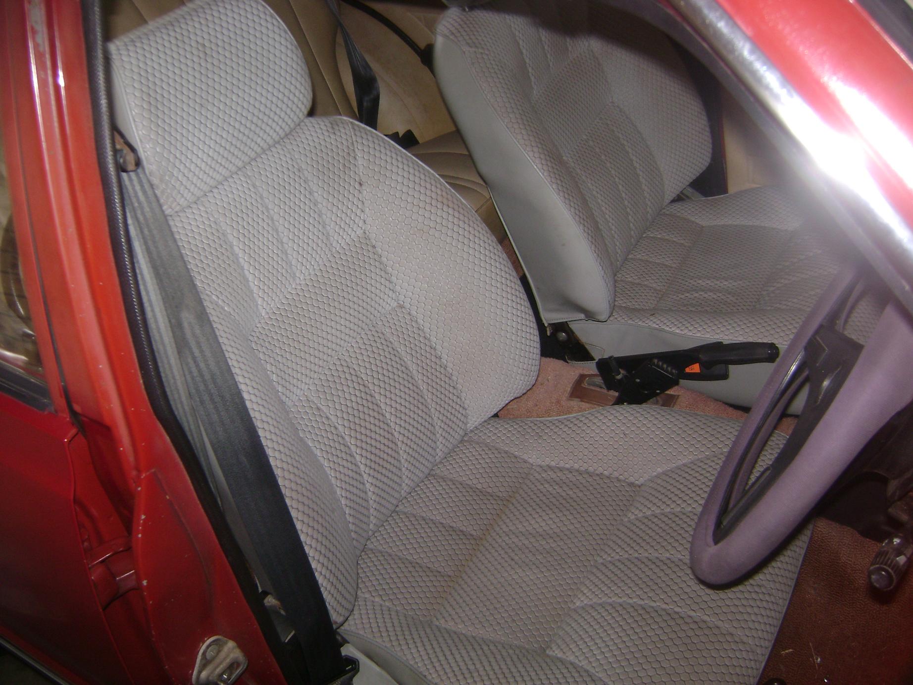

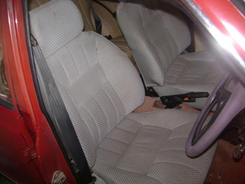

I changed my seats to Ke70XX ones for comfort. Just made the ke55 rails fit the 70 seats.

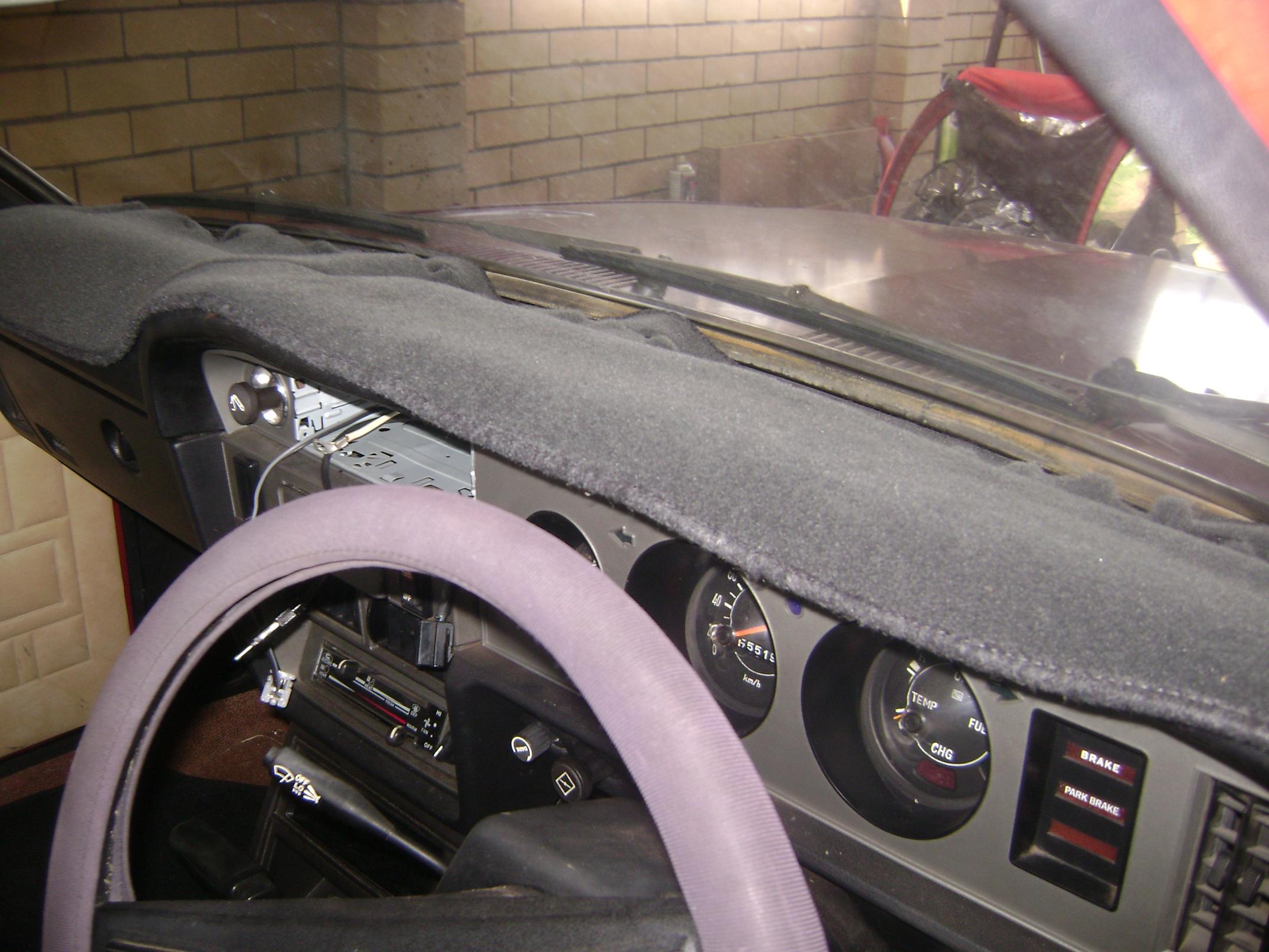

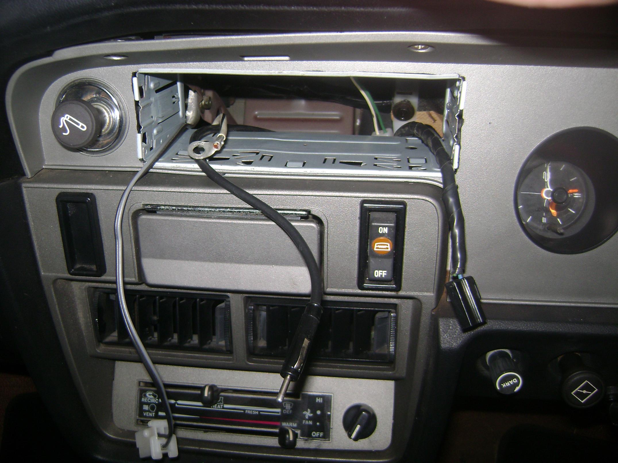

I cut a hole in my dash facia for the stereo (still to be fitted).I didnt want to cut the hole but meh.

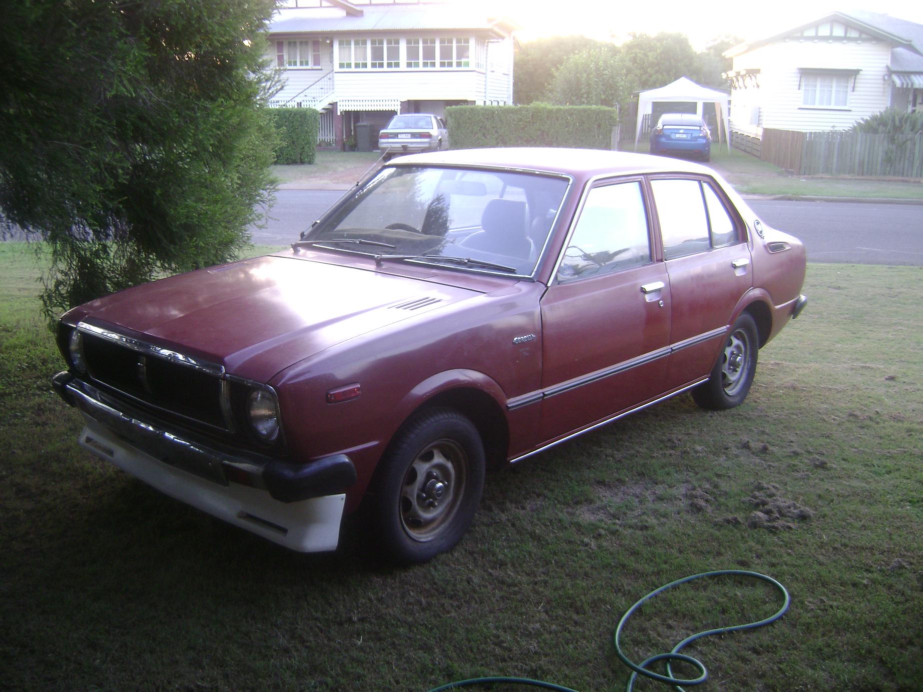

Here is some pics
I also fitted a dash mat not made for the car but covers up the rats#!t dash

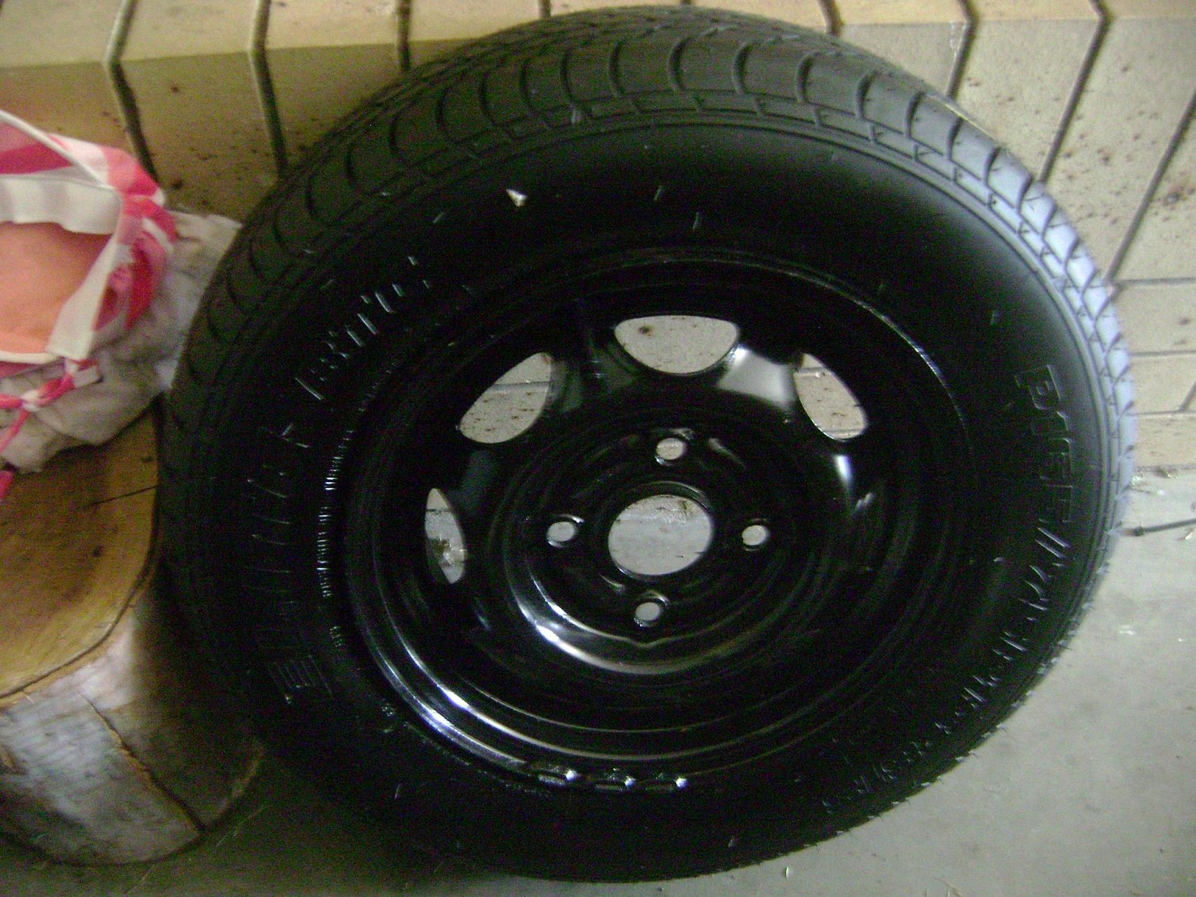

And that is the spare wheel that I have painted just gotta do the rest. See the brand new tyre. :y:

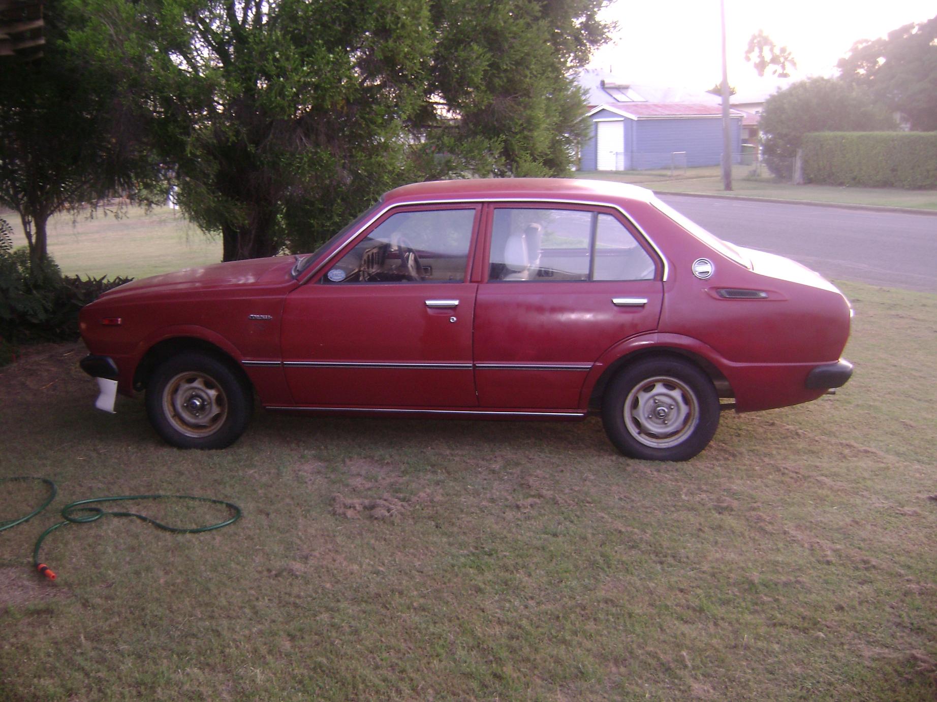

Here are the latest pics
I definetly need to paint the wheels :y:
and after rego SLAM IT on its arse.

progress is coming pretty good roladude i like the front splitter!
