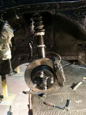

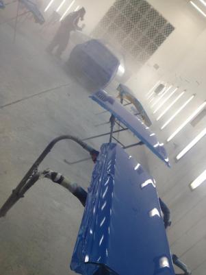

  5. Thanks matt there was sooo many hours in that bay! Could of been more but how far do you go. Love the wheel tubs and towers so smoooth 😊 Full credit to my man brad clark with his small buisness static customs panel and paint down here in tassie. Such a perfectionist Oh bugger i thought I put one up was in a rush will attatch one now.. yeah so much happier with intercooler hidden 😁 So the brakes are from my old set up which was ra40 struts with a ford 285mm disc with r32 4 pot caliper and all I done was put a weld in bc br gold coilover jn it with 8kg springs I also got a new knuckle ao I can get more lock 😉 ideally id like a different set up as the stub axel is really long and sticks outside the wheel and the cap can't cover it. But I spent to much to change.

  13. Hey after a better front steering strut steering set up? I have a celica set up at the moment with bigger disc and r32 caliper conversion on it and want to maintain that set up as it cost me fair bit so I've done some reasearch and can get a coil over set up where I can lathe the strut tube off the bottom nuckle piece and simply weld it in.. Just wondering if anyone else has heard of or done a good set up? Also had rear leaves redone flipped leaf and tramp leave added its really shit ride is there anything to soften this up? I'm all ears Any info would be greatly appreciated cheers johnnyt
