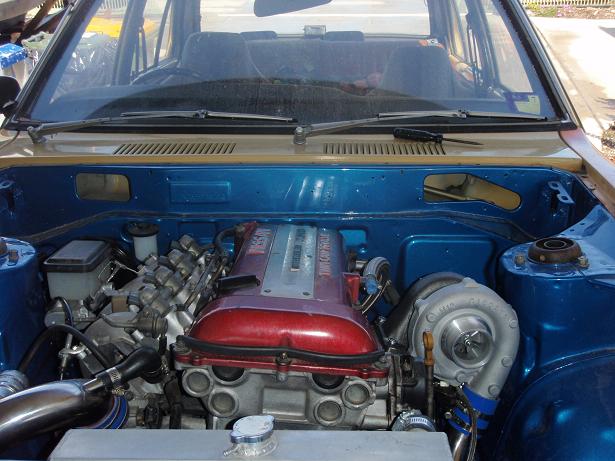

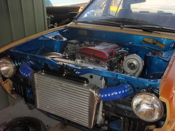

hey this is my build progress on my ke30 project UPDATED 7-12-2014 so many more pics of the new look on page 8 :)
Engine: forged and built SR20DET (s13)Turbo: Garret T3071r , HKS step 1 cams 256, rocker arm stoppers steam pipe top mount manifold,
custom radiator with thermo and custom intercooler all alloy piping, turbosmart external wastegate (plumbed back)
Fuel: (changing fuel pump soon) nismo 740cc injectors 8mm fuel lines
Computer: AEM
Exhaust: 2 1/2 inch pipe into highflow cat and into a highflow muffler with dump tip
Diff & rear brakes & suspension : Hilux LSD 4.11 ratio with 285mm el falcon disc set up. with s13 rear calipers
custom tailshaft, whiteline sway bar, monroe gas shocks ( will be changed)

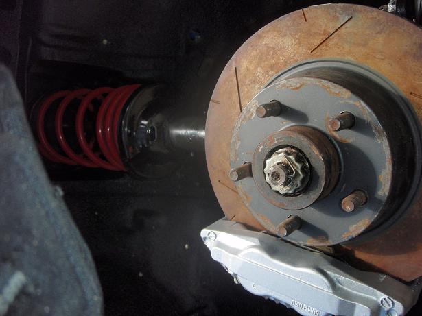

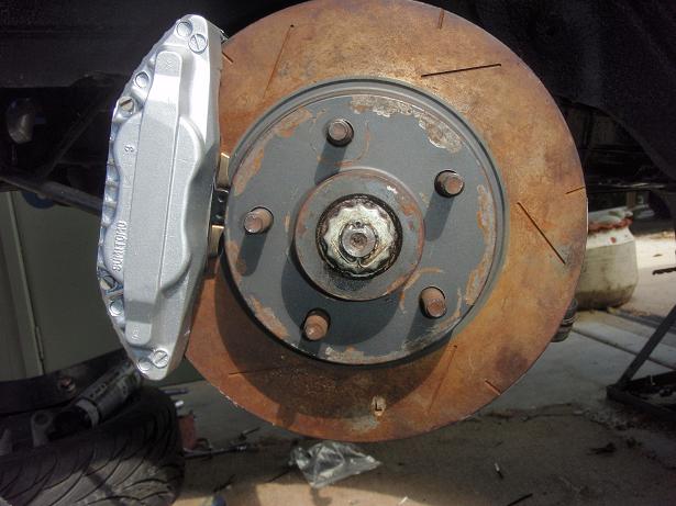

Front struts: s13 weld in bc br gold weld in coilovers with 285mm xd vented and slotted rotors with skyline r32 4pot calipers, ae86 aftermarket knuckles for more lock, whiteline sway bar
Wheels rota grid classic v's 15x8 -0
Dash: all speco gauges
interior s15 seats
Colour: Ford blueprint (BA)

more info on the front brakes would be handy!!!

Meaning how did ya go about putting those Disc's and Calipers on... any brackets ect had to be made? pics?
hey sorry i can't get any pics car is at the painters.ill get sum as soon as i can! i didnt actually do the struts ian weatherhead done them. i know there as a bracket that supports the caliper ill have to get pics to discribe exactly how.
