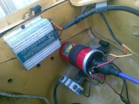

January 6, 200917 yr Author comment_304780 ok this pic i will show is my electronic dizzy its on my 3k now it was originaly off a 4k i found at the wreckers will it fit my 5k??? and will my 3k water pump fit the 5k??? cheers shaun.. Edited January 6, 200917 yr by shauns ke30 Report
January 6, 200917 yr comment_305150 Yes just swap the dizzy, water pump and alternator over to the 5k. Just pull the dizzy out befor removing the motor and sit it on the guard. Just make sure its not 180o out when re-fitting. Report

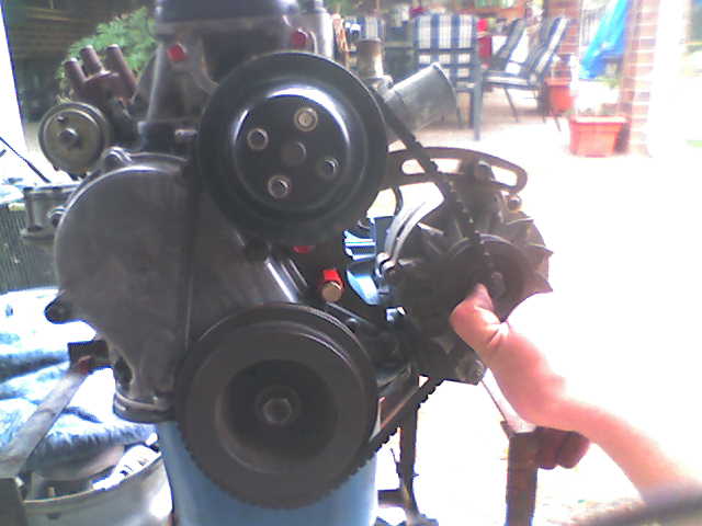

January 7, 200917 yr comment_305258 Actually that rings a bell - I have had issues with my water pump. I got a brand new one for free, but neither my 3k or my 5k pulleys fit correctly. They both have differing PCD's from the pump and the centre hole on the 3K one was too small for the pulley boss. Report

January 7, 200917 yr comment_305356 I have a brand new pump with a small PCD (smaller than the 3k one) but a larger centre pin, although not as large as the 5k one. Anyone know what it's off? Report
January 8, 200917 yr comment_305758 See pic attached. I'm sure its the same as the one on the 3K. Report
January 8, 200917 yr comment_305779 :P Thought you might have a ke70 one as they're a bit different, but its not! That must be a really early one maybe!? Report
January 8, 200917 yr comment_305784 You know what you might be right.... I reckon the box might have had KE10 written on it. Damn that means the only fan likely to fit is probably the well and truly defunkt 2 blader..... Might just get the round file out.... Report

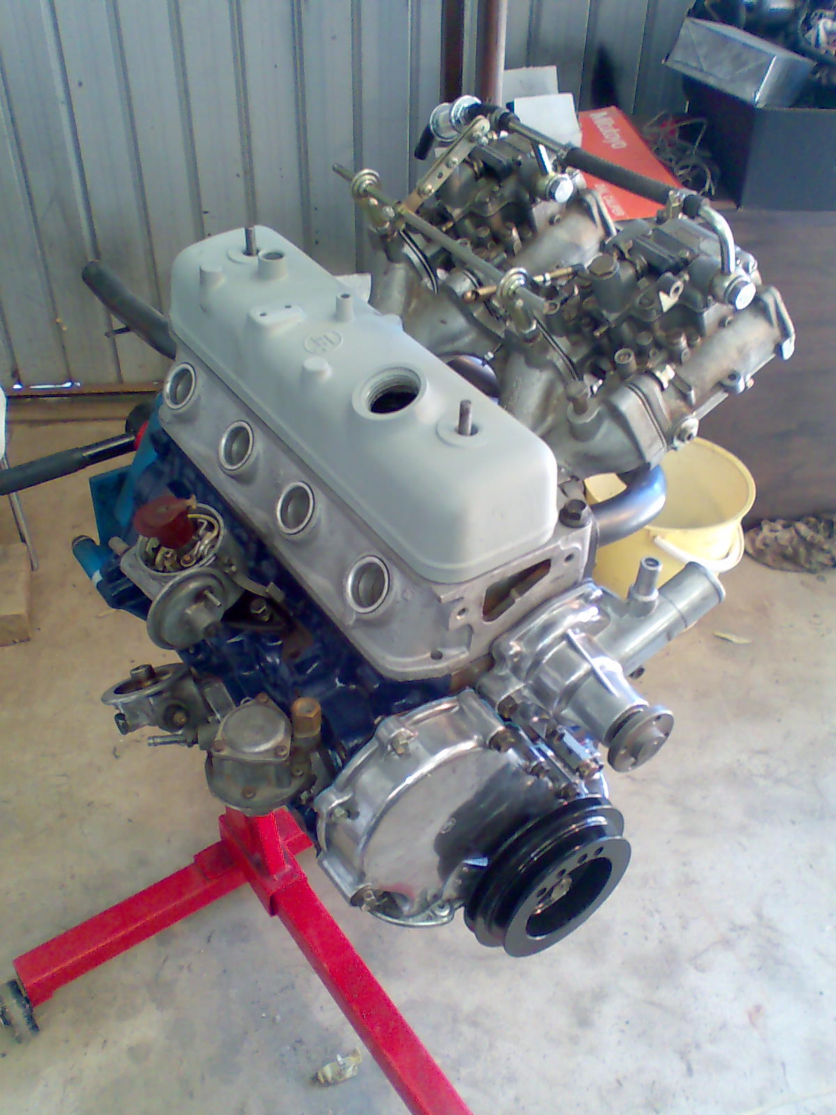

January 8, 200917 yr comment_305886 Hi, Your water pump above might be assembled wrong.. I say this as I got a Toyota book shows how to reco a pump and the front boss is removable and in different models is pushed on further etc to get belts aligned. So possibly some one did this and put the boss on backwards so it is huge at the front. But highly unlikely. But A KE1X water pump is REALLY short and stubby. So compare it to others if the shaft is shorter than them it is KE1X. Also I have 2 KE1X pullies here 1 has a big hole like that one other has a noraml small hole and I belive there are 2 part numbers for KE1X pumps so you most likely have a KE1X pump. Also metal fan I got one and it will fit a small shaft pump or the large I tried it. But if you want run a thermo and then you don't need to worry about finding a fan. Cheers Cameron P.S. found this pic quickly. KE1X water pump on my 5K has a small shaft. KE15 isnt at my place atm so can't go get a better newer pic but here goes. Report
January 8, 200917 yr comment_305973 It could be on backwards, thats an interesting point. That would change the offset of the pulley though so I don't think that's the case. Wasn't going to run a thermo, had a nice plastic blade fan and just scored a shrouded KE20 rad that I was going to fit in. Might be time to whack in a thermo.... Report
January 8, 200917 yr comment_306020 Just tuck a thermo into the '20 fan shroud. :P You can actually sometimes feel the increase in power (from reduction of mechanical load) from removing an engine fan and fitting a thermo. I know I did in my mazda anyway. When the thermo switches on there is then more electrical load on the alternator, but thats pretty much only in town when you can't use much power anyway. Report
