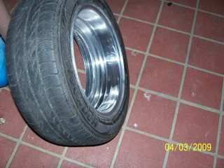

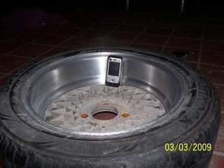

mungi mods Posted March 3, 2009 Author Report Posted March 3, 2009 (edited) meshies... were 15 x 6.5 +13 purchased from Roo.... thanks!!! now fully reversed and in the process of being polished to MIRROR finish stage 1 only complete "not yet polished" only sanded so far with 40 to 600 grit max dish will be splitting these and making them 8.5 or 9 inch wide with "new" Inner sections sandblasting and painting centres .....maybe bright white should have my ssr's back from having a ding straightened by Friday .. mount wheels on Saturday to see how wide i need to go Edited March 3, 2009 by mungi mods Quote

mungi mods Posted March 3, 2009 Author Report Posted March 3, 2009 Who do you see or how do you widen wheels. :D I want to widen some wheels. :| buy 3 piece rims( ssr volk most good japansneezy rims ) split them and buy wider sections to replace the narrower section ...hey presto wide rims with wicked offset at a vastly reduced price i had a pair of factory 15 x 9.5 -12 SSR mesh rims which i sold for $1200 without tyres these will be vastly cheaper... Quote

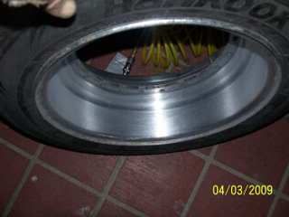

mungi mods Posted March 4, 2009 Author Report Posted March 4, 2009 (edited) to to getting there centres will be back from powdercoating tomorrow and fitted up more pics then Edited March 4, 2009 by mungi mods Quote
LittleRedSpirit Posted March 4, 2009 Report Posted March 4, 2009 getting there centres will be back from powdercoating tomorrow and fitted up more pics then Looking real nice, mate. You work fast. Who does your powdercoating? Quote
mungi mods Posted March 4, 2009 Author Report Posted March 4, 2009 Looking real nice, mate. You work fast. Who does your powdercoating? 2 hrs work from f@$ked to gleaming...still not quite there my polishing wheel decided it didn't want to play so they aren't actually" polished "yet just with a cutting compund ..that said still can see yourself in then reflection :| lavarack at eagle farm dropped off today collect tomorrow :D need to bolt em on so i can get an idea of flareage then they will be back apart and frankenstiened into a 8.5 or a 9 or maybe even a 9.5 this will give me the outward offset for clearances etc.... there plenty of room inboard for more rim n tyre... waiting for the mk 2 's ...took them to a guy in slacks creek .....seems pretty switched on.$120 a rim perfectly straight will let you know when i get em back as to quality for future reference Quote
