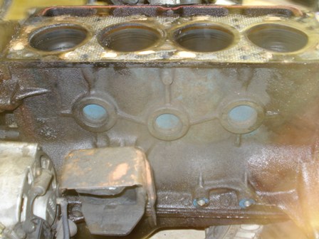

hey lads I'm doing up my 4k and i need to find out which of the blocks in the "How to build a tough k motor" forum, and ive got this paragraph from it>
There are also two different types of 4K block, one has three very noticeable ribs below the manifold side welsch plugs, just like a 3K if you can have a look at one. The other has small ribs and a large flat area. The unribbed block is far weaker, if you have one of them, scrap it.
any ways before i go further can anyone tell me that if my block is this ribbed stronger block or not???
From the sounds/looks of it you don't have the stronger 4k motor.
As the ribs are supposed to be 'below' the welsh plugs and yours aint got none by the looks of it.

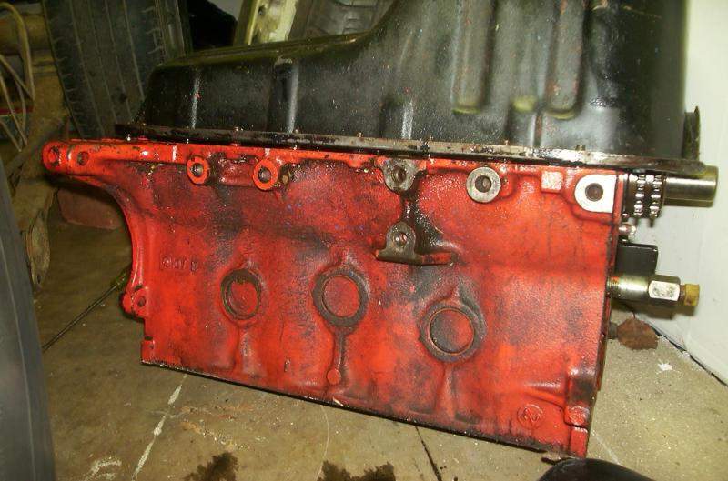

I don't get it...
Where's the ribs on springersrolla's block??
the ribs are between the 3 welsh plugs and above them on springers block, the raised part of the casting.
I don't get it...
look at the two blocks side by side, one has ribs running from the welsh plugs up to the deck, the other has those ribs, plus ribs between the welsh plugs...
ahh ok I think I see it now, but in the faq it said that the ribs are "below the manifold side welsch plugs" but I guess who ever wrote that meant below the manifold but above the welsch plugs??
checked and found both my cars have the ribbed engines... yay
