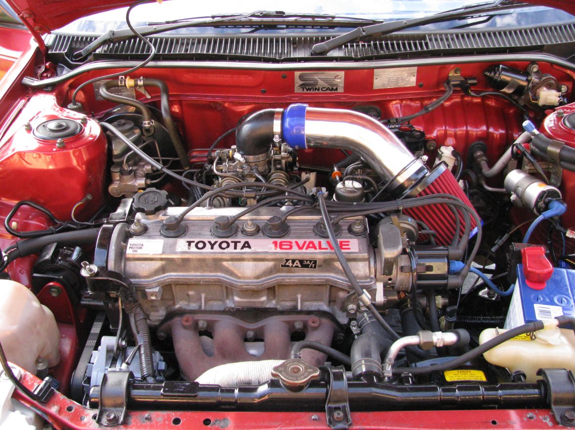

What steps did you go through to install yours?
Steps were:
1) Rip off all the stock intake.
2) Plug up the Air Suction Valve hole in the head (pipe from the exhaust manifold to the air cleaner).
3) Buy these bits:
1 * 63mm 90degree rubber elbow (attaches to the carb nicely)
1 * 63-75mm (2 1/2" to 3") silicon adaptor - Calibre brand.
1 * Calibre 3" pipe (don't know much more than that)
1 * SCA Pod Filter
1 * Rocker cover breather (not shown in pic) FYI - cut piece of the existing vac hose and mount the breather over the top as they usually have a bigger diameter.
Hose clamps.
Fit it all. I just strapped the piping to the fuel filter until I come up with a proper bracket. Sounds sweeeeet!
You could do it with top $ parts and I'm sure it'll be better than this. I spent less than a K&N filter alone :-)
Yes, it's a HAI (hot air intake) but was only meant to be temporary until a weber fits into the budget. Redline auto just sent me this FYI (specifically for 4AFC) -
22680-005 32-36 dgv weber $599.68 inc gst
10-112 adaptor $51.61 inc gst
16-42 air filter $52.25 inc gst
42-21 basic linkage kit $43.77 inc gst

I want that site damn it :P

Steps were:
3) Buy these bits:
1 * SCA Pod Filter
Hose clamps.
Thanks mate :hmm:. Do you rekon you could get a video of the sound it makes?
By the way what did you use to plug up the Air Suction Valve hole?
599 is pretty high for a 32/36 style webber but I'm sure that cost would include warrenty and reconditioned/new
could pick up one on the forsale section from $50 and get it rekitted for 150-180 ish.

with that HAI how did you go about the other immisions thing that goes from the left side of the carb (standing at the front of the car) because when I ran mine without that on it sounded like a old VW also with the vaccume hose that has to be blocked off you can just use a M8 bolt or something that fits in the hose sung.
