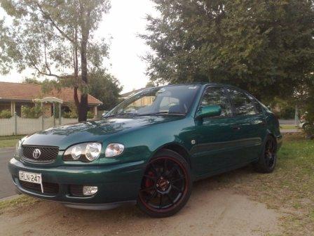

hey I'm new here.

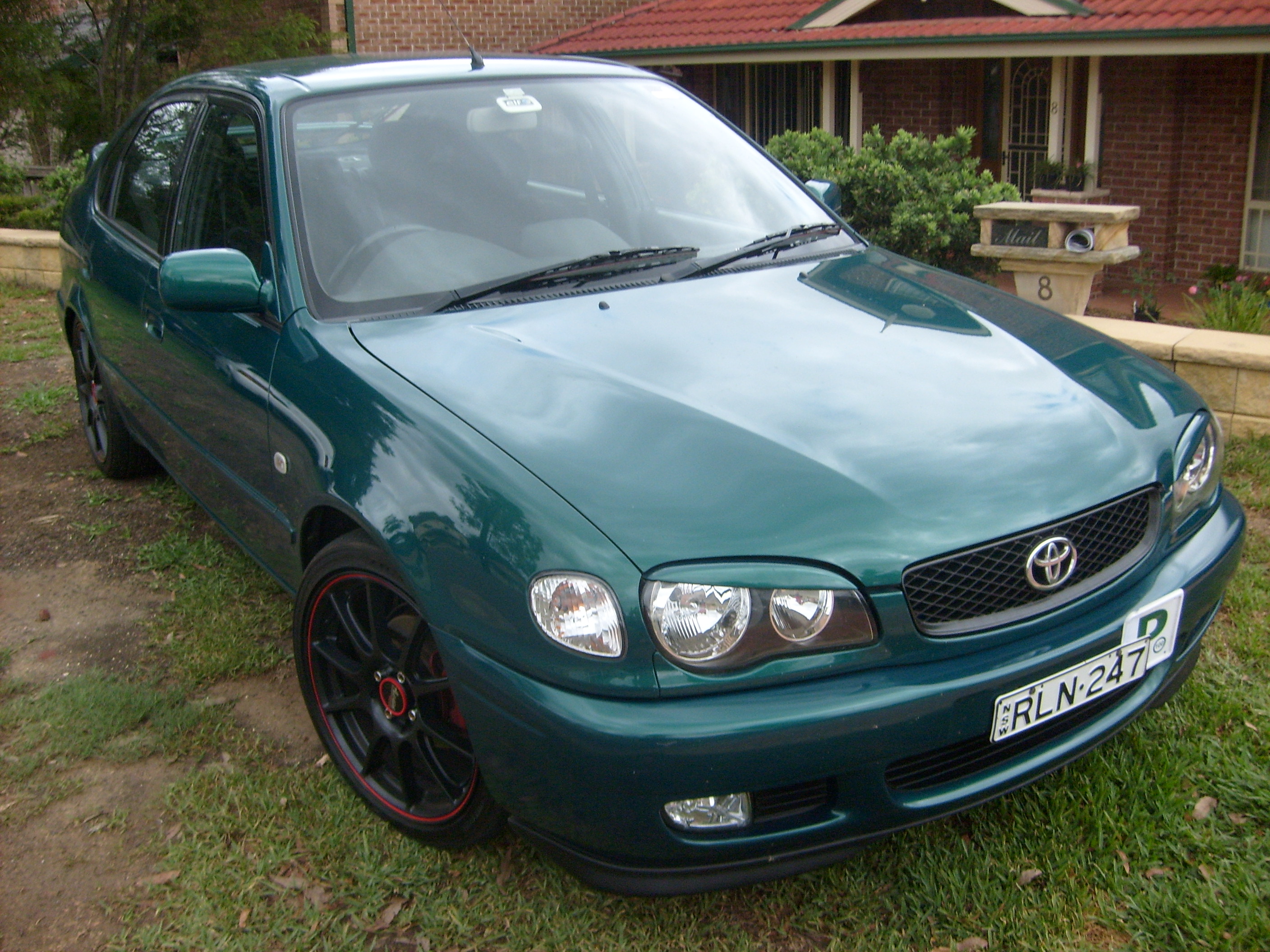

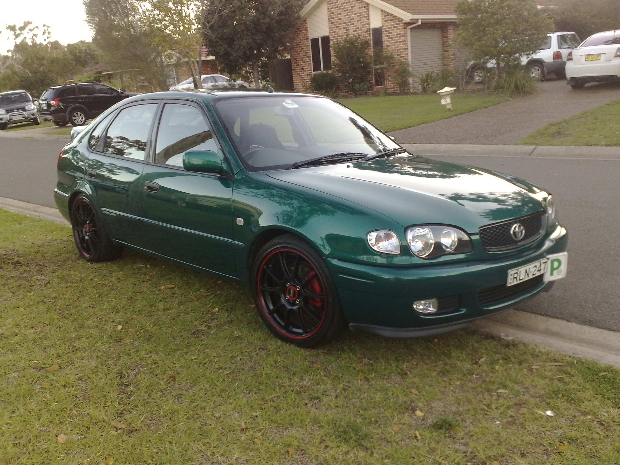

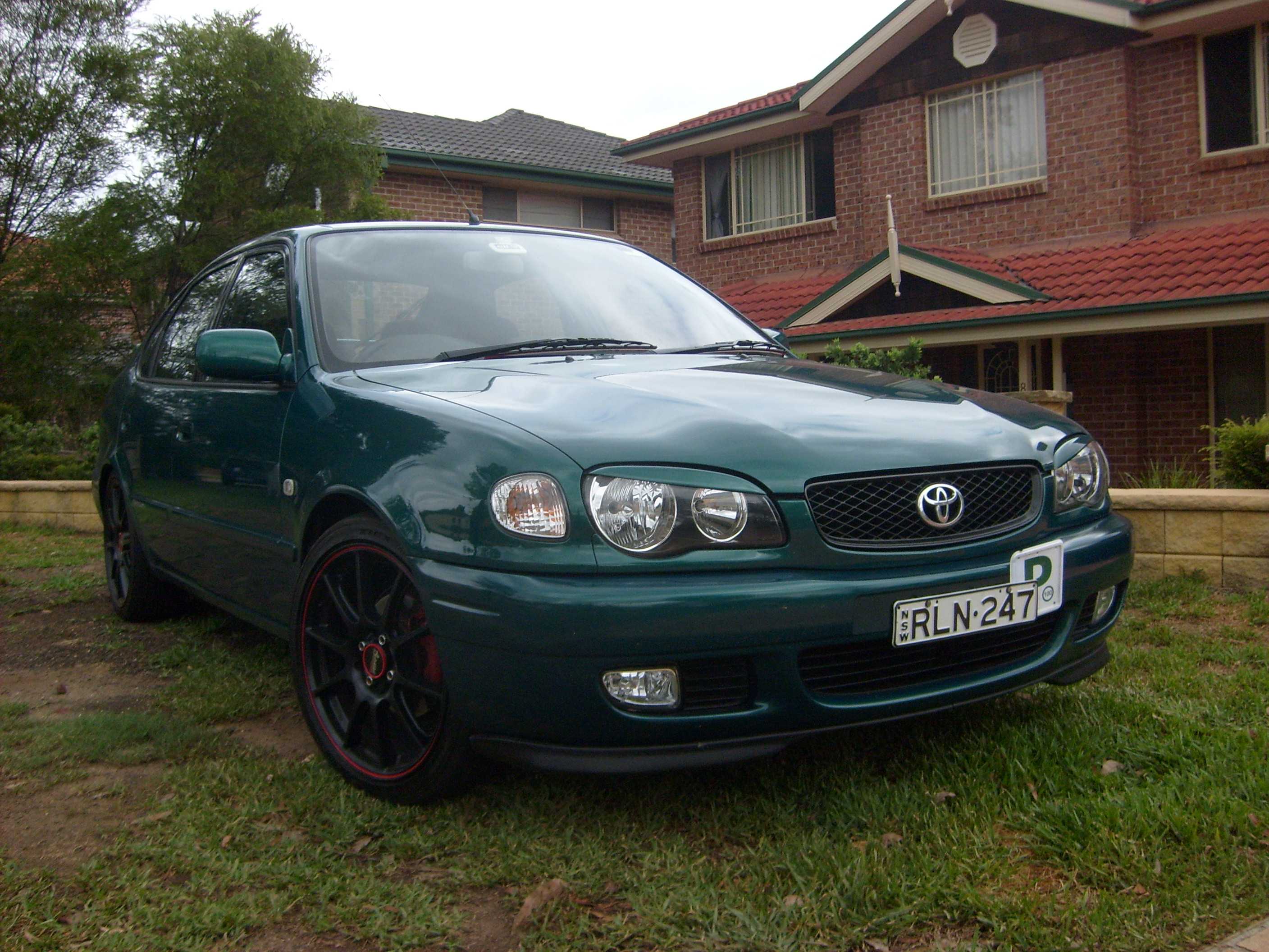

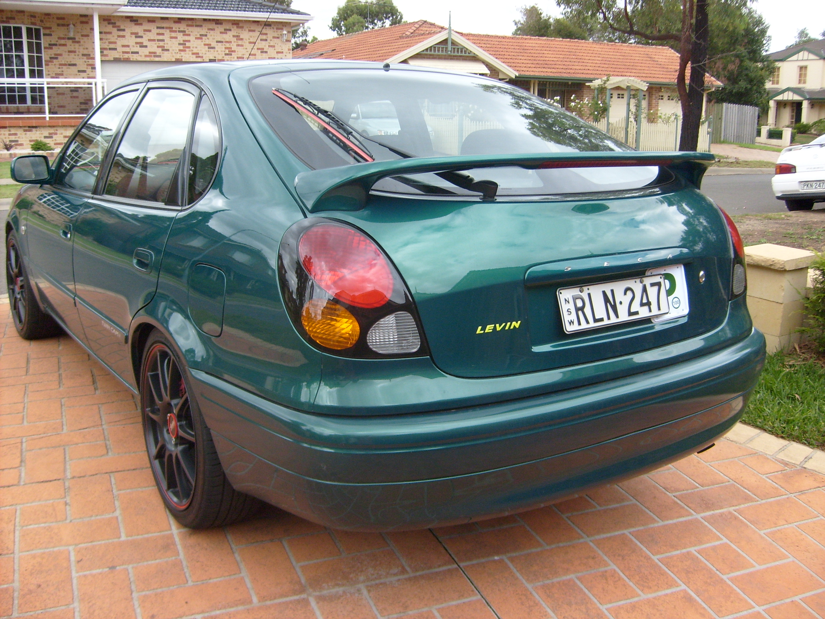

I own a green AE112 corolla levin i got stock about six months ago. i swapped my dad my ae112 ascent for it :wink:
first thing that had to be done to it was a stereo, kenwood double din tv/dvd headunit, fusion 6" splits, fusion 6 1/2" 3 ways in the parcel tray, fusion 4channel 900watt amp, fusion 12" powerplant 1300watt sub, fusion 1000watt monoblock amp. the stereo cranks its good for close to 130db..
more recent mods 2 1/4" cat back exhaust, 17"by7" advanti mazeR wheels and super low king spring..
I'm looking at doin a head conversion so ill be running a 7age is there anywhere in sydney that builds 7age's ??
hey nice rolla bit newer then most of the cars on here but welcome just the same really like the rims good choice

nice ride mate, love the colour!
keep the updates coming.

i havent been on here in a while got a couple new mods, extractors and metal cat, eye lids, painted tail lights and colour coded the door handles.
Hey, Great colour!
Good to see a couple more AE112 rolla heads popping up :jamie:
I belive the 7age engine is an awesome idea, just make sure you do everything right the first time and if i were in your shoes (which I'm not too far off :D) id go ahead with a silver top 20 Valve head as opposed to the 16valver, just my 2 cents.

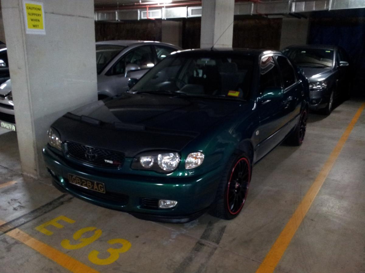

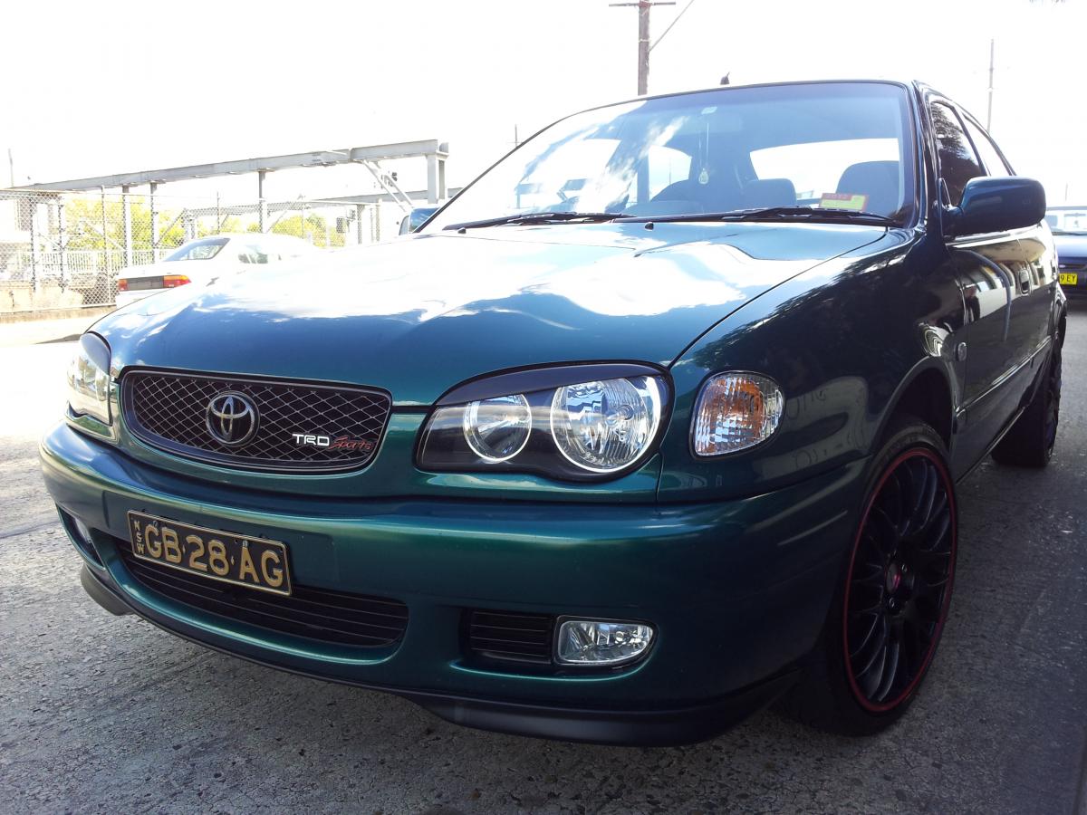

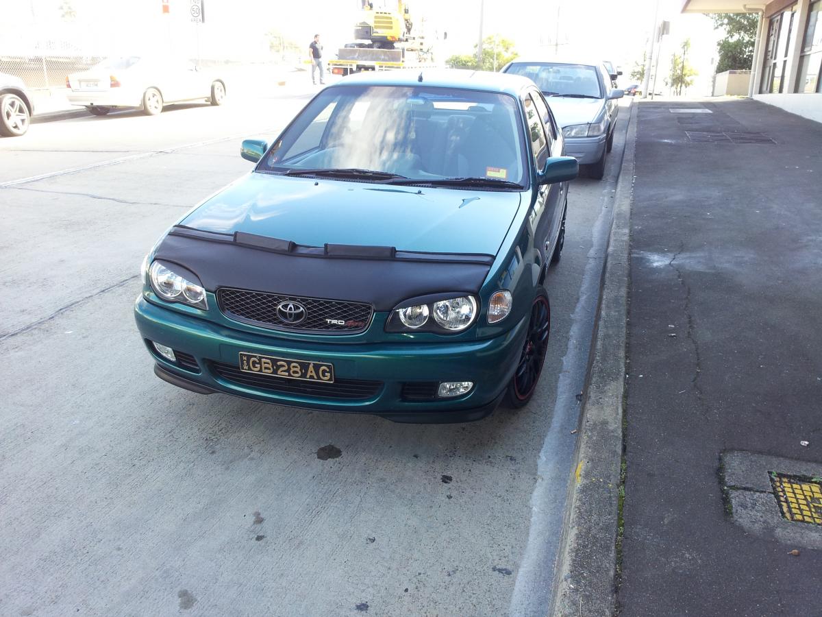

I liked this car, so I copied it.. Have a look
