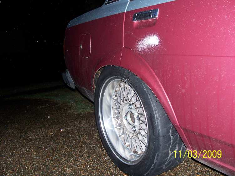

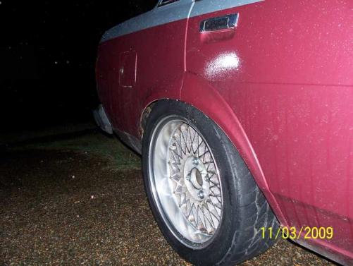

dbr11k Posted May 8, 2009 Report Share Posted May 8, 2009 i know you all hate my car. and the rims i have one it .. but they fitted very nice and honestly did NOT scrub at all although i am also interested and would like to know of any 17s that will fit nice on an ae / ke .. something similar to those white ones on the ke70 Quote Link to comment Share on other sites More sharing options...

dbr11k Posted May 8, 2009 Report Share Posted May 8, 2009 (edited) yeah its just a stick on dressing you can get it from most panel shops and thanks for the kind words .. i hunted down a set of 17s for my car.. just a quick question, what offset should i get for front and back at 17x 7.5 Edited May 10, 2009 by dbr11k Quote Link to comment Share on other sites More sharing options...
