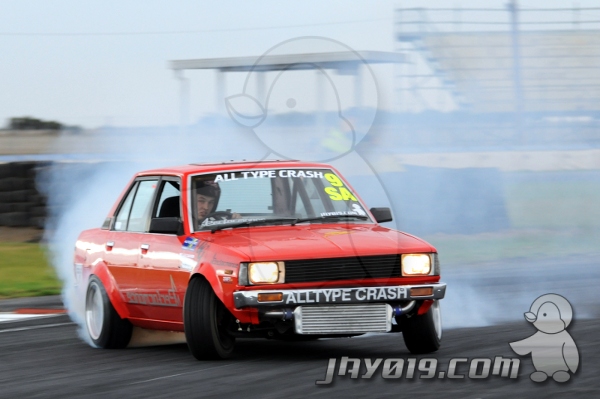

You only need to see this pic to notice the potential hotness of a KE70
cool, 4age makes for a really nicely balanced car!
