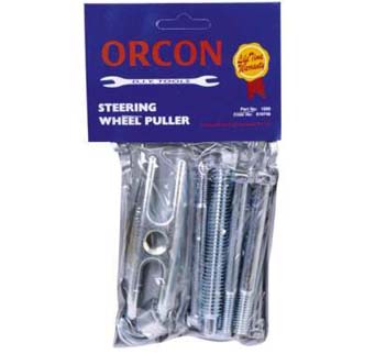

i used the above as hiro stated with one difference, i used a steering wheel puller. its a hell of alot easier and safer and they are all that expensive, and you can usually get one from most parts stores ;)
and look like this

Ok - had to use the steernig wheel puller. Got it off fine :sob:
