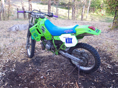

reCOUPErator Posted May 22, 2005 Report Share Posted May 22, 2005 hey, never mind the cam, is that your KDX200 (200?) on the right hand side! looks nice from the pic! i have one except mine is a crappy steel tank one! (Sorry bout this not being related to rolla's) Quote Link to comment Share on other sites More sharing options...
Super Jamie Posted May 22, 2005 Report Share Posted May 22, 2005 rice bike radar :thumbsup: i still can't tell it's the same thing as in the picture! Quote Link to comment Share on other sites More sharing options...
