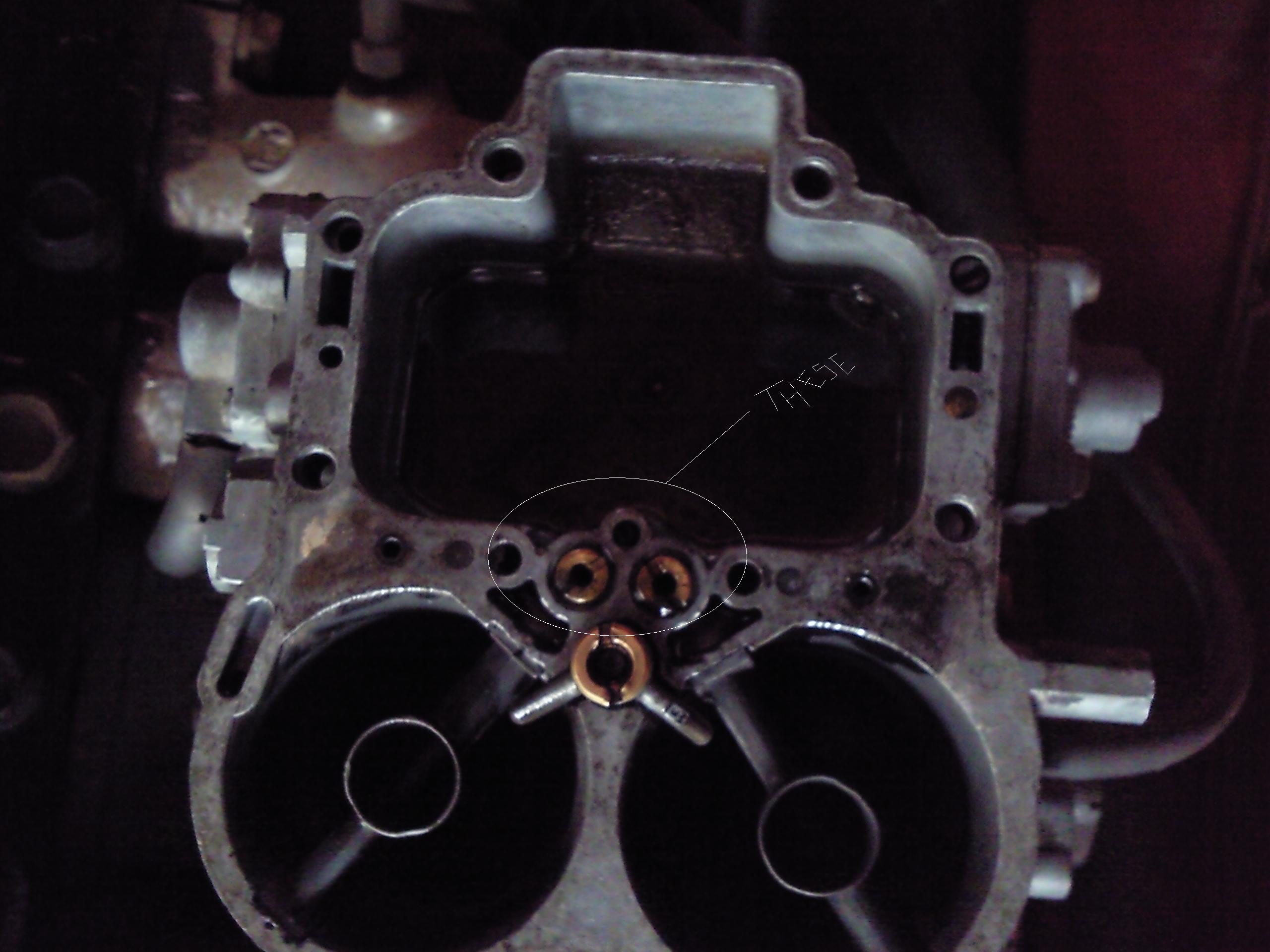

That's from the faq, so sounds like i'm running too lean?, this means i'm not getting enough fuel or not getting enough air.....just from gut feelign, it feels like I'm getting too much fuel, where abouts are the screws to change the mix, i've got a photo with the top taken off, are the two golden screw things what you have to adjust, or are these the jets which you replace in order to "downjet" for a 4k engine, if so would i be able to order these from a shop like sprint.
Edited by ke71-rolla
The 2 jets you have circled are the air correctors. They trim the mixtures in the higher rpm of the main and secondary circuits.
The main jets are in the bottom of the float bowl.
I'd remove each jet at a time and write down the number on it. Then find a baseline jetting chart to compare and work from there.
Good site for DGV carb info, to help you identify the jets

Took the carburetor down to a carby shop today, turns out its an oldschool carby for a small 6 cyl car, no wonder why i had a heck of a time trying to get it running!, time to keep a look out for a 32 36 webber carb off of an escort i spose..
Ideally, I would actually be looking for a 28/32, as they are probably a better starting point for a K engine
Look for these on Fiat 128s and maybe some of the Fiat 124s (I think the earlier model 1600cc). I paid $100 for mine, overhauled it and got a suitable manifold with adaptor plate off ebay for $40.

I'm curious, what is the model code on your weber? It should be stamped on the carby base. Also what size are the venturis (should be numbers cast on them)?
If it is actually a 32/32 that you have, a 32/36 is going to be bigger and less suited to a 4k. Is your 4k stock, does it have extractors, exhaust etc. ?
