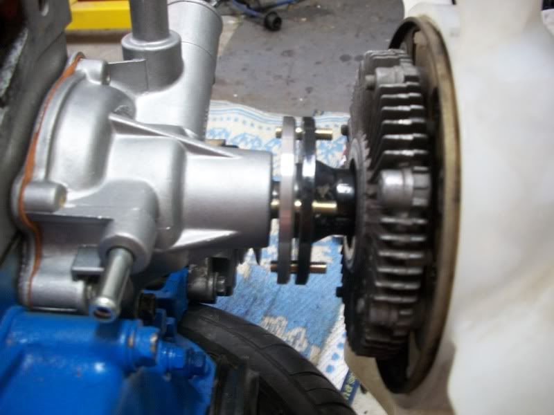

anastasios Posted November 1, 2009 Author Report Posted November 1, 2009 hey guys do you think this gap between my fan and my water pump is bad, as the shaft hits the inside bit? I should be able to tighten it up with some nuts but there is that 1mm or so gap Quote
Felix Posted November 1, 2009 Report Posted November 1, 2009 Still have a gap when you fit the belt pulley? Quote
