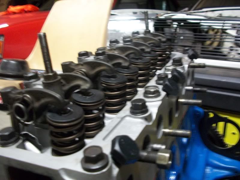

November 4, 200916 yr Author comment_388338 Hm I think I might just put it all together, would excessive valvetrain noise happen if the preload isnt enough? heres a pic, you can see that the first few rocker arms arent touching by a couple mm when i push them onto the pushrods, it seems too much, the oil lifters can't prime that much can they? Edited November 4, 200916 yr by anastasios Report
November 4, 200916 yr comment_388376 it seems too much, the oil lifters can't prime that much can they? Doesn't look good at all. Think it is time for a full rethink of your valvetrain/lifter setup. Report
November 4, 200916 yr comment_388377 :) Got your PM. That does look like quite a substantial gap doesn't it! Really is a bit of a tricky one. Look like you would have to machine the rocker posts, but you really don't know how much you should take off them until you've had some oil pressure in the lifters. Can't say I've ever really seen anybody build a similar combo, so you just need to be a bit of a 'pioneer' really. Atleast when you do get it sorted 100% we will all know, and then this info can be added to the FAQ for anybody who might want to go down the same track. Report
November 4, 200916 yr comment_388392 Lifter preload will not see a gap on your rockers at all. I can't remember but I think I went for about 40-60thou or 1-1.5mm preload. DON'T QUOTE ME Anyway, you can measure lifter preload but it is a fairly painstaking process, I think I did it about 4 times before I was comfortable. Basically, you start to bolt the rocker arm down so that the rocker just makes contact with both the valve as well as the top of the pushrod. For the lifter you're measuring you want to be on the back of the cam lobe. once you have just made contact, you mark the pushrod, I used a straitedge across the top of the block and made a little score on the pushrod by rotating it against the straightedge (hard steel rule) Then finish bolting the rocker arm down into place, making sure you don't rotate the cam at all, and make another mark. Measure the distance between the marks, that's basically your lifter preload. It is quite fiddly, you need to be very careful about the order you do it, how you bolt it down etc. I did it for all four cylinders, checked, checked again and basically took an average of the 8 different measurements. Also, I'm certain my lifters were spring loaded, so you don't need to worry about getting up oil pressure to do this. Report
