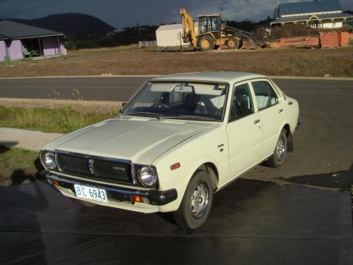

I have posted most of these pics before but Its been a long time since any work has gone on but finally some progress.
These first 3 pics are what the car looked like when I purchased it

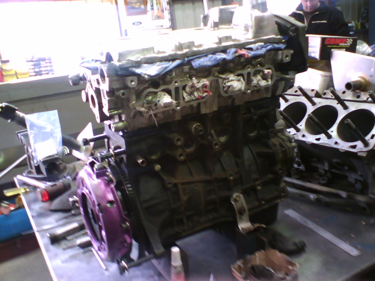

The engine sitting in the old girl. It was poor weather today in Tasmania so I could not get any good pics of the mounts but will post better pics soon. In the middle of the valve cover in the middle is a crank angle sensor the engineer knocked up for me. Don't worry it doesn't stay there. I'm going to be running S15 SR20DET coils. Should look sweet.

looking nice. What gen motor is that? what gearbox?
Gen 2
W55 supra 5 speed (would have loved a W58, would not like the price though)
2S bellhousing
2S slave cylinder
mitsubishi ???? clutch master cylinder
chrome molly flywheel and heavy duty organic clutch
standard starter motor
standard radiator but brand spanking new
500mm x 300mm x 76mm intercooler

Hey nice work, ive got a question. The flywheel is chrome molly but is it to suit the 3SGTE off the shelf or did you need to have it speacially made ? same with clutch.
Cheers matt.
Cheers matt.
Off the sheld from Australian Clutch (formely Adelaide Clutch). On the Gen 2 motor the stock standard flywheels is suitable. I opted for the chrome moly as it was lighter and looked better (not taht you see it). You do however with the chrome moly flywheel need to move your starter motor in about an inch as it has a slightly smaller O.D than standard flywheel. This was also a good thing as it gives more room for my turbo, turbo manifold and exhaust.
