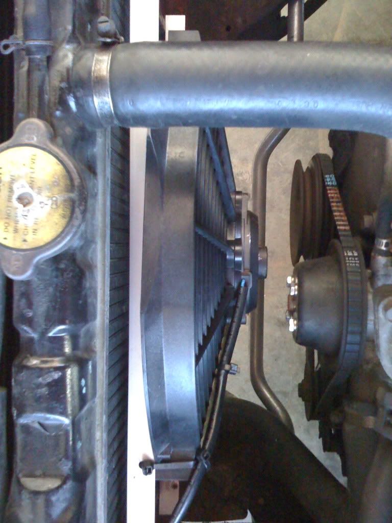

got the thermo fan in today makes a huge differnce power wise sounds sick to

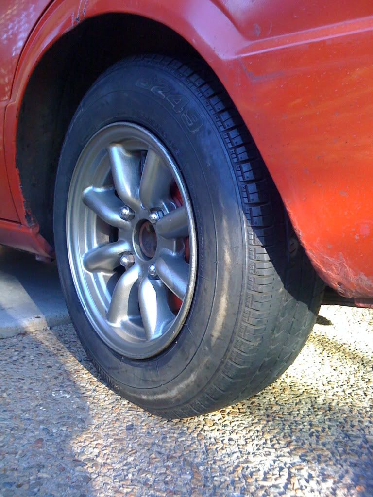

got the skidders on the back to see what they look like now i just gotta learn to slide the thing

fyi - that thermo is only going to be running at about 50% efficiency because of the way you've mounted it.
you need to have the shroud up against the rad core otherwise it'll just suck in air between the shroud and core.
yeh its only on there like that for now I'm getting a shroud made at the moment
