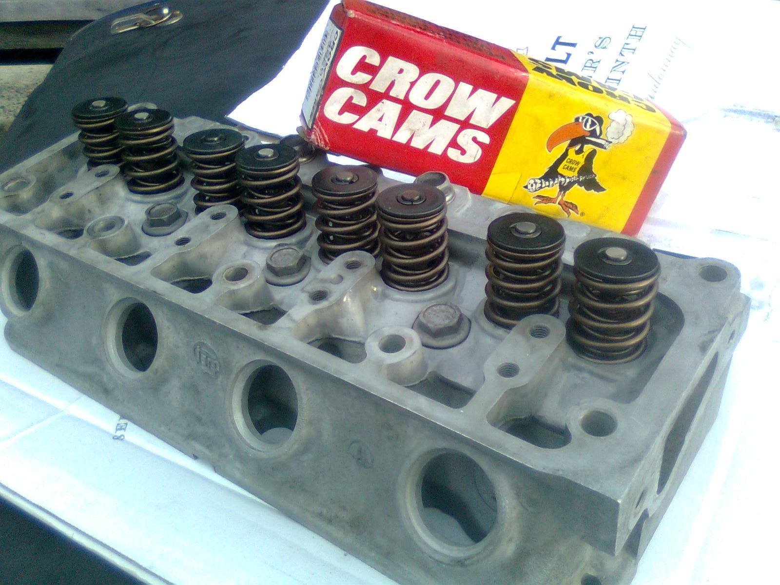

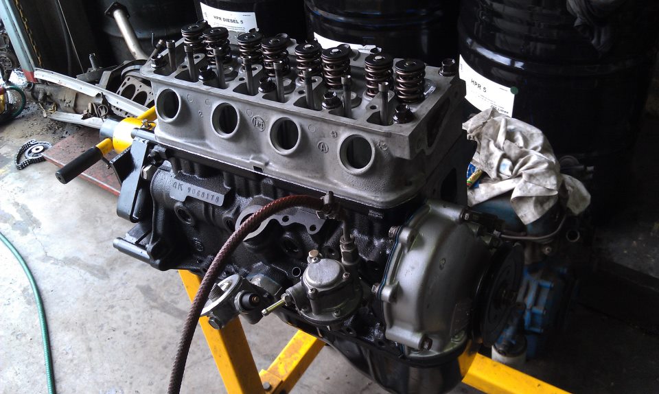

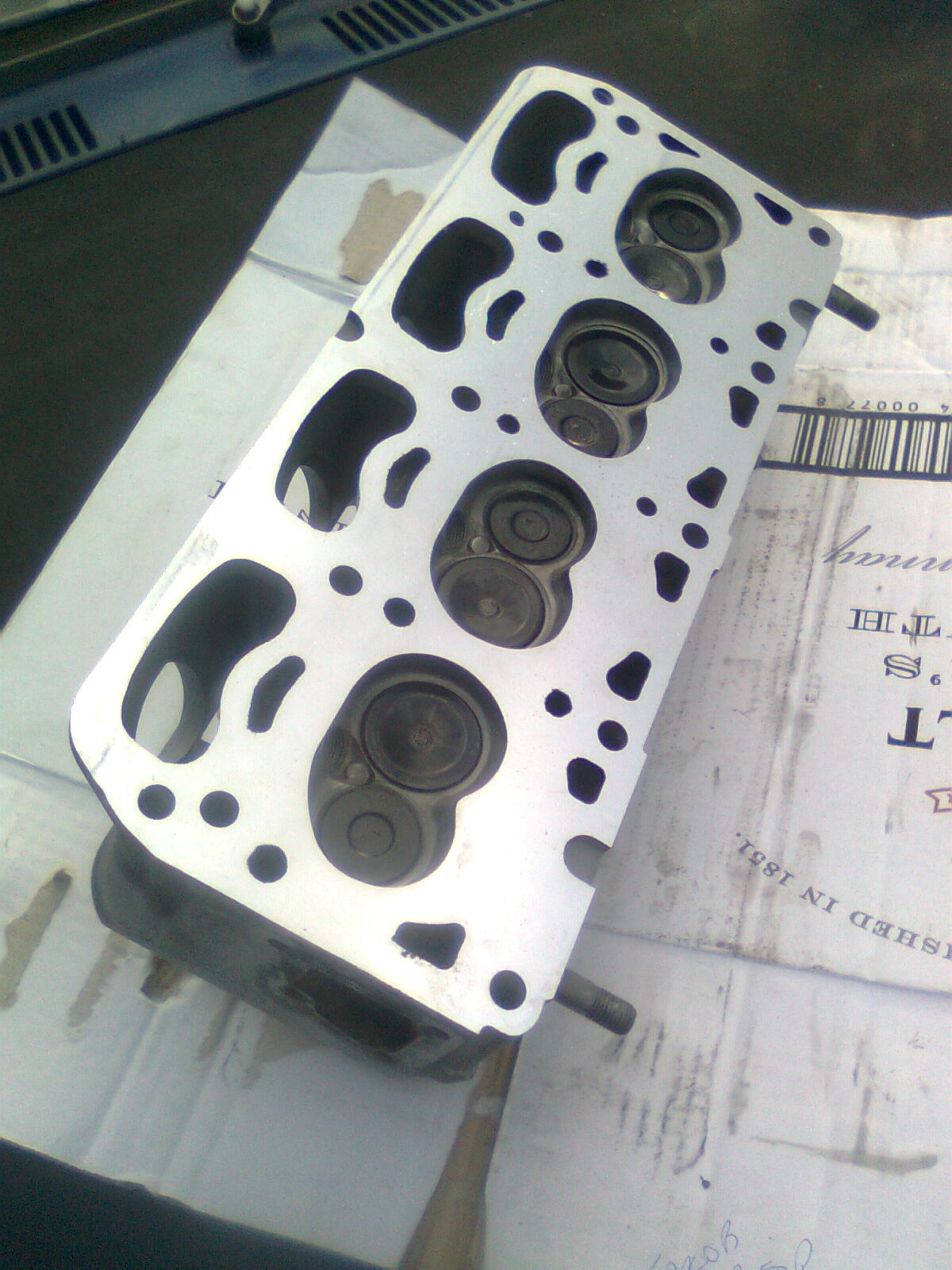

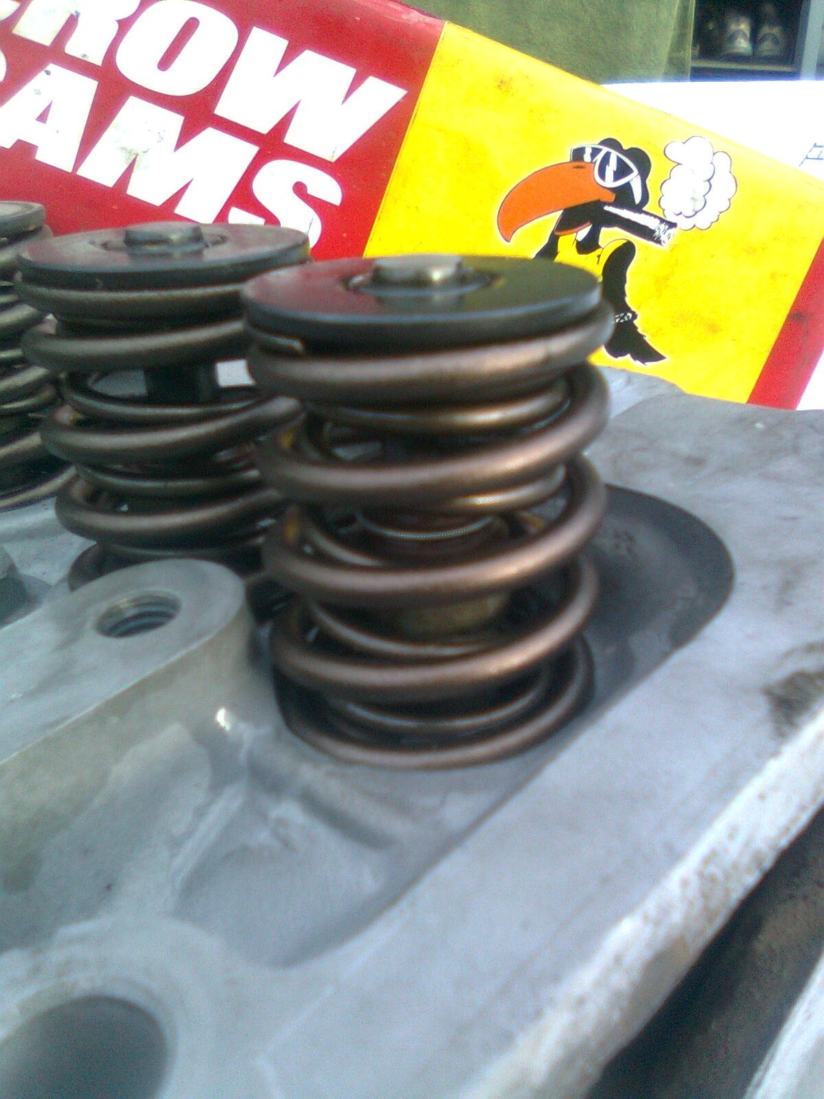

  10. Hi all got the head back from engineers and the 4220 dual valve springs fit perfect into the 4K head without needing any work. next step will be testing phase and finding out what rev's they enjoy
  11. Got some more go fast bits back today :dance: . Loving the look of the dual valve springs. Compression I will be running is 9.34 : 1 so not extreme but at least decent. Also fitted the rear sway bar today, definitely makes a big improvement. Challenge now is to have this engine all together in and running by friday hahaha. A few pics to demonstrate that Crow Cam 4220 dual valve springs fit snug in a 4K head.

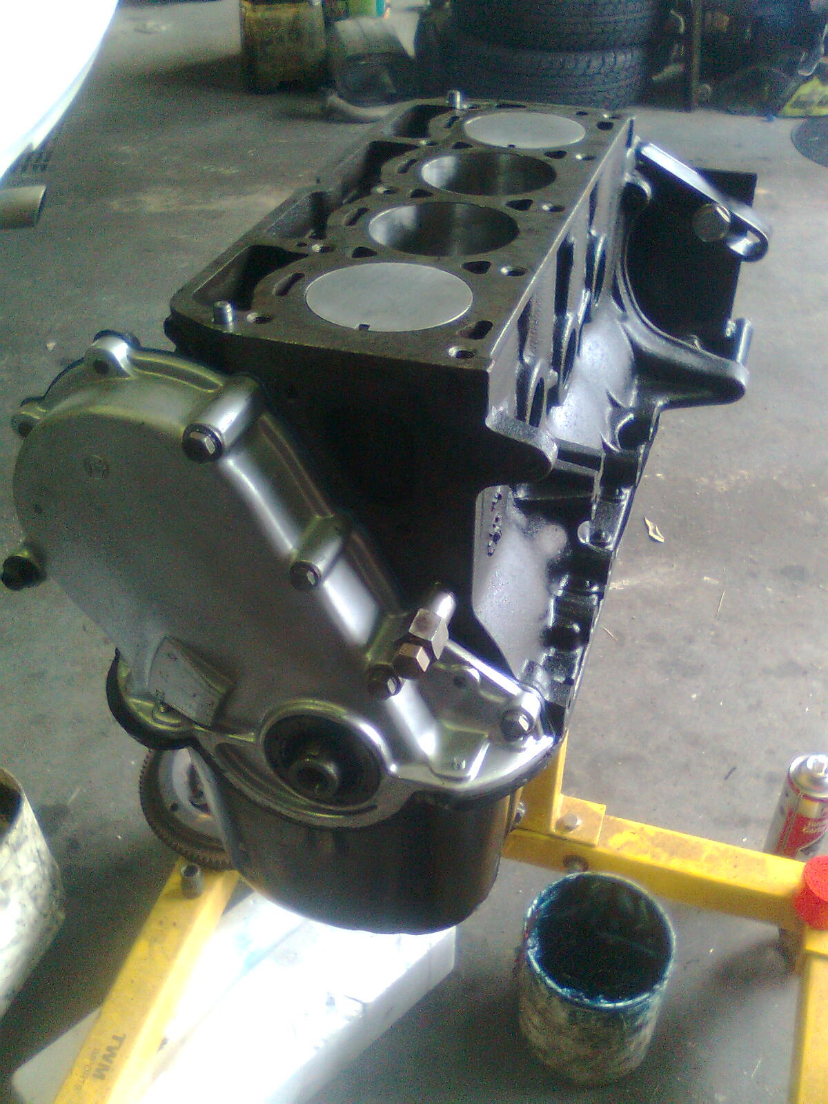

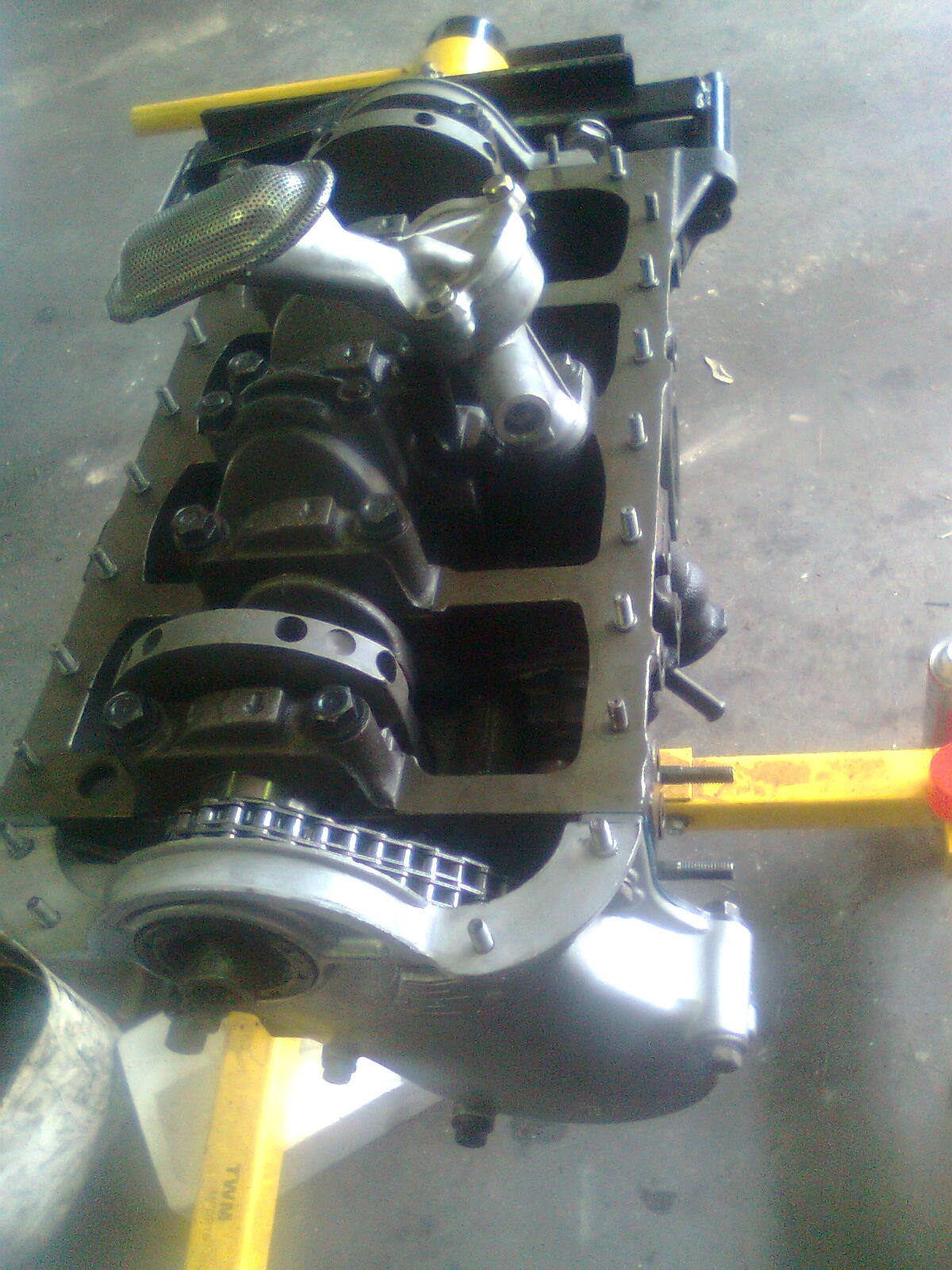

  12. Got some more work done today yay!!! managed to get the bottom end completely back together and all ready to roll. first time i had ever done this sort of engine work so was a bit slow haha. Just waiting on the head to get finished of by the engineers. Also heard back today that the dual valve springs from crow cams fitted no drama's and nothing needed to be changed to fit :) Here are some pics of the pretty new engine from today. The complete assembled bottom end

  14. Yeah i did some serious tread reading to find what should fit. Ended up getting dual valve springs from Crow Cams (part No. 4220) which for $120 seamed like a very affordable option. The head is currently of at the engineers getting a reco and having the springs fitted. Should be able to let everyone know if you need to replace anything at all to fit them in 4k heads (like retainers etc).
  15. Cheers mate this finalised my decision. I ordered a set of 4220's from crow cams today, so will report back when i get the motor together and going.
