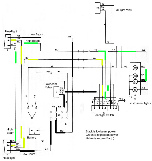

August 16, 200917 yr comment_366285 I've been wondering about the KE's lights, and whether or not they are at peak efficiency. I see the low beam goes through a relay but the high beam doesn't, so that would be a chance of improvement. The other query I have is- Why does the yellow "earth" line return to the switch?? Why isn't that line straight out to earth by the lights? Am I right in assuming the RedBlack is power to the lowbeam filament and RedGreen is power to the high beam? I fitted one 90/100watt halogen and the daughter said she couldn't really see the difference between the left and the rght... :P Thanks Team! Report
August 16, 200917 yr comment_366326 I've been wondering about the KE's lights, and whether or not they are at peak efficiency. I see the low beam goes through a relay but the high beam doesn't, so that would be a chance of improvement. The other query I have is- Why does the yellow "earth" line return to the switch?? Why isn't that line straight out to earth by the lights? Am I right in assuming the RedBlack is power to the lowbeam filament and RedGreen is power to the high beam? I fitted one 90/100watt halogen and the daughter said she couldn't really see the difference between the left and the rght... :P Thanks Team! In all the Toyotas I've looked at, they've had negative-switched headlights - ie there is power constantly supplied to the lights and you supply a ground to the one you want to turn on, which means that the earth has to pass through the switch. Edited August 16, 200917 yr by Hiro Protagonist Report
August 16, 200917 yr Author comment_366328 Ah- like a Datsun 1600! Thanks Hiro. I will chase it up slowly and probably swap it around with a relay fitted for highbeam as well. Your SU carbs are quietly sitting while I ponder which modern airfilter to use on an airbox, and whether or not to chase trumpets for them... Report

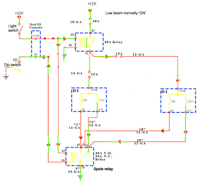

August 17, 200917 yr Author comment_366465 After a bit of hunting the web I've come up with this idea- A mod on a Landcruiser mod, it has a relay in front of the headlights for clean power and one afterwards that acts as the switch. The headlights come on Low as soon as you turn them on, so full power goes through the relays, bulbs and can earth right beside the lights. When you move the dip switch it activates the 5pole relay and switches from Low to High beam, also running full power from the alty/battery straight through the relays & bulbs to earth. This can be done by just putting spade terminals into the existing headlight bulb terminals, so the whole existing circuit stays in place and just carries the low current needed to switch the relays. Anyone done this?? Report

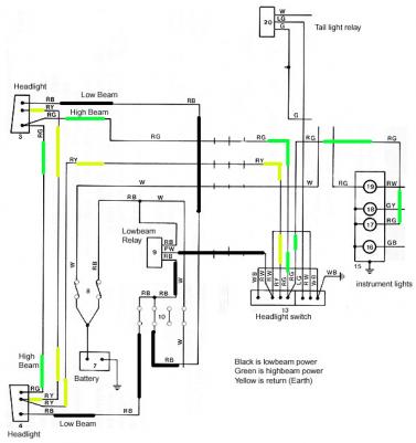

October 9, 200917 yr comment_380325 i can't open ur diagram so I'm not gonna bother, without ur diagram is way to hard to figure out ! Report
October 9, 200917 yr comment_380401 http://www.ke70.com/forum/index.php?showtopic=1856&hl= saves the brainwork. Report
October 9, 200917 yr comment_380506 yeah been there, still need to know where things plug into ! hense i need the diagram ! Report
October 9, 200916 yr Author comment_380565 Can you see any of the images, or is it just the diagram that doesn't come up?? I can email you the wiring diagram. I've found out how to make the high-beam light work on the new system, but haven't been able to find a 20ohm 25watt resistor yet. Once I do that I'll re-do the diagram and post it as a pdf or something. Report
October 10, 200916 yr comment_380665 i can see the image, but can't open it up, id love to do what you have got already, but can't pen the diagram. if you could email it too me that would be great, my email address is [email protected] Report
