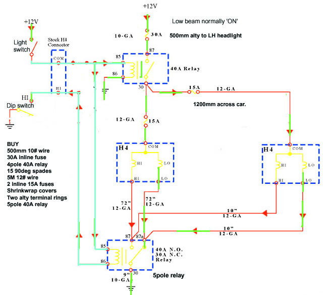

The KE has absolutely crap lights by the time they are 20 years old, so I decided to reverse the power flow and fit relays, just like I used to do on the Datsun 1600s. The results were better than I ever expected, showing that the column switch is definately a drag on the stock system.
I've put the 'how-to' up in the sub-club KE70.com here-
http://www.ke70.com/forum/index.php?showtopic=1856&hl=
Its under $50 to do and makes a great difference. Probably similar for all the earlier KE models too.

In the normal system, the electrical load of the headlights is earthed through the "dimmer switch" in the cabin, which controls if they are high beam or low beam.
Doing this, takes the electrical load away from the dimmer switch, so that the dimmer switch is just the low level trigger for the relays, and the relays carry the electrical load.

no no.... power is provided by one relay to the COMMON pin of the headlight. (Looking at the back of the headlight, it is the lefthand pin IIRC.
That power relay is turned on by you turning on your headlights.
Look at my thread linked above on toymods. I made a really simple diagram to follow.
You can just eliminate two of the headlights... cos obviously most KE70s only have 2 headlights (unless you have done the quadlight conversion).
I used this plan- Turning on the light switch powers both relays, and the top one (the 4pole) feeds power through the dip beams and down to earth through the 5pole relay.
Flicking the dipswitch changes to highbeam by switching at the 5pole relay.
