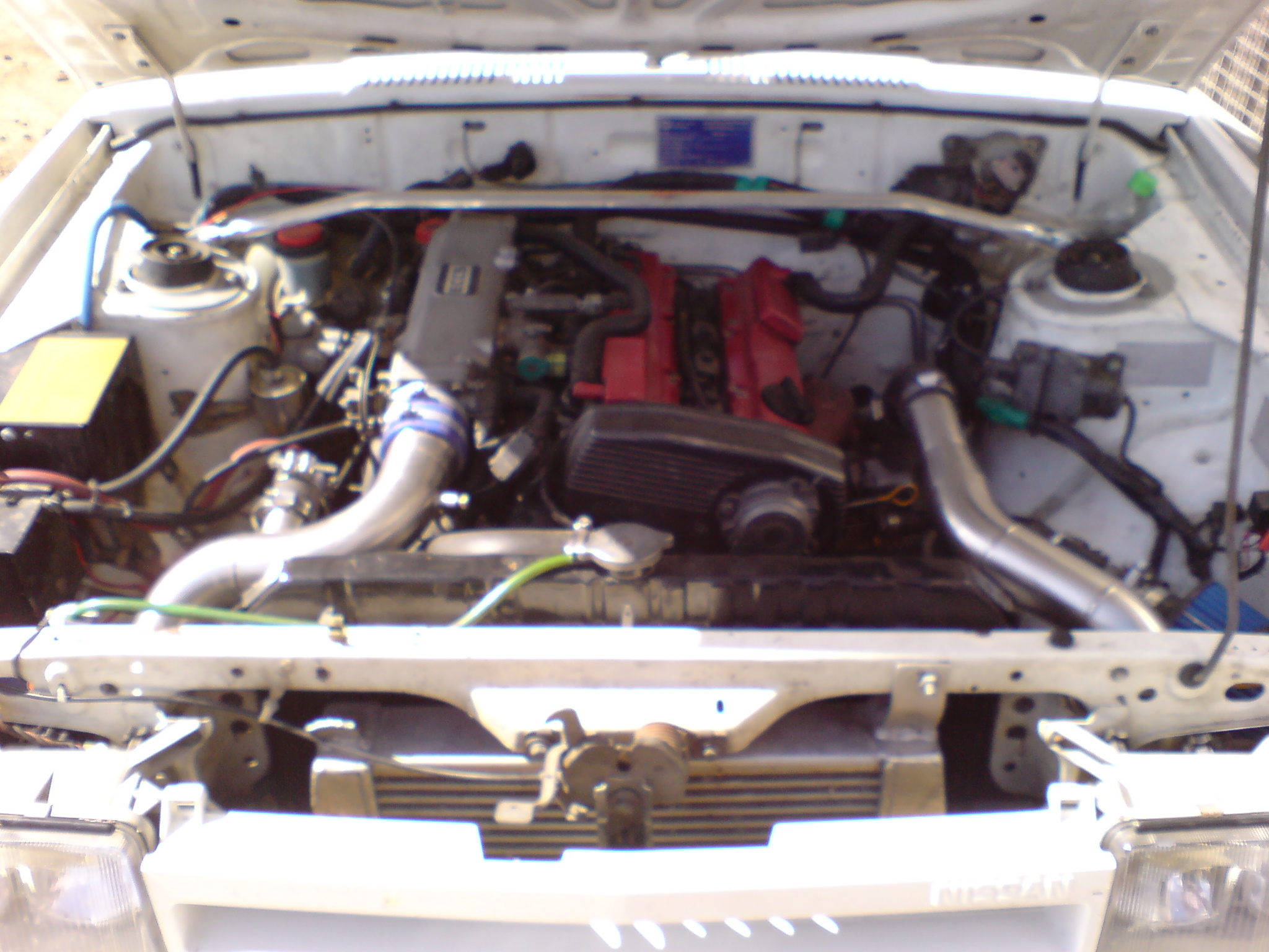

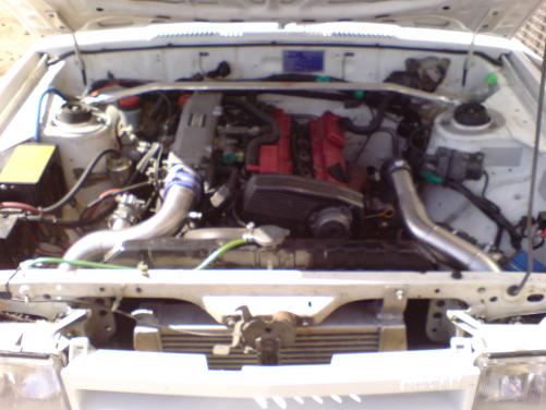

i got a 31 pintara with ca18det....and yes they do bolt up to the ca20 box with a s13 ca18det clutch
