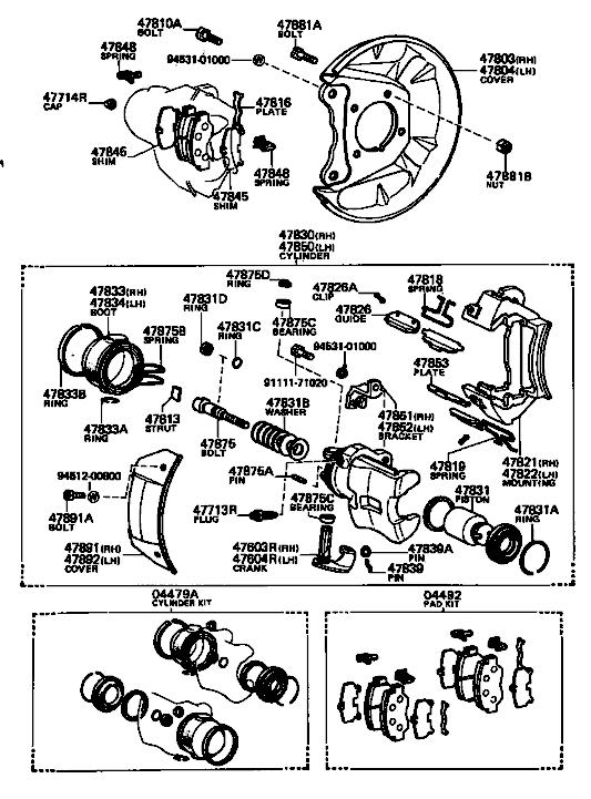

LittleRedSpirit Posted February 26, 2012 Author Report Posted February 26, 2012 Well Ive done the celica caliper mod. Its pretty good. The Brackets that bolt on the diff ae the same, except for the shielding, which needs to be cut away from the mount holes on the ae86 caliper to allow the celica units in. The calipers bolt on, but are a little flusher to the bracket than the ae86 items, so much so that if you use ae86 rotor, bracket and celica caliper, the fixed part of the celica caliper will just score the rotors. This means the celica rotor is 1-2 mm taller than the corolla one. Being that they use the same mounting bracket, and the same axle, then I can deduce that the caliper from the celica has less offset and its rotor has more to compensate. By comparison the ae86 parts have the reverse, a shorter rotor and a caliper with a shad more offset. I was simply able to use the celica caliper on the ae86 rotor and bracket by simply tin snipping away the extra shielding, and by slipping in one broad, flat high tensile washer in between the caliper and the bracket to shift it over that little bit. Its all bled, bedded, handbrake connected, with new Penrite sin high temp fluid, and of course, the new Braided lines from Goodridge. I also chucked on some 15x7.5 work fins cause they had good tyres on them, even though they reduce my track by 20-30mm overall. I ʞ©$ɟing pray these caliper give me years of trouble free use before they wear out. They do look to be easier to fix if the slides ʞ©$ɟ up than the ae86 units. There are parts you can just replace.
LittleRedSpirit Posted February 26, 2012 Author Report Posted February 26, 2012 This is the caliper, toyo diy has this as the te71 levin disc rear caliper.
