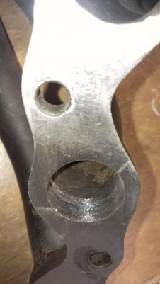

LittleRedSpirit Posted November 12, 2012 Author Report Posted November 12, 2012 (edited) Well now I understand why my exhaust sound was getting crappy over time. Anyhow, I have obviously now removed the damaged headers, and deemed them too ʞ©$ɟed to bother fixing. They have been tossed in favour of the spare 4-1 pipes from the ae86 engine package. Unfortunately they were for 16v. So I spent a bit of time cutting the ends off the flanges and fabbing up the modifications. Now they are all painted, and installed. But not before I ported the shit out of them for a smooth flow. I never did this to the original identical 4-1 header I had on my first 20v so I am excited to see what if any difference it makes. I ran the car momentarily with them on and the exhaust not connected. Has the typical biplane sound. So tomorrow I'm off to the exhaust shop for the small extension I need at 2pm and then we are back on the road. I wanted to remove the wideband but I better keep it for a while and see how much retuning is needed with the 4-1 pipes. Ill have to have another bung fitted to it. Edited November 12, 2012 by LittleRedSpirit

LittleRedSpirit Posted December 14, 2012 Author Report Posted December 14, 2012 So I was driving home from a mates place yesterday, and I start to hear the front wheel bearings over the sound of the radio. For some reason the front right side was stuffing up. Also the steering went really light around the middle. I jacked it up when I got home and sure enough the bearings on the side had about 3mm play. I removed the outer one to inspect it and found an extreme level of wear and a lack of grease. I put it back together enough to get me to service. The wilwoods stress these things really badly. Luckily, I bought a set of wheel bearings to put in ages ago, so I have them in a drawer at my workshop. Guess what I'm doing today. Haha.
