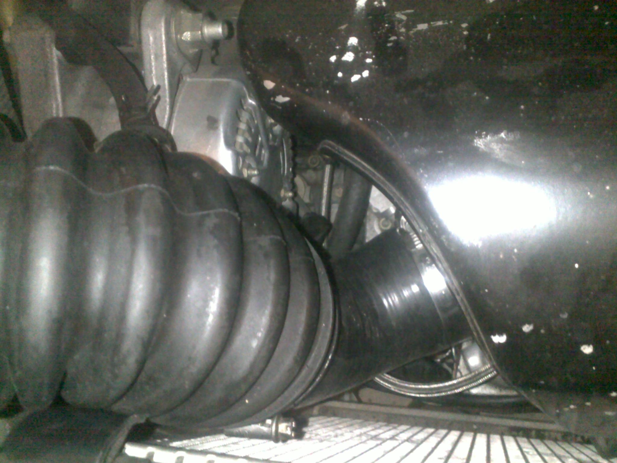

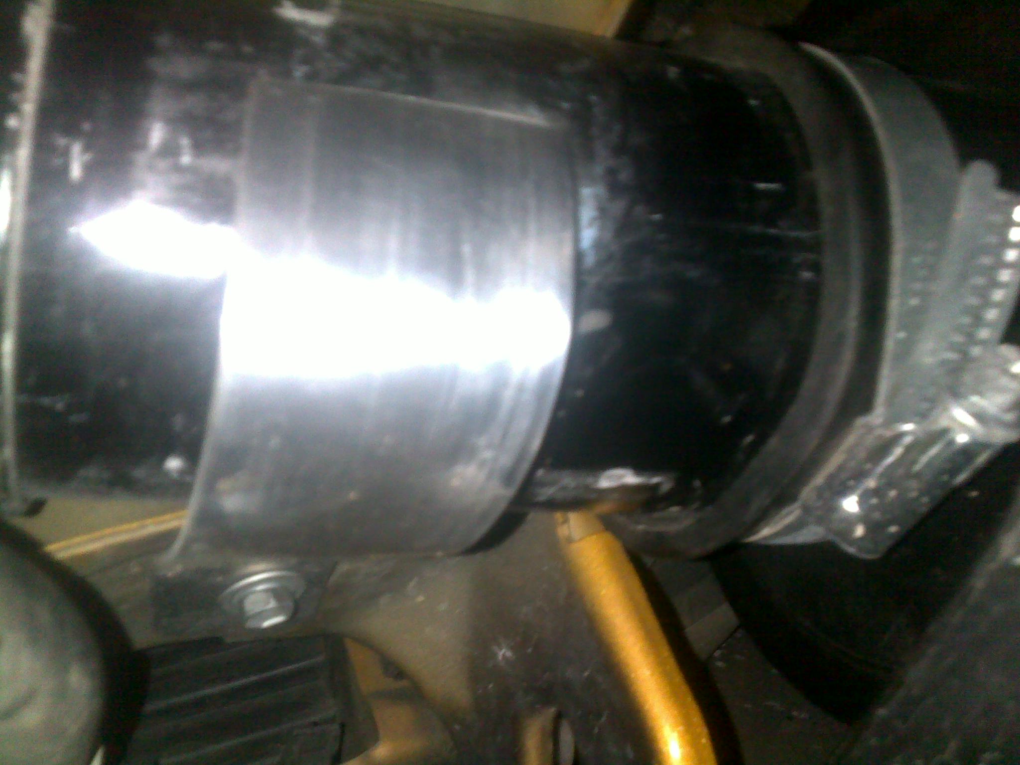

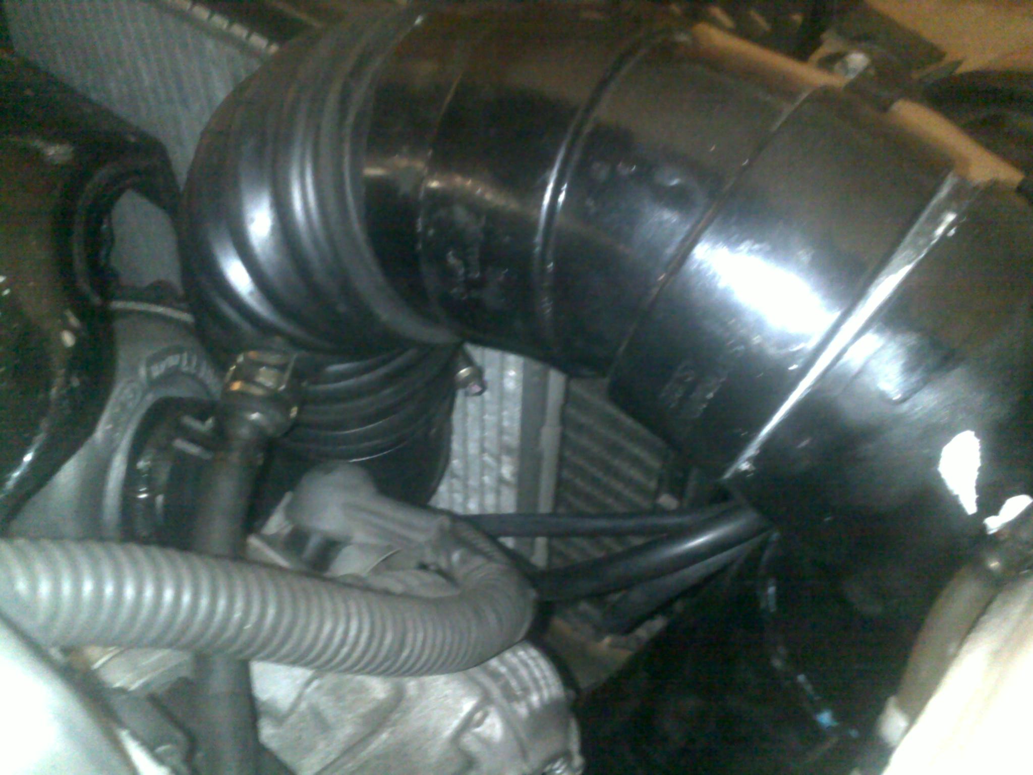

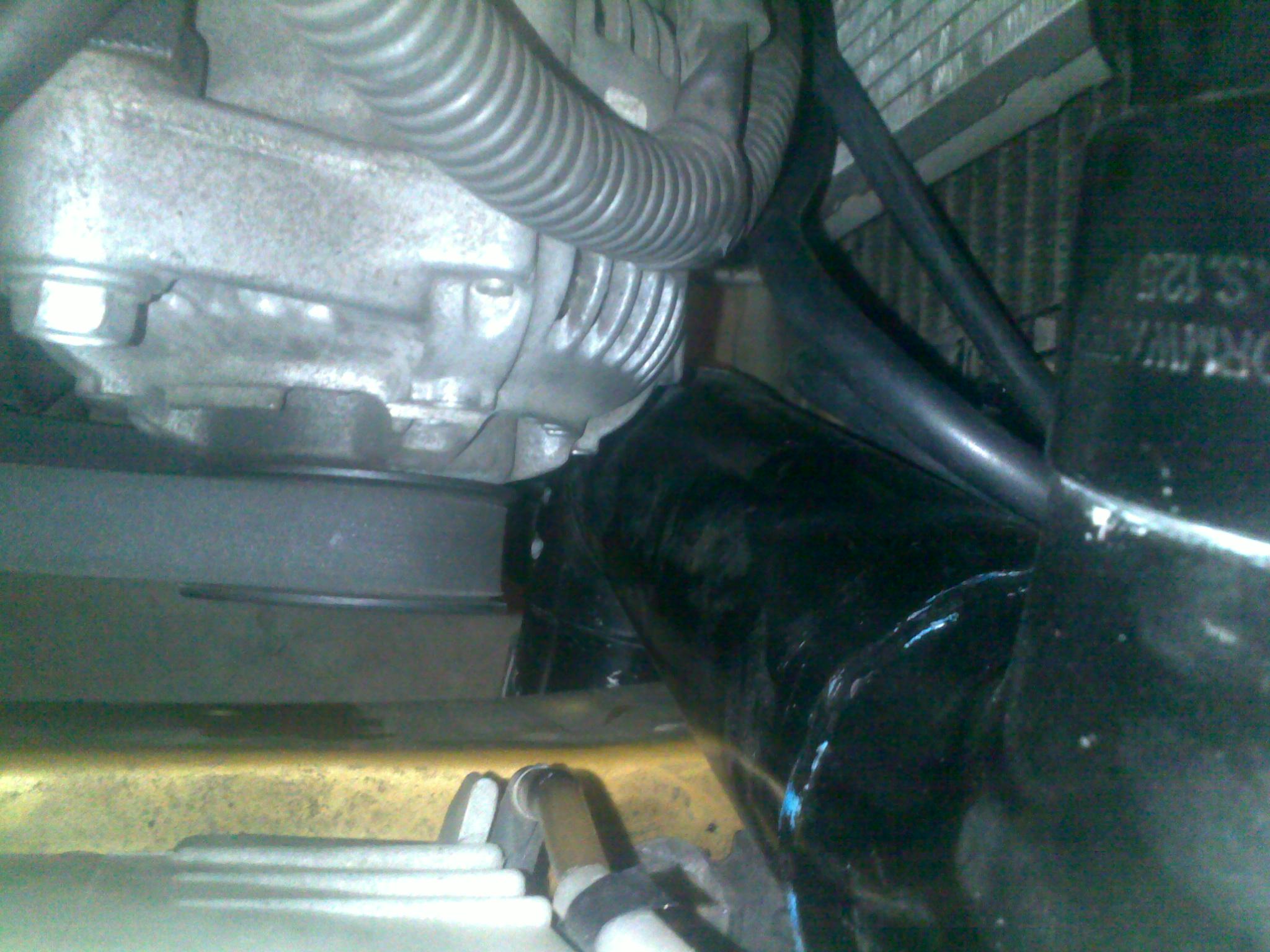

Now here are some pics of the CAI for you :)
