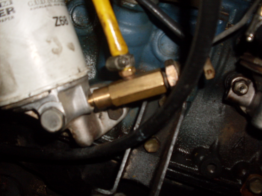

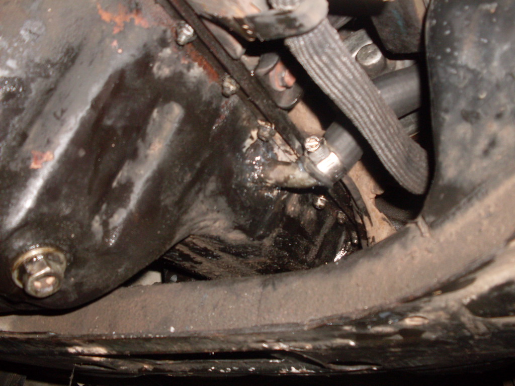

No need for a cooler. You'd loose your oil pressure if you did. T piece the feed from the oil pressure switch, return it through a fitting welded onto the sump.

Err...is that silicon hose?
It won't be for long along with the turbo and rest of engine.
Chin70 you have to use a solid line or steel reinforced (braided) line for the turbo feed as it has to withstand pressures in excess of 80 psi.
haaha yes it is it was just to get it runing
