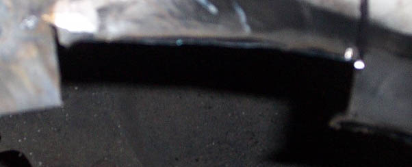

• Cut it out. Use a fine cut off wheel. For areas were the body will lose strength. Leave some in, and cut it out once you have welded another piece in. This will stop ‘soggy' and warped finishes.
You have to get it ALL
• Once you have got it all out, try to grind it to a flat line, this makes it easier when making your replacement panels.
Notice relatively straight line and lack of focusing skills

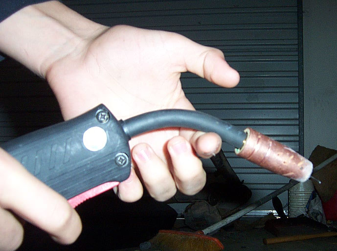

Any way, hold the torch (gun) with 2 hands. It gives you better control. With one hand on the grip and trigger, and the other on the ‘spout' like this.
Edited by Jason
The hand on the spout will guide the torch.

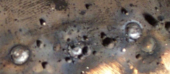

Try some spot welding. Hold the gun nozzle on the work piece and pull the trigger. Just make sure it doesn't melt through. Once it's cooled it should look like a piece of old gum on the street :D . So it _shouldn't_ look like a ball, but a puddle and should be about 5mm across.
Keep practicing this until your confident.
My lousy spot welds with way to much spatter. :)

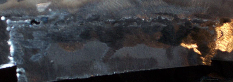

1. Get your replacement piece and your vice grips and attach it to your car so its firm. It only has to be flush were the first few spot welds are going, to keep it in place.
2. Once it's aligned, spot weld the replacement sheet on the body, moving the grips so it has full contact. Make sure you don't hold the weld for to long other wise you will get a hole.
3. Once it's attached with the spot welds, take off the vice grip. Now you can start welding the piece on properly. Make a nice flowing weld around the piece until it's firmly attached. To test it, wobble it, the rest of the body follow and the welds should not crack.
4 . Now grind it off
Now go repeat step 3 and 4. So you weld the panel up twice. This is to ensure you penetrated the panels and its not just surface weld.

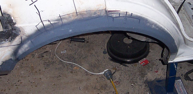

This is what mine looks like.
