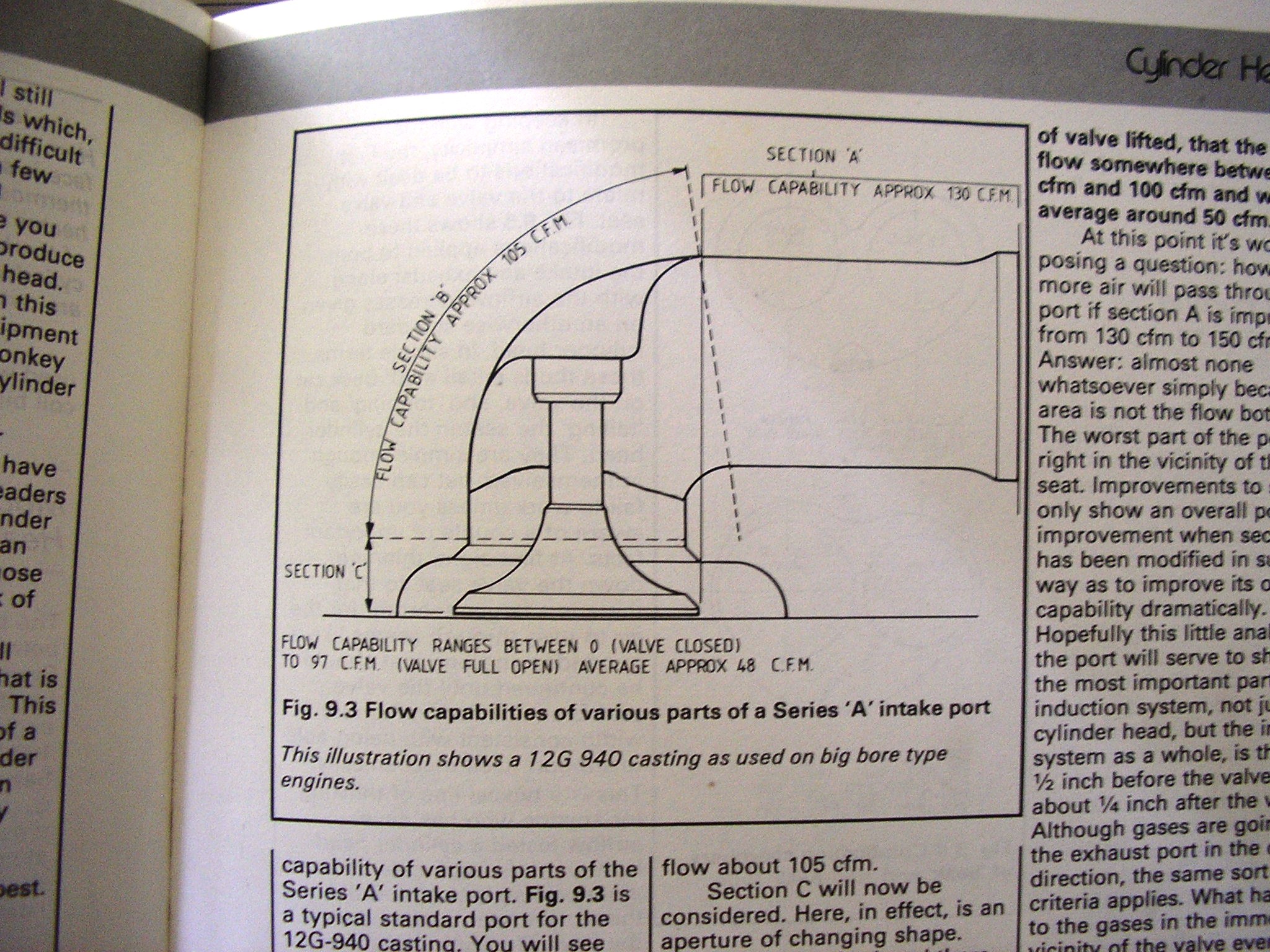

LOL. Bigport heads. In standard form the ports are already too big for the stock valve size.
Look at the following image and tell me how much advantage you would gain by hogging out the straight section of the port and not enlarging the valves or doing any bowl work.

Robert, you should ask... why did toyota start with bigport heads, then drop them and go to small port heads, still keeping the same valve size? Then, what did toyota do differently with the heads on the later dished piston motors, and why?
KE55PIG the point of that pic is that port size is only a very small part of the equation. The thing to note is that it is far more important to encourage the intake charge to change direction and flow past the valves with minimal restriction.
you do make a perfectly valid point and I agree totally that its all about smooth unrestricted gas flow. Might require some further thought then in terms of my inlet manifold and 3kb carburettors.
