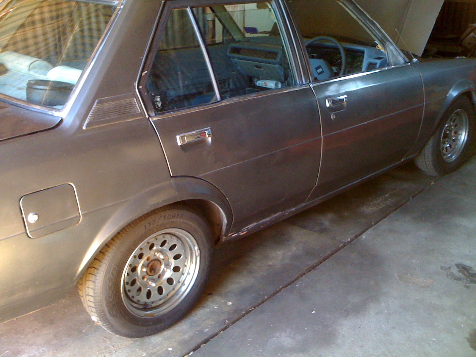

Any more pics/info on it? Registered?
it is registered..... as a stock rolla.....
basic rundown. its got an rb30e+t manual. high mount turbo. trans tunnel was hacked, custom gearshifter made up to bring it to near stock position, new trans tunnel riveted/welded in. r31 diff, custom adj panhard rod. thats what i got off the top of my head.
he towed a patrol with it, happily chugged up hills in third.
yea its registered, with r31 diff custom mounts/tailshaft, its n/a for a while until i can afford that. no more pics really

Any more info on the custom gearshifter to bring it back to stock position? How much further back does the shifter hole actually sit?

the shifter was approx 200mm too far back.
