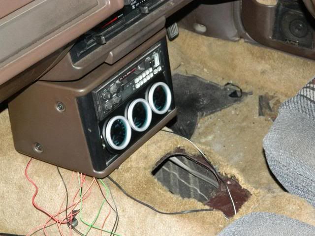

Not much action lately but managed to get a few things sorted, Decided where I wanted all my gauges and mounted ready for when i start wiring up the car.

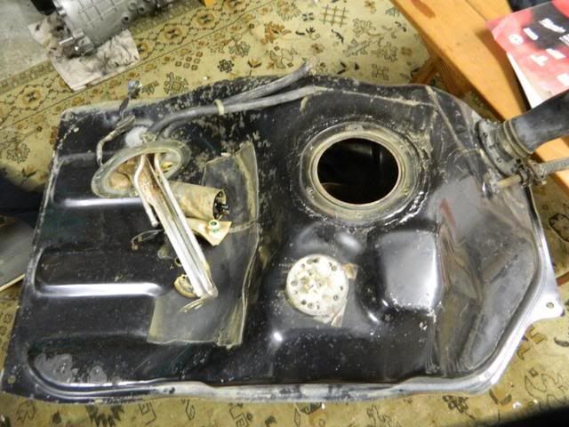

Sorted out the fuel tank for efi. I scavenged a skyline tank with pickup, cut a hole and got it all soldered in the position need. Also modded fuel sender because it hit the new bowl in the bottom. Just gotta sort out a new pump then bend up some fuel line

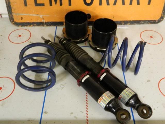

Also scored some BC Shocks, TRD Springs and some BC Perches to sort out the rear end.

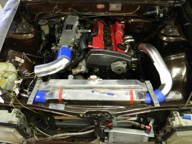

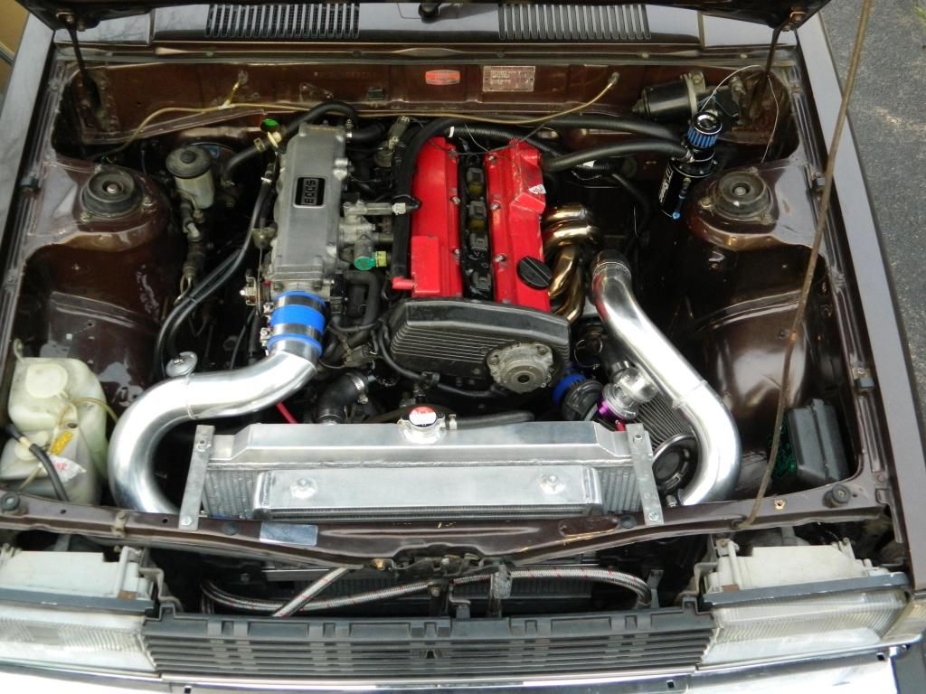

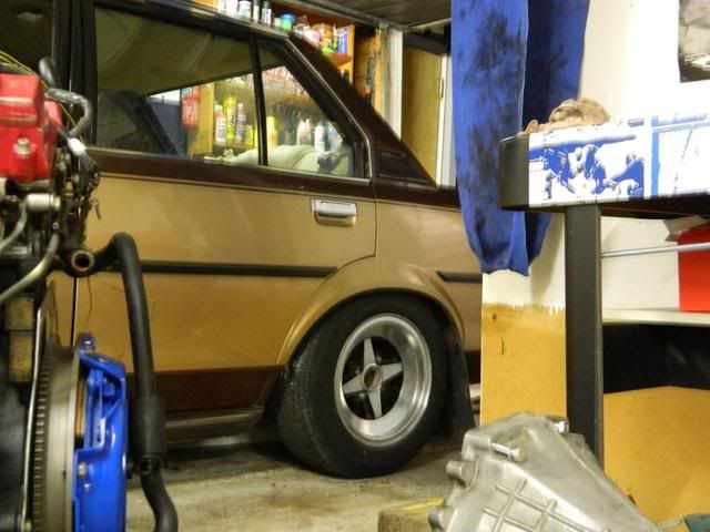

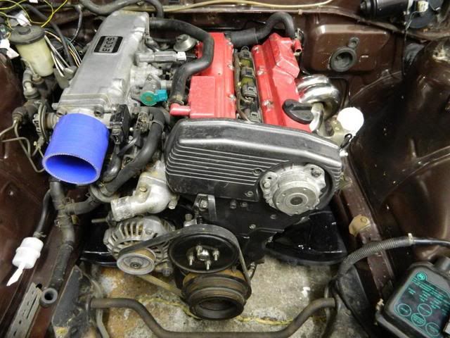

So the engines in and I'm one step closer to getting this thing on the road without a tow rope or trailer, stoaked
Started mounting up intercooler, rad+ electric fan and oil cooler.
Gotta modify, cut and weld up a few things but should hopefully all come together
hmmmmmmm that 3 round gauges gives a " SPORTY" look........... :thumbsup:

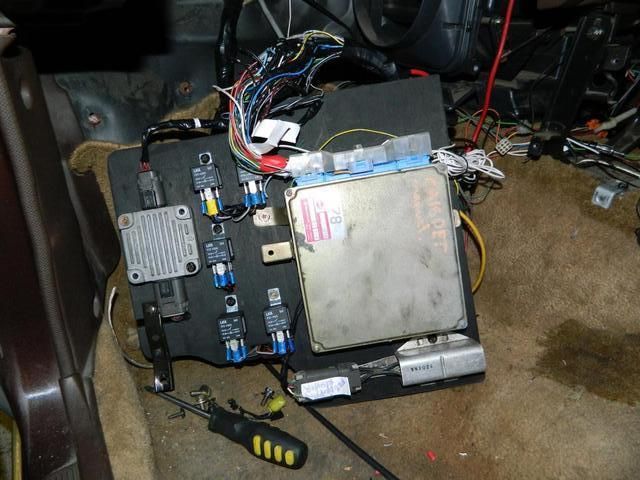

Spent hours reasearching wiring info and shit and wired up everything. Tucked it away.
Made sure everything was checked of the list. Filled with fluids.

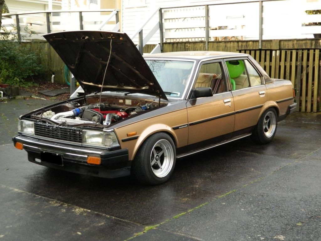

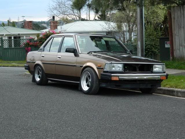

And in the end after some head scraching and calls to the champ Brendon, got to drive up the driveway. So stoaked,
Just need exhaust finished and cert man here we come.
